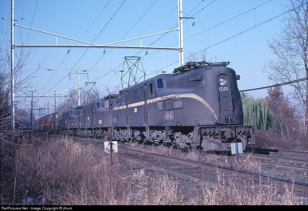

Speaking of invisible, anyone have good suggestions for weathering Brunswick Green? the 4840 took on a grayish look, and i'm not sure how to repeat that.
How would you guys weather this?
[Image: 5743.1072284660.jpg]

To get that look You may try thin washes of grimy black applied with an air brush.     This set of train masters was weathered that way. Although not quite as severe as your "G" and in Steam power black not Brunswick green, That technique will give you a similar "gray haze" result with a few more coats of grimy black.
Cheers
Or try a coat of Dullcote or other appropriate matte finish, followed by very light dustings of grimy gray chalk. Just mask over any parts to remain shiny...if any, as may be the case with those grimy engines in your photo! The initial dullcote provides an even 'toothy' surface for the chalk to grab and subsequent coats will seal and adhere well. Just let the dullcote dry fully between chalk applications in order to see if the color is really what you want.
Galen
