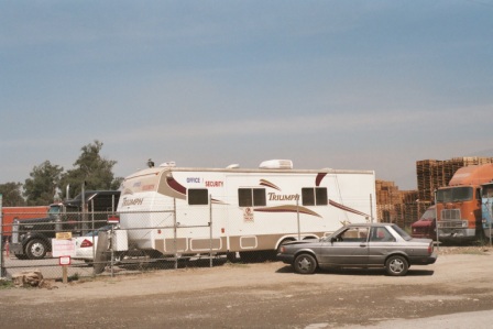

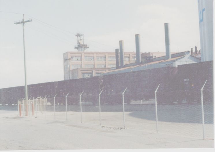

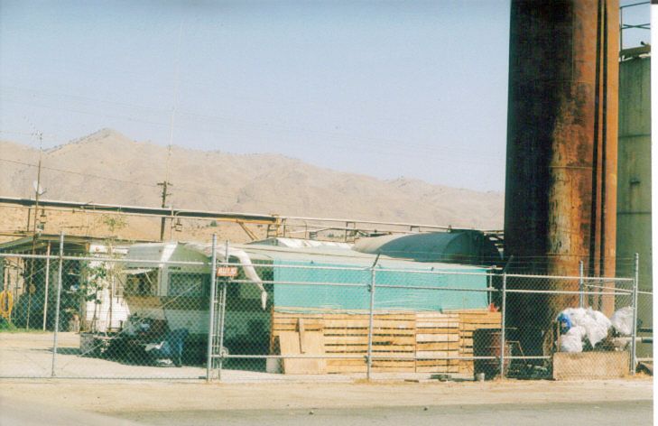

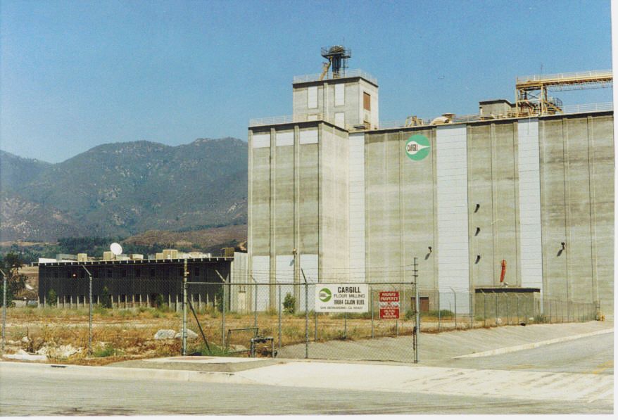

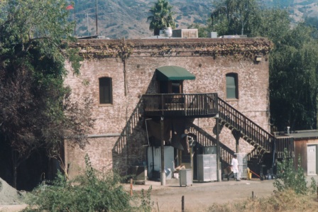

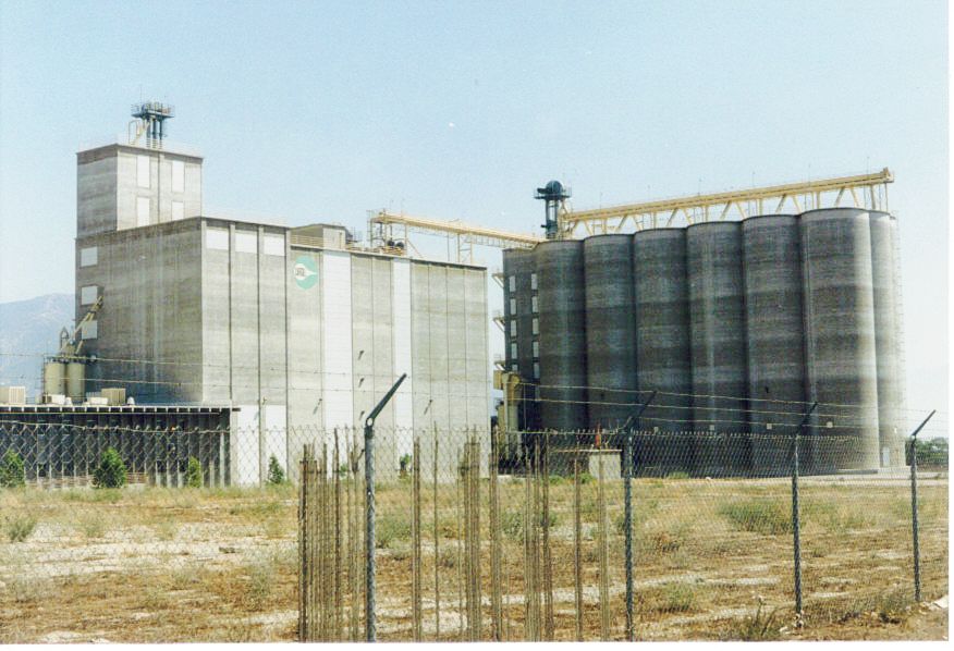

There are always exceptions, but fences are generally built and maintained by property owners. Here are some fence-area and backyard-area photos from industries.
There are several things that I think are interesting here. One is that the open areas are mostly just plain dirt, sometimes with sagebrush or grass tufts. Another is that old pallets are a very common item in backyard areas. A third is that old house trailers and motor homes are also pretty common, as offices, security offices, or even living quarters for the security guard. And don't forget the cars for the workers.

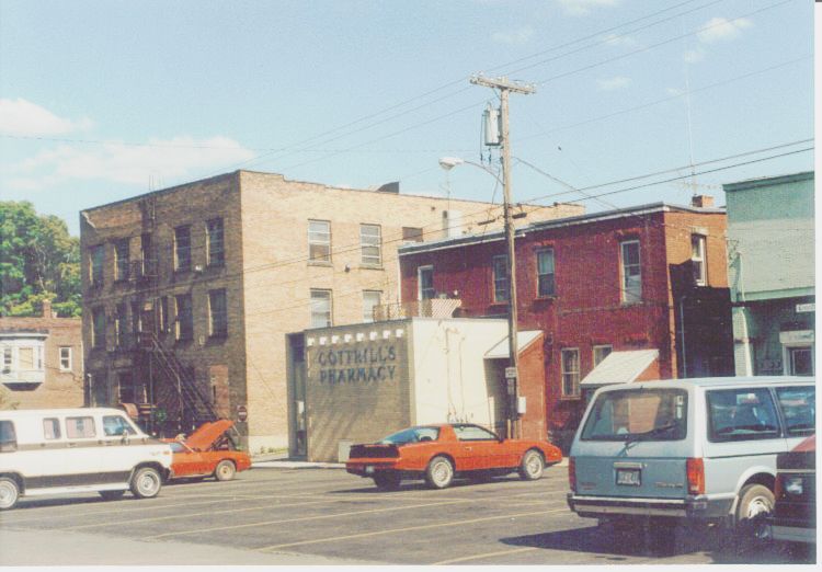

In all the areas I'm familiar with, there'd be no fencing because the alley behind the shops is where employees park, trash is disposed of, deliveries are made, etc. Sometimes even entrances to businesses. Bars and eateries do this often.

Oh, wait, I see what you're getting at, now that I look at the store backs you have set up there. In part, I was assuming you were continuing with a theme of sun-belt industrial areas, which is what the photos I posted above would cover. The most recent post is referring to Virginia, which is a different matter. Small downtown brick storefronts like Rix, DPM, etc, are in fact different.     Note, though, that this is upstate New York, not California or Texas. Here's something similar from Northern California:

I would say that the areas behind stores, especially where you have these modeled, are going to be alleyways, which are usually asphalt paved. There will be dumpers and collections of crates and possibly other junk, also pallets, but random. You correctly have utility transformers -- you can do with several more utility poles here. From 1960-80, the storefronts with apartments above will have TV antennas (but not anymore, since now there's cable).

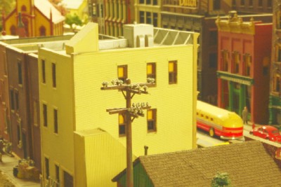

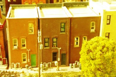

Here are two shots of DPM building sides and rear on my layout:
