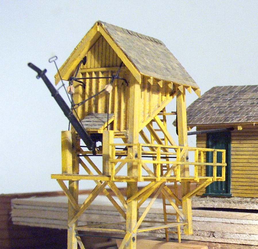

If it will help, here's a close up of the upper part of the tower. The shingles are hand cut individual pieces of 20 pound bond paper, streaked, cut in strips across the streaks, and then cut into random width shingles.

Nice modeling, as usual, sumpter!
Hey Tetters - how goes the progress?
Galen
#21
Looking Good Tetters. Cheers
