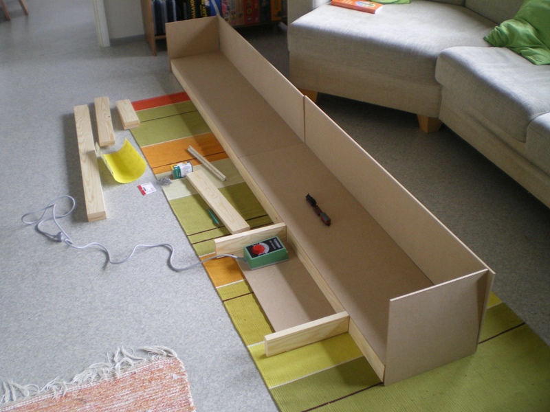

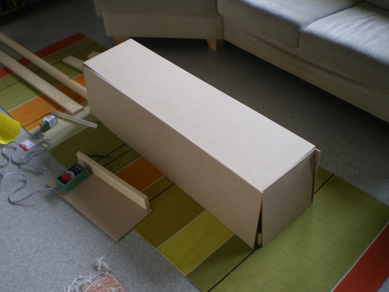

Got the materials for the benchwork, only needs to be assembled, next week, probably. Starring on the layout are a Fleischmann BR91 with a flatcar and a caboose.
Demonstrating the portability of the layout - the whole layout can be stored away in just 4x1x1 feet. The shelf/control panel is also going to be theoretically detachable (reconnecting the wiring might make it tricky)

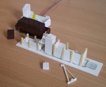

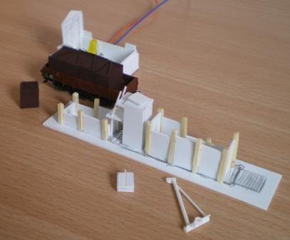

The trains run on coal, so we need a coaling station (which from an operating point of view could accept loads of coal coming from off the layout) Flatcar with some scratch-built crates for an idea of scale.

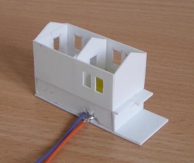

The maintenance yard might need a small building for whatever they need a small trackside building for. (a little led is inside)

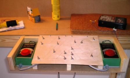

Here probably the last pictures from the planning stage:
The control panel has been finished and it works pretty much as it should. The layout consists of 7 blocks which can be controlled by the two transformer/controllers (double blue line) and 8 (correction: 9, switch has been added to control panel) sections where power can be turned off (single blue line). According to testing it in xtrkcad there is plenty of room for 3 to 4 locomotives running about.
