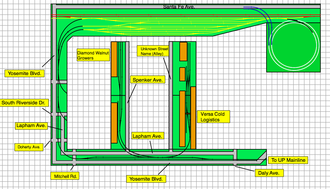

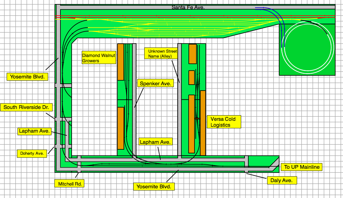

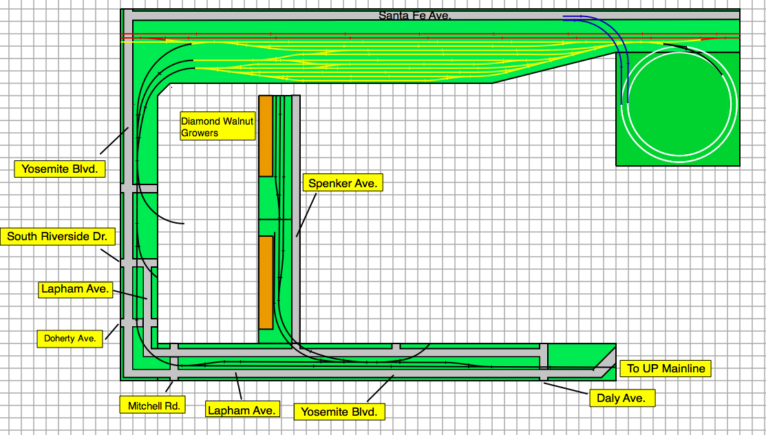

Here is an update on the plan. I finally got a chance to work on some revisions this evening lol

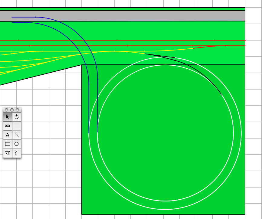

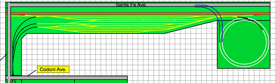

These 2 pics show the helix and the yard. The Black tracks on the right side of the plan are the tracks that are on the upper level with the yard. The white tracks are the helix traveling down to the lower level. 28" radius on the outside track and 25" radius on the inside track. The Blue tracks are the tracks that come off the helix at the bottom at the lower level. Ill have to do another plan to continue the blue tracks on the lower level. Yellow Tracks are the BNSF/M&ET Interchange Yard, and the Red Tracks are the BNSF Mainline.
The upper level with the yard is now part of a layout section, and no modules will be part of this yard. Now i realize that there is virtually no room coming off the BNSF mainline tracks on either side of the plan, but this is of no concern to me. Basically the BNSF mainline will just be for show, and simulate the real mainline running by the yard. And remember, all track spacing is 2" track centers, and on the helix, there is roughly 3" between tracks. All switches are #8's or #9's and minimum radius in the yard is 22"
Ive also lessened the length of the plan from 40' long to 25' long. This means now i will need a room thats 25' long to house this layout, thats alot better then 40' although 25' is still very long. Im not sure i could shorten the plan any further though.... lol
Thats it for now, more revising's to come soon Thumbsup

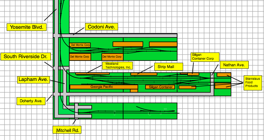

Did some more work on the plan this evening. I shrunk the plan quite a bit with this latest re-vision as well. Now the plan will only occupy a room that is 25'x15', which is more realistic then a 40x30' room LOL.
Now to explain this attachment....
Basically im going to limit the number of modules on this layout, and try and keep them to a minimum. The pic below only contains 5 modules, the rest is layout. The layout will basically be a large U-shape around the room, with modules coming out in different areas. When building the layout, ill make it so that each island can be hooked up and switched.... So all the islands will not be connected and hooked up at the same time. For example, the Codoni Ave. island modules would be set up, while Doherty Ave Island modules would be in storage and not set up at the same time as the Condoni Modules.
We'll start at the top left of the pic. This is where the 3 tracks come out of the left end of the Interchange Yard. These tracks merge into one track, and parallel Yosemite Blvd. When the tracks come to Codoni Ave. a spur comes off and goes to the right, where the first 2 modules will be located, Codoni Ave. A total of 3 modules (each 6' long, ONLY 2 SHOWN SO FAR). Below Codoni Ave, South Riverside Dr. and then Lapham Ave. parallels Yosemite Blvd while the tracks run down the center of both roads. Just below South Riverside Dr. another island of modules. These are the Doherty Ave. Modules. Just below this, the lower left corner of the layout, Yosemite Blvd and Lapham Ave take a right turn (in the real thing they keep going down straight and do not turn....) and then cross Mitchel Road. Tracks still say in the middle of both Yosemite Blvd and Lapham Ave. A little down the line, a spur comes off. This is currently where im at with the plan right now.
Im not sure how to explain where the layout stops and where island modules start better then i did above, but basically modules will be able to be hooked up to certain spots for switching, when im done switch them, they will be taken down and the next island of modules would be hooked up. It will make alot more sense i think once everything is in place....
Josh Mader
Maders Trains

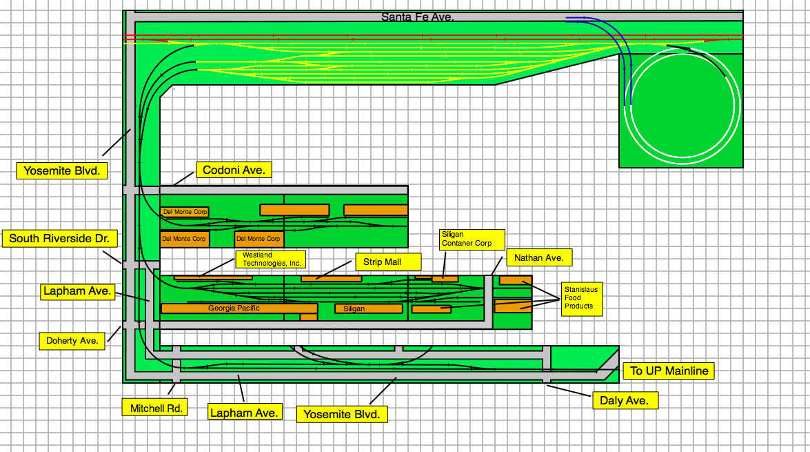

Okay this should make a little more sense as of what im trying to do with this plan.
Here are 2 more pics, this time showing 2 other islands of modules. Again there are 4 Total islands of modules. 1 Island of modules would be set up at a time, switched, then put away and a new island would be brought out.... Here are Islands 3 and 4. These would be tall enough that you could duck under them to get to get to all sides of them.... As you can see, Islands 1 and 2 have been removed from the plan (see my last post) and Islands 3 and 4 have been put in place. Ill post another couple shots showing the different set-ups i could do by adding the islands to the layout.

Josh, I think that if you build it, you will find that it is just too much trouble to set up and take down modules. You will probably just put up favorites and leave the rest in storage. When our modular club sets up a show, it takes 10-20 people 2 hours or more to set it up, trouble shoot, level the layout, and get everything running. Ho is very unforgiving of any irregularities in track work including dips, bumps, jogs, or any misalignment. You would be a lot better off to reduce what you model by modeling only a small part of the line instead of trying to cover the entire railroad.
As an example, I want to model the Los Angeles Junction Rwy on a 7 foot by 9 foot L shaped layout. I am not going to try to model the entire railroad. Even though it only occupies a space of 10 miles by 10 miles or so, it would be too much to try to include it all. I'm going to model the "C" yard and the Great Western Malting Company on the 7 foot leg, and District Ave in Vernon on the 9 foot leg. I will probably free lance something in the corner, perhaps pick an industry I like from Commerce or Vernon and move it into the corner.
If you made your layout to consist of the Codoni Ave district on one leg with the Doherty Ave district on the other leg and the back side just connecting the two or containing another switching district, forming a "U" shaped layout that would fit your 25' x 15' room easily and allow the layout to remain ready to operate whenever the mood strikes you, you would enjoy it a lot more. Frankly my least favorite part of the hobby is setting up and tearing down a layout.

Okay here are a couple pics showing the different arrangements i could do with the island modules when setting them up and switching them.

And the last one:

Josh - a suggestion - can you make "generic" Island modules that can be attached at various points around the layout. perhaps by adding a small, bolt on, "joining piece" at one or the other end? Building signs held on with magnets or velcro, so that they can be swapped when the island is moved to represent another part of town. Working on the basis that tin-shed wharehouses look much the same, it should be possible (perhaps with a couple of matching buiolding baseplates), to change out a couple of similar shaped(but differently coloured) warehouse/factories from one island into another neighbourhood, giving a completely different look and feel ( one might be cement block, another ali-clad, another brick etc. It would reduce the number of modules needed to be built and stored, and if the module is also reversible, give you different switching problems. Imagine for example that the Spenker Ave island in the last pic, had its top board rotated and then the island added to another part of the layout, perhaps part of the Codoni section. Just an idea!
#30
Russ Bellinis Wrote:Josh, I think that if you build it, you will find that it is just too much trouble to set up and take down modules. You will probably just put up favorites and leave the rest in storage. When our modular club sets up a show, it takes 10-20 people 2 hours or more to set it up, trouble shoot, level the layout, and get everything running. Ho is very unforgiving of any irregularities in track work including dips, bumps, jogs, or any misalignment. You would be a lot better off to reduce what you model by modeling only a small part of the line instead of trying to cover the entire railroad.
Very true. I read your reply after i had posted my last pic in this thread, this was before i started working on the bottom level. I completely agree with you, and thats why i chose to do no more modules, and keep them down to the 9 modules i had already drew plans for which would all be located on the top level divided up in 4 separate islands. I think 9 modules would be a manageable amount for just myself setting them up 2 or 3 at a time where they would be locked into on the layout? I understand there would be alot of work involved in setting up and troubleshooting, but i think if i only built 9 of the modules, that this would be okay and i could live with it lol
Russ Bellinis Wrote:If you made your layout to consist of the Codoni Ave district on one leg with the Doherty Ave district on the other leg and the back side just connecting the two or containing another switching district, forming a "U" shaped layout that would fit your 25' x 15' room easily and allow the layout to remain ready to operate whenever the mood strikes you, you would enjoy it a lot more. Frankly my least favorite part of the hobby is setting up and tearing down a layout.
Ive already compressed all my favorite sections LOL I would model the entire Shortline, but that would just take up so much space i would need a warehouse LOL. Plus i didnt even model the UP/M%ET Interchange Yard.... Which i really wanted to but had to force myself not to lol. Ill post the bottom level and the details below
