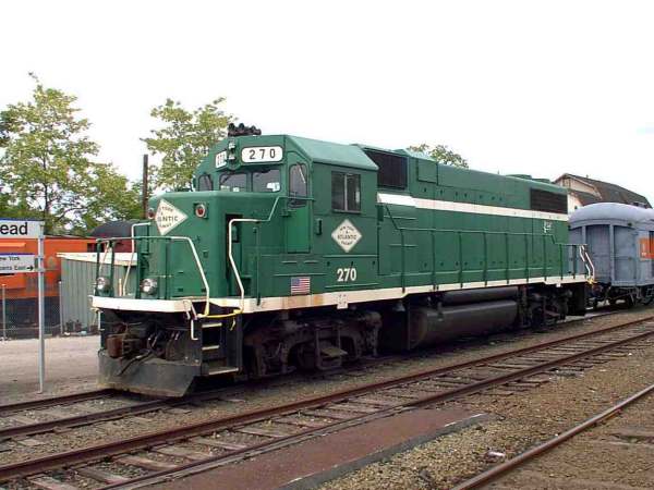

I found two pictures of #270, the first in the original NY&A paint scheme:

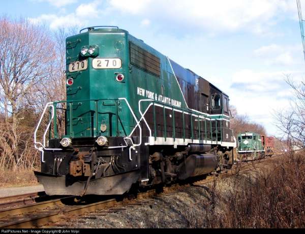

and this appears to be a newer paint scheme:

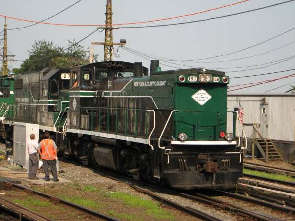

I also have one of MP15AC #159. This also appears to be in a newer paint scheme, and there's a GP38 #27X ( looks like 270 I don't have the tools, or skill to use them, but, with enlargement,and some "adjustments" it looks like 270 in the newer scheme ) behind it:

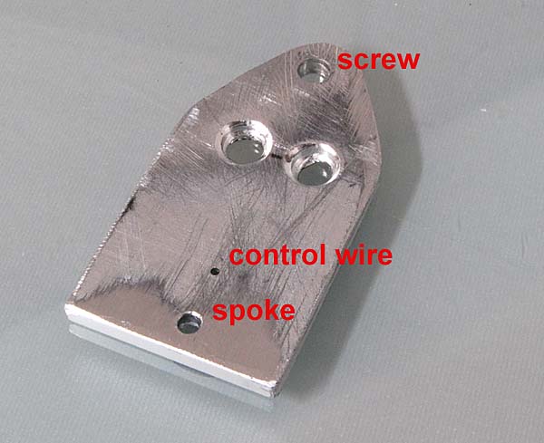

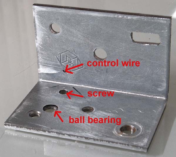

I started by drilling holes for the conrol wire, the ball bearing and the screw that holds the lever.
[Image: tc6.jpg]
Next I cut the lever from the aluminum profile and drilled holes for the screw, the control wire and the spoke (control rod).
[Image: tc7.jpg]

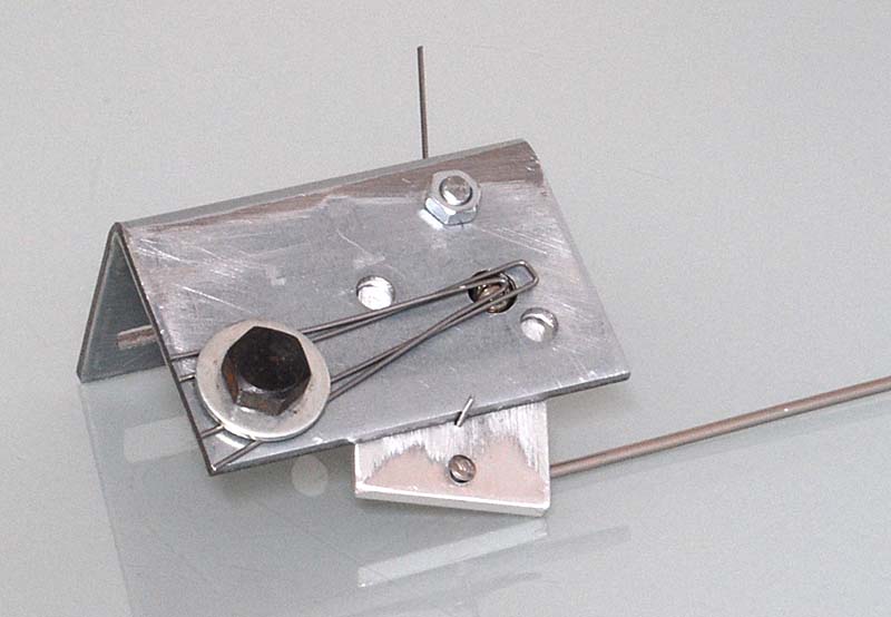

To determine the positions of the two holes that are needed for the ball to pop in and lock the lever, I screwed the lever to the bracket, added the control wire and fixed the assembly to my layout. Then I sticked the control wire into the hole in the throwbar of my turnout. I moved the lever to both sides until the points were firmly pressed against the stock rails. I marked these positions on the backside of the lever through the hole for the ball.
After drilling the holes into the lever for the ball to pop in (these holes are only about .040" smaller than the ball itself), I screwed the lever to the bracket again, tightening the screw so that the lever could just move freely. I used Loctite threadlocker to secure the nut.
To use a coiled spring like the BullFrog would have made construction more difficult, so I decided to make a spring from my .032" piano wire. I added a second spring because the .032" wire was a little weak and I did not have stronger wire at hand.
