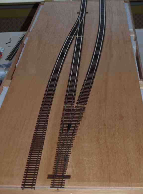

Work has commenced on my new module.
The west side board has been constructed, and I've cut and test laid the track on to it. So milestone number one has been reached. :-)
The picture shows it from the center at the bottom, with the most westerly turnout situated towards the back of the picture. The spur leading the the GERN warehouse visible to the right in this perspective.
I've not fixed any of the track yet, as I still need to drill holes for feeder wires, and turnout actuating mechanisms etc. That's my next job.
cheers, Koos

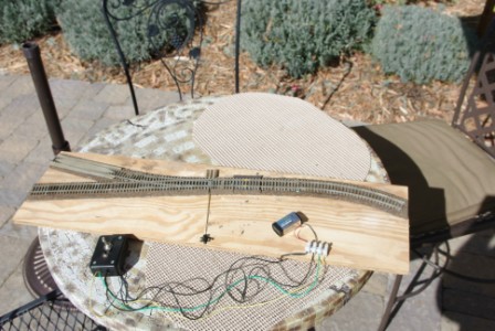

There are two possible solutions to the ground throw issue. Some guys use N scale Caboose Industries ground throws in HO, which makes them a little smaller, but no matter what you do there, you're reaching into the scenery where your 1:1 scale hand is going to do all kinds of unpredictable things. Another is to mount the ground throw closer to the layout edge, connected with a wire in a tube:
