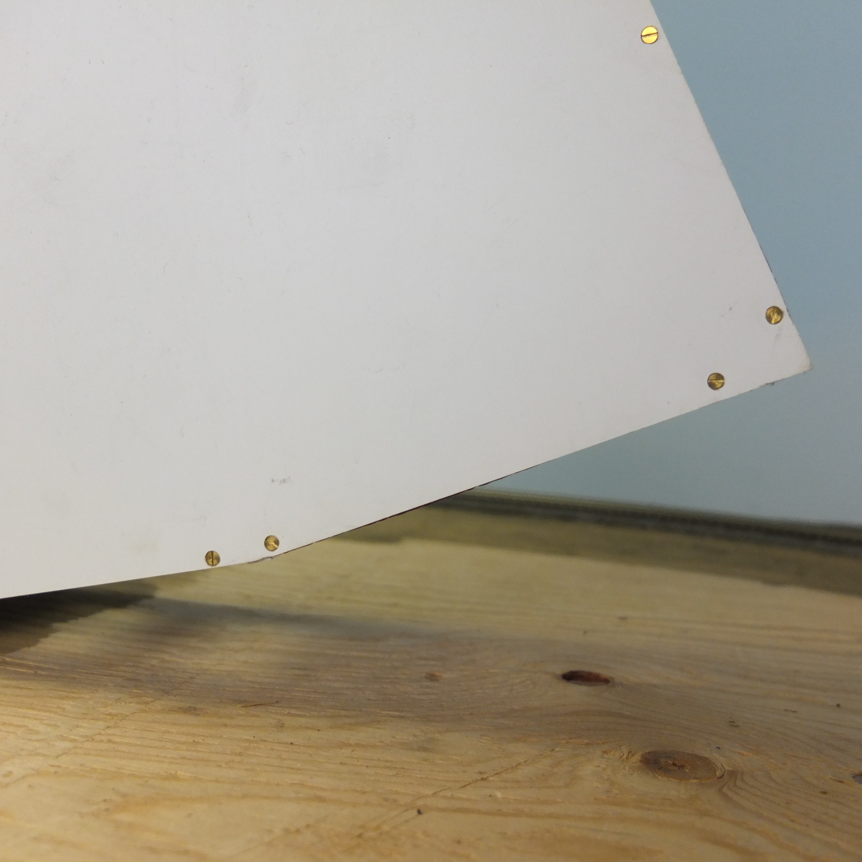

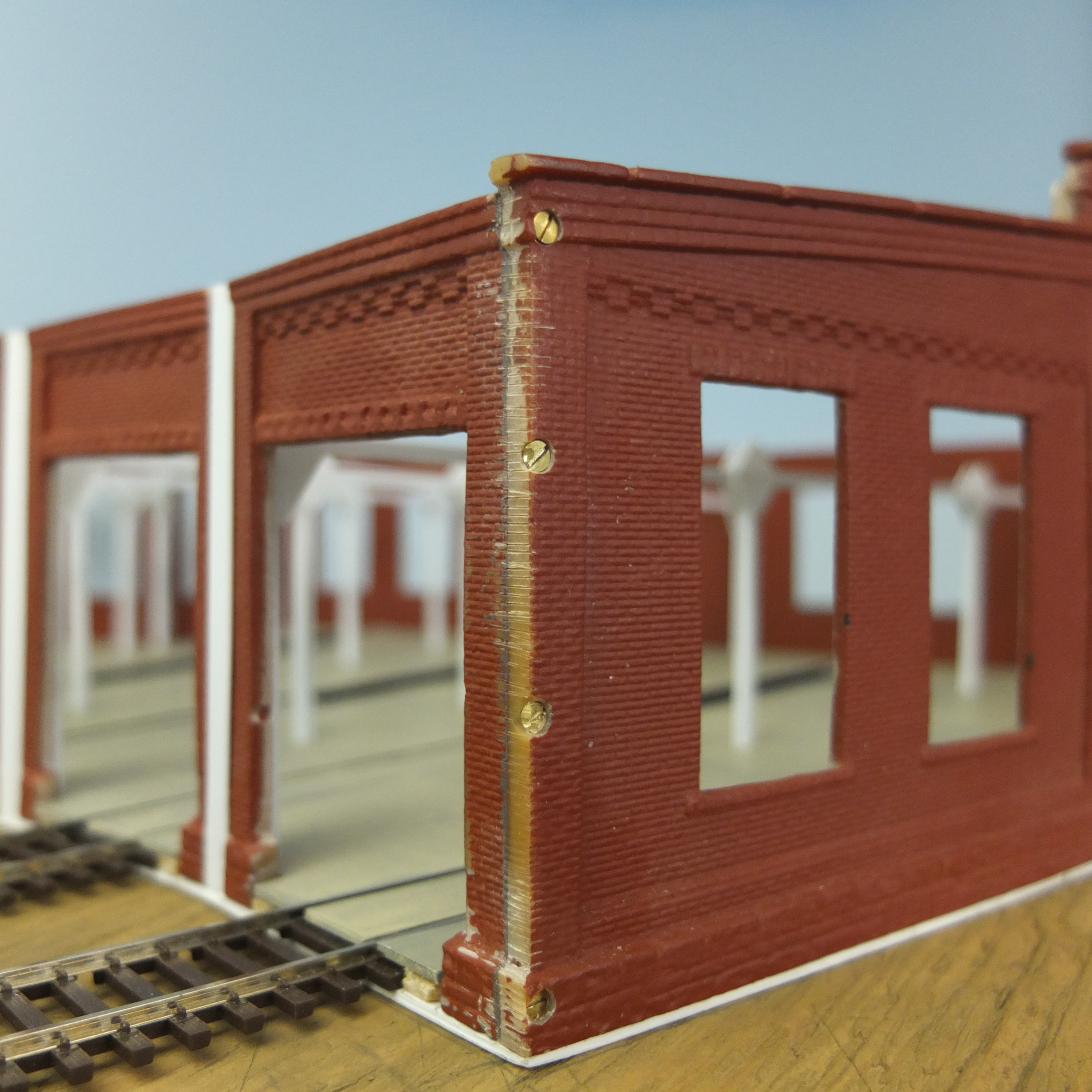

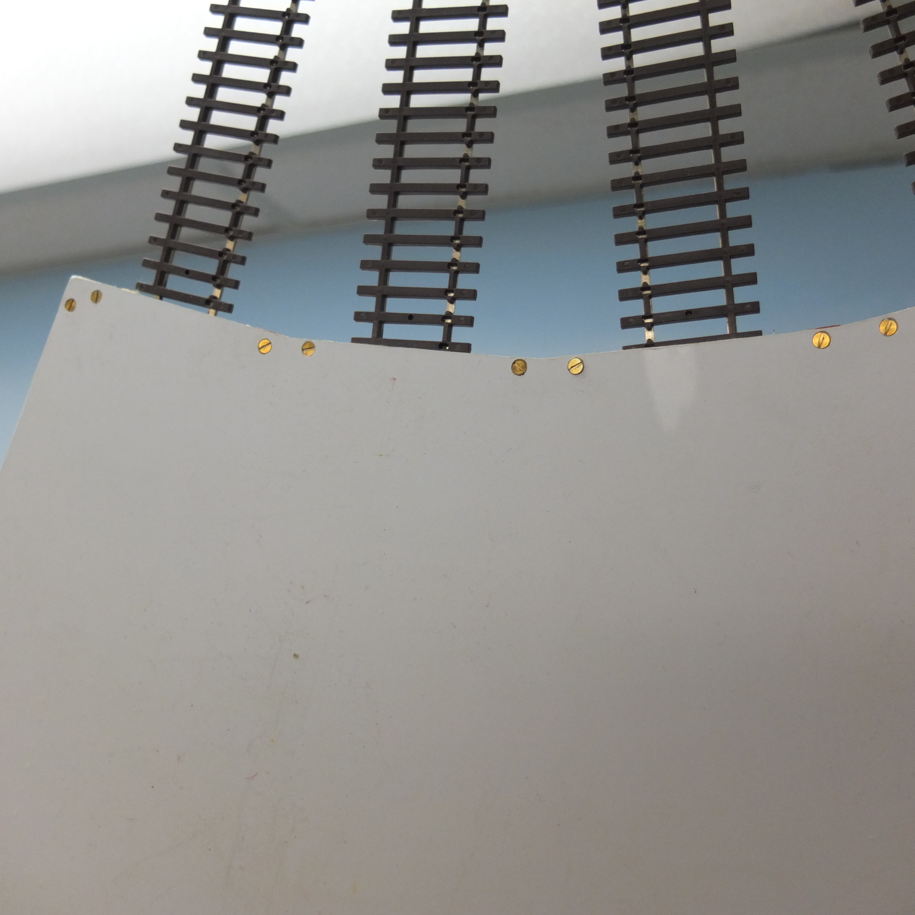

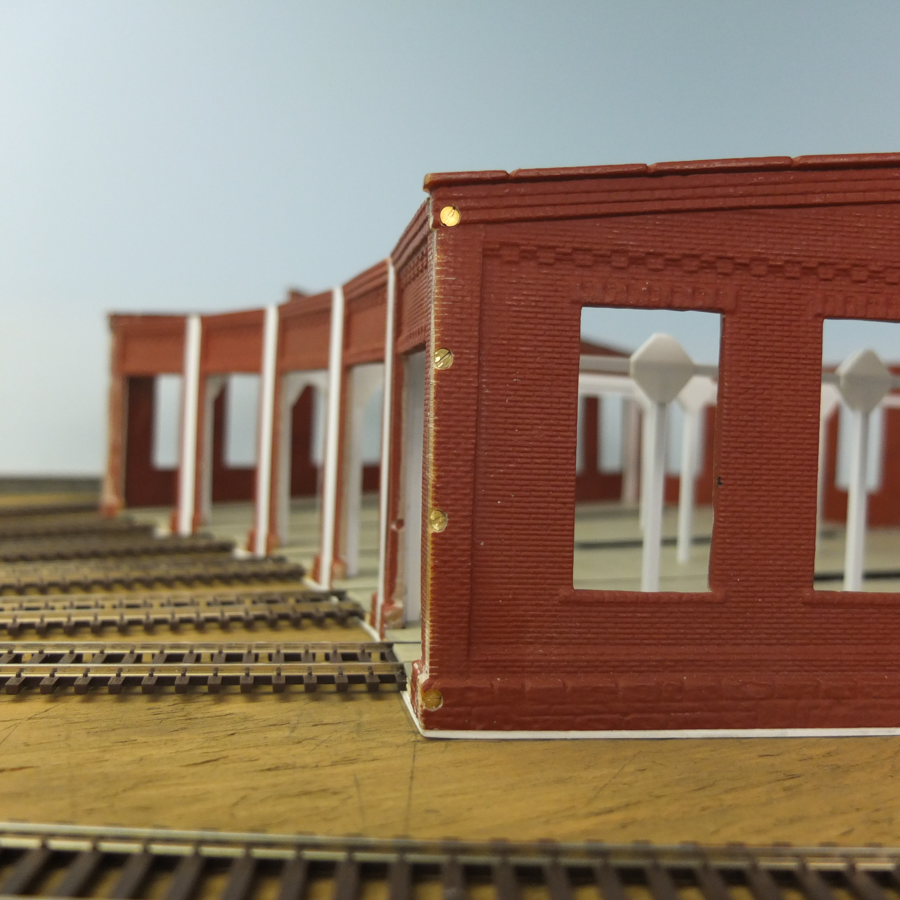

Thanks, Matt. The screws were pretty-much a necessity, as some of the walls were warped. I also didn't want to trust glue alone to keep things intact, especially during construction, as it gets handled quite a bit.

Wayne, do you have a closer shot of those screw. I'm curious. I'll have to build a cement plant in the upcoming months. The general design of the plant is similar to a roundhouse with track embedded in concrete slab and a superstructure on colums.

Thanks, Charlie, but I think that those screws may be a little out-of-scale for HO.  I have some trepidation about the way that the roundhouse will look when it's finished, mainly depending on how the brick detail looks once it's painted and weathered.

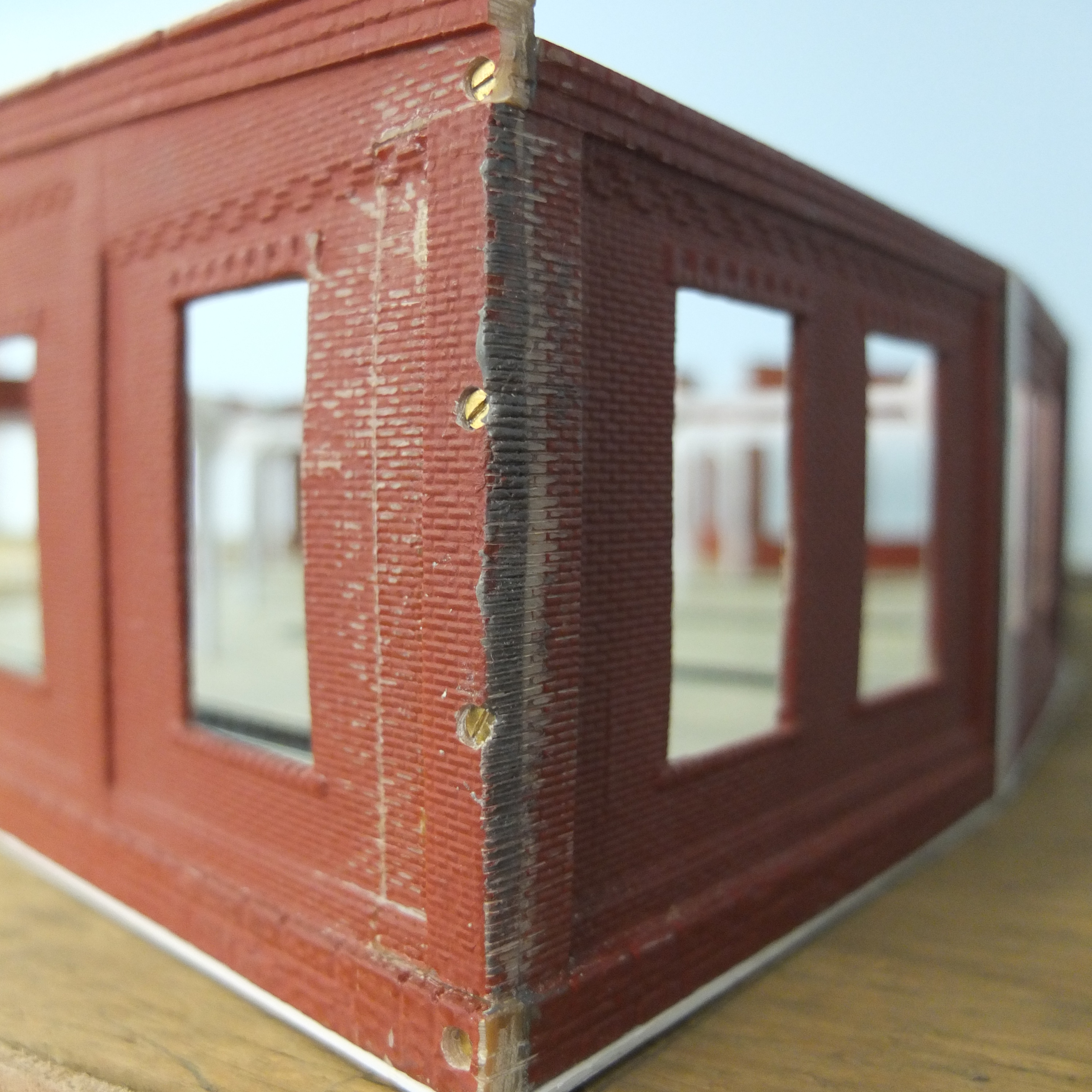

Still plugging away at the roundhouse, and I thought that I'd taken a photo of the "mortar" application, but can't find it. Anyway, here's the results of the application after the excess has been rubbed off...
The window frame is just sitting in place - I won't install them until the interior has been painted.
A few days after finishing the mortar work, I decided to weather the brick, as I was concerned about how it would look. I used a wash of well-thinned PollyScale paint, with a couple drops of dish detergent added, applied with a 3/4" brush, then added the "soot" over the doors using artist's pastels. I simply rub the pastel stick on some coarse sandpaper, then dump the resultant powder into a suitable container, and use an old brush to apply it to the structure. Since it's unlikely to get much handling, no fixative was added....
