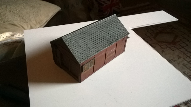

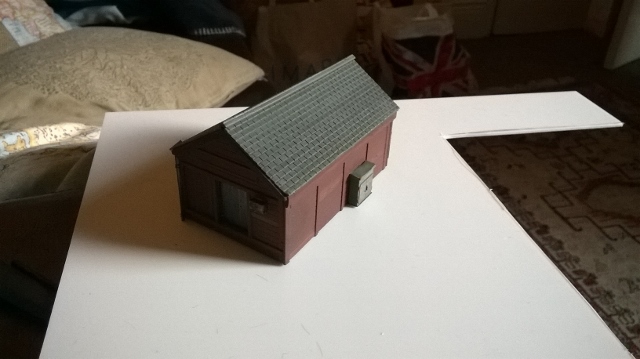

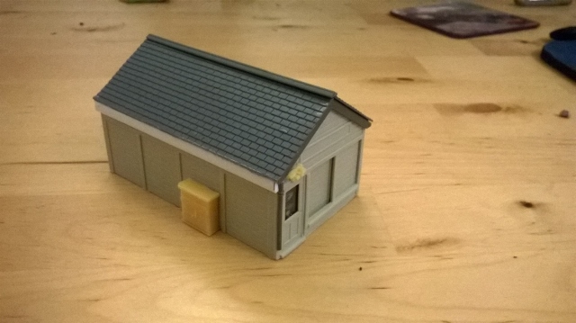

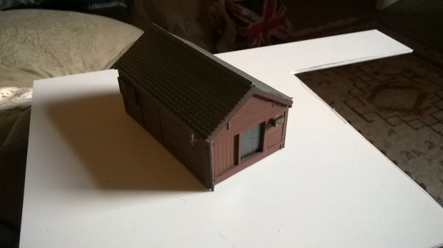

Last night I finished off building the shed for my corn syrup facility. This is the building where all the pipes will come together, where the controls would sit, etc. It is a freelanced model, inspired by various prototypes. I heavily kitbashed a Wills Signal Box kit to make it. I enjoyed building it, and I feel much more confident about scratchbuilding an actual prototype now (this will be one of my New Year projects). So at some point in the next year I will be replacing this with a better structure. For now, it will serve as a testbed for painting and weathering techniques.
The main lesson I learnt from this though is that I need to learn how to really accurately cut a straight line through styrene. Any tips? Might sound stupid, but getting a really straight edge is something I need to work at.

The best way to cut styrene is to have a steel rule and a sharp blade. For stuff up to 40 thou. I use a Swan Morton scalpel. Heavier,I use a Stanley knife. Run the blade along the rule, this will give the blade a guide. Then lightly make a few passes along the line. You don't need to cut right through. When you've got about half way you'll be able to snap it along the line. Wills kits are another matter. They can be cut the same way, just takes longer because the material is so thick. I use a band saw for stuff that thick. Bit of water keeps the plastic cool. If you find a blade doesn't cut bin it for a new one. Blunt blades are lethal. One more tip re. disposal of blades. Get a metal money box, label it "Sharps" and put the old blades in it. Have fun.
It's a good day when you wake up in the morning. It's not your problem if you don't.
#22
Steel straightedge and sharp knife. If you can find a blade that's only beveled on one side, even better. I like a straightedge that doesn't have any backing (I have one with a cork no-slip surface that I avoid.)
Measure a bunch of times. I mark near each end of the cut with the blade, then I hold the blade in the top mark, move the straightedge up to it, then rotate it to the other mark. You need to guess how far off the blade will cut.
Draw the knife lightly down the straightedge, pushing or turning it slightly in so that it doesn't wander. Then repeat many times. If you have plain plastic, after a cetain point you may be able to bend it and snap.
If you have really thick plastic, try what we call a scrawker. This is a blade that has a bit of a curl and the cutting surface is at the front and digs out a trough. Mine was sold as a Plexiglass knife.
#23
Thanks for the advice Catweasel and BR60103, I've tried what you've advised and that makes a difference. I will have to hunt down a plexi-glass cutting knife for when I next want to cut some thick styrene.

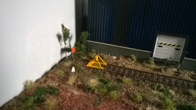

Over the last two nights I have built and painted the rail stops I recently received (thanks again to those people who helped me out with that!) I have also done the basic painting of the corn syrup control building. I have also attempted to some more trees - but still not good enough yet for photos.

That's shaping up nicely mate. A suggestion if I may re. bumpers. I don't think they would be placed right on the end of the track. Something like 4 to 6 feet would be better. That way, if they get hit, they would tend to slide instead of going off the end into the ground. I may be wrong of course. Can any one advise?

Quote:That's shaping up nicely mate. A suggestion if I may re. bumpers. I don't think they would be placed right on the end of the track. Something like 4 to 6 feet would be better. That way, if they get hit, they would tend to slide instead of going off the end into the ground. I may be wrong of course. Can any one advise?
The stops where bolted to the rails and if they where hit hard enough they would take the rails with them. So yes they are in the right place.

Hi,
Thanks for the feedback re: the rail stops. I looked at a lot of photos, and there did not seem to be a 100% hard-and-fast rule. So ultimately I decided to go with the advice from this: <!-- m --><a class="postlink" href="http://www.westernsafety.com/products/aldon2012/aldon2012pg5.html">http://www.westernsafety.com/products/a ... 12pg5.html</a><!-- m --> as this company seems to sell them. I imagine there are scenarios where they would be placed in different places on the track depending on location, additional risk factors, etc.
#27
I think there might be variations depending on how hard it might be hit and how expensive it would be if something went through. A muddy field might get a cheaper treatment than a track pointing at a busy road or a customer's warehouse.
