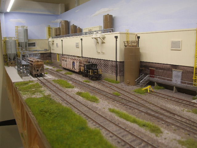

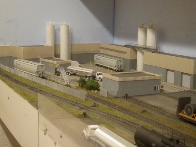

#19
You should have a look at "end of the spur" from "long island jack". My plastic pellet plant was very much inspired ("stolen") from his great buildings. Have an eye on his ballast and ground work between the tracks.
http://bigbluetrains.com/forum/viewtopic...=46&t=8612
#20
Wow Reinhard, thanks for the link...what a great layout and just my style.

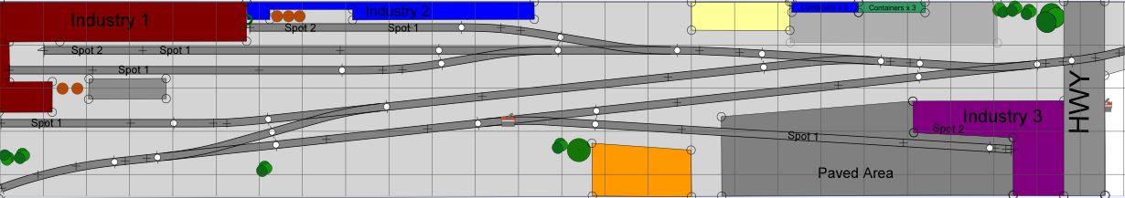

I played a bit and I could get a similar feel to it with a larger facility. Offloading of tank car at the rear track, loading boxcars at spots one and 2 of the main building and then hoppers offloading or loading on the bottom track:
Based on this just less one track so only one hopper spur:

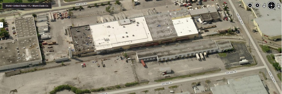

Thanks for the photo.

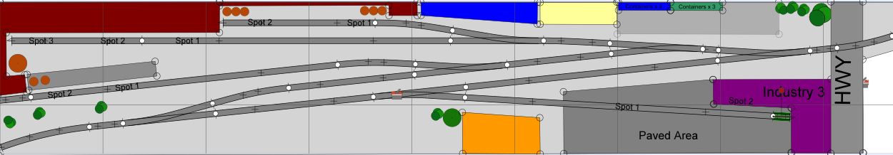

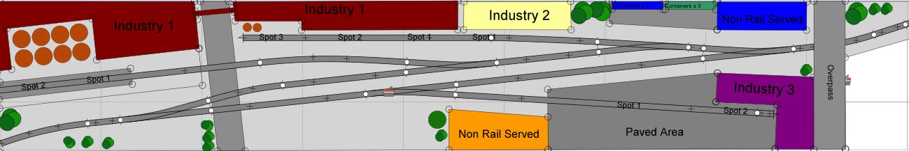

been snooping around on google maps and looking at the Riceland facilities. I'd never be able to realistically fit one of their massive facilities in this layout but I could try make it work. I like the hoppers for rice coming in and boxcars going out. Could even have a spur for tank cars as I see them in the facility, most likely for the soya element of their production.
I'm not sure if I want to model such a big facility but it has given me a chance to play around with other track layouts:

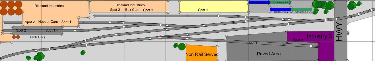

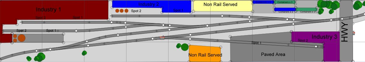

#23
#24
IND 1 (Riceland)
• Back spur – Box Cars – 2 spots plus space to store cars
• Middle spur – Hoppers – One spot with offloading grids with something like “end of spur” equipped setup but just one track but with space for more hoppers awaiting offloading.
• Front spur – Tank Cars – Oils loading, one spot for loading and one more for spare.
I could even have switching sessions where I only move cars around at Riceland, even have a much smaller loco specifically for these jobs like the one seen on google that you pointed out. My GP40 or GP60 can bring cars full onto the layout and remove the out bounds than another session would be moving internal stuff within Riceland….sound feasible?
IND 2 (Cotton or other type of “food processor”)
• Spot 2 – Tank car of oils – This could work well as they could take a full tank car from Riceland (nit if a cotton ind) when switching which is one less car to bring onto the layout and will add awesome switching.
• Spot 1 – Box cars/Reefer – Could also even take a car from Riceland but not needed.
IND 3 (Transload or Furnature)
• Spot 1 – Bulkheads with timber for forklift removal
• Spot 2 – Box cars for materials in or finished product out.
I need to look at the SSW clients and see if I can hind a customer that fits the profile…
#25
Food for thought. I would go with all Riceland Industries and have a plant switcher. Industry 3 could become Riceland Plant #2.
Larry
Engineman
Summerset Ry

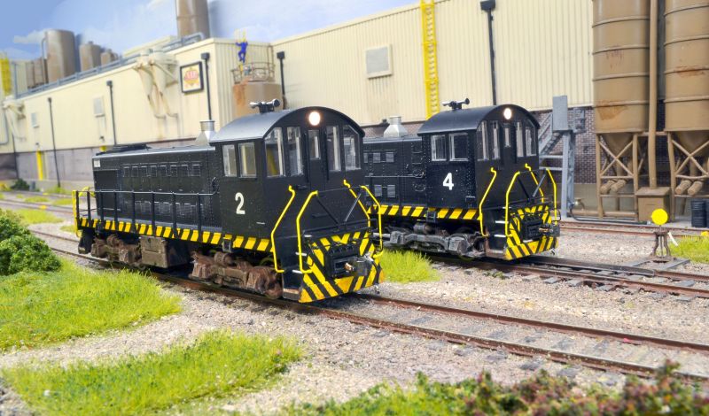

#26
Agreed Brakie,
I was thinking fo a plant switcher> I could run two different jobs, one bringing in cars (GP40-2)from the branchline and placing them at the industries then also have a small sw1500 for moving cars around at each site... Two different types of ops sessions that would be fun.
Liking this design too....
I just don't want to crowd the layout and afraid my "riceland"version does have a lot of turnouts and track in a very small space.

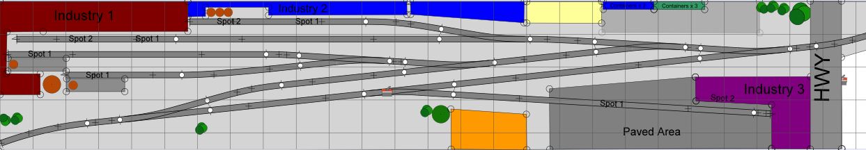

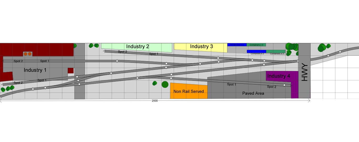

#28
Thanks for the comments Steve, Ill go have a look at those links now...

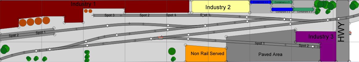

Already realizing I want to get back to basics, the Alcanman and Lance M designs seem too simple but they aren't...I'm a modeler more than a model railroader so I need to keep it simple and make space to model silos, scenic areas, fences and ROW details.
This prototype inspires me:
And it would work well on this:
IND 1 - Any industry taking hoppers and tank cars and boxcars
• Rear track – spot 1 & 2 for Boxcars – spot 3 for a tank car
• Front track for hoppers With this it could be a chemical, plastics or fertilizer plant, even bakery, easy to model with a few magic pan kits!! – Could fit some plastics hoppers in there too, have space.
IND 2 – Simple semi-served industry that only has a reefer or box car every once in a while and only for a short period. Chances of having to pull to spot would be low but can add an element.
IND 3 – Timber/Transload or similar, needs to have a type of car that is different to all the other industries.

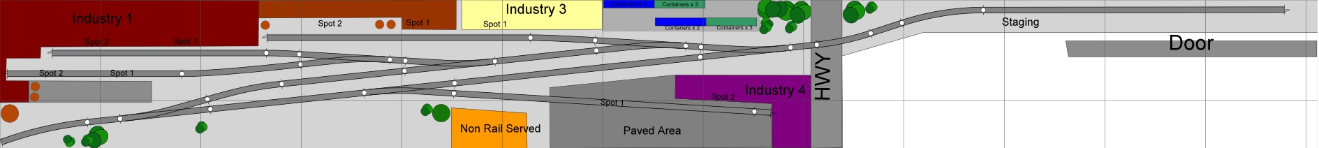

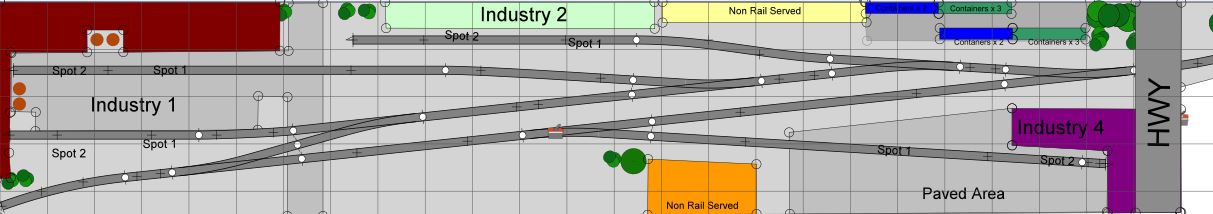

#29

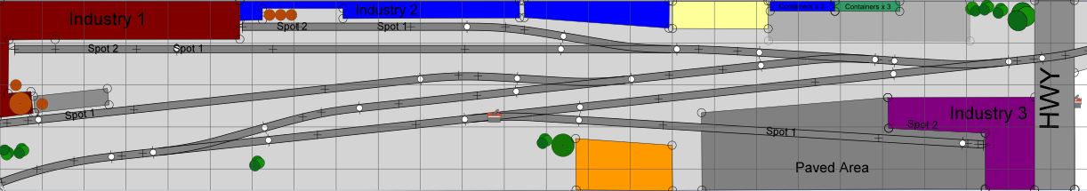

Yet another option...still keeping the track simple though... Now thinking of how to add scenes and more interest to the still layout...
Fiddled a bit more…IND 1 needs a lot of silos to break up its mass…added a fence too...
Added a road for a bit of operational and added scene…I would join the two IND 1 buildings with an overhead walkway, nice feature.
I could have a gravel area off the road towards the yellow building at the front of the layout too that could have some trucks and equip on.
