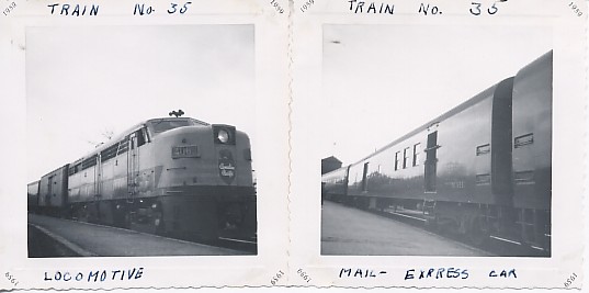

Glen:
Picture of a near relative of your loco. Location: Perth. Time: 1959.
Posts: 1,055
Threads: 68
Joined: Mar 2015
Thanks David, that's the right year, but on the wrong side of the country! On the other hand Canadian Pacific perfered to keep their alcos on the eastern side of the country and leave the west to the GMD's and Fairbanks-Morse motive power. Canadian national was pretty much the same, although I do love the looks of those FA noses.
