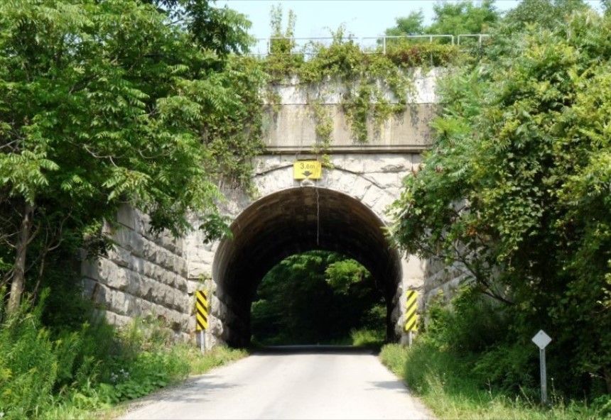

Posts: 5,263
Threads: 101
I've been following this very interesting thread and even though I cannot add any technical suggestions I thought this picture might be useful---BTW,great work and contributions everyone
