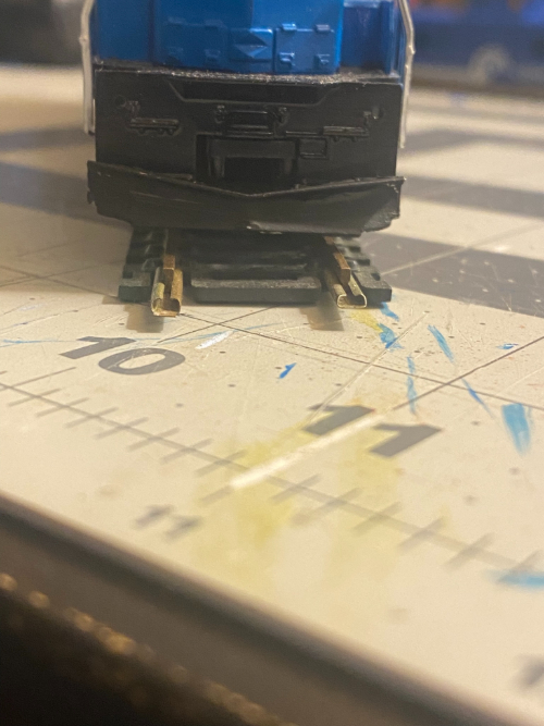

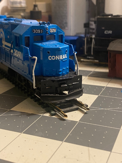

Matt,
I'm no expert, but I think it would look better if there was less gap.
Plus, you may have problems uncoupling if the plow extends too far beyond the pilot.
--Hillyard
in the real world the plows are verry close to the rail top but we as modelers we have to make some changes for reliability on tracking so if you like the look as is nail it.
Jim

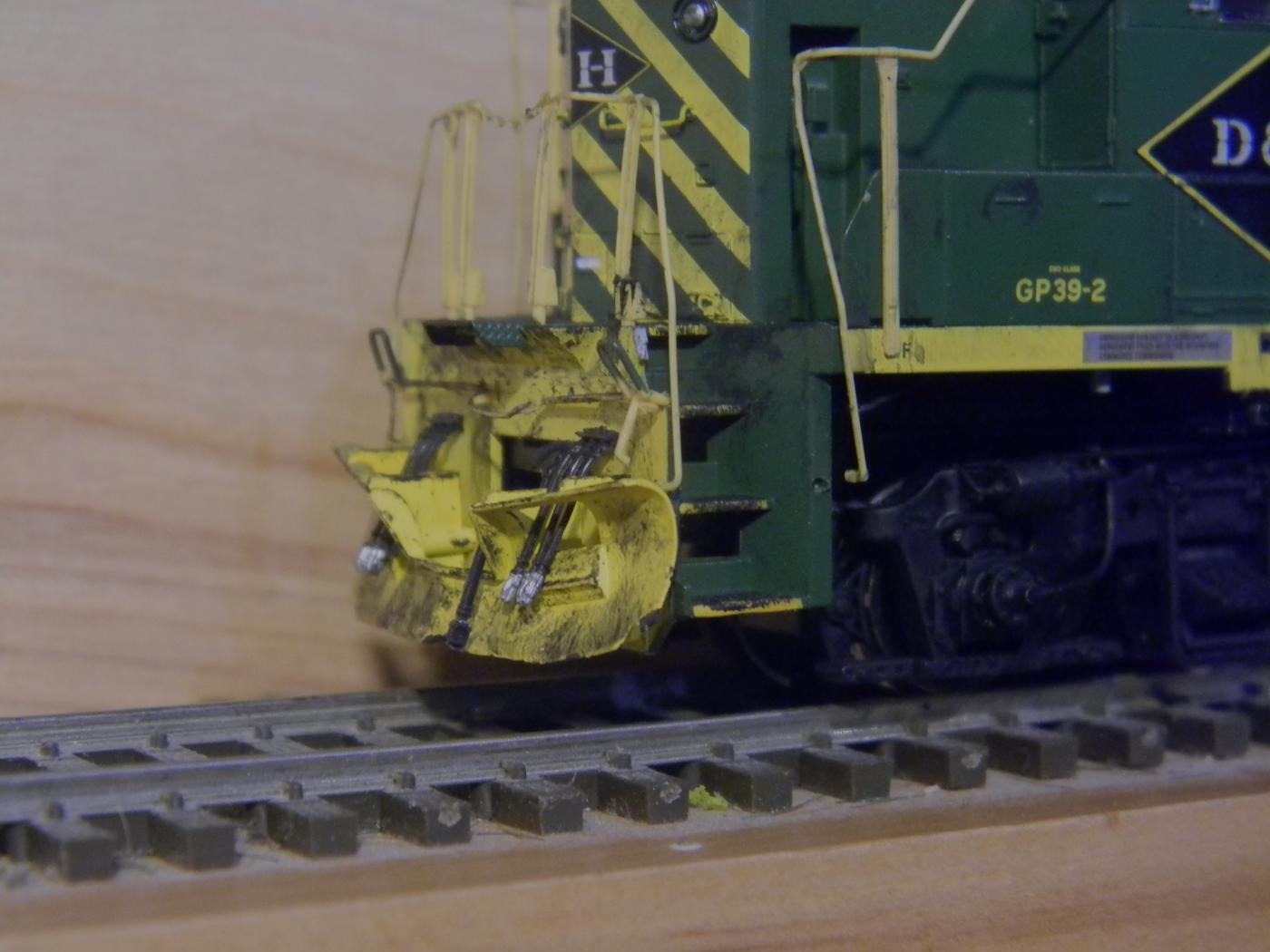

For the units that I added plows to, I ended up getting some longer length couplers from Kadee to accommodate the extra stuff on the front of the locomotive.   I do agree with Jim, to deal with typical track transitions, you'll probably end up with a plow that sits just a little lower than the bottom surface of the pilot which is not prototypical but smart in avoiding future crackups.
Here's a shot of an Athearn unit with a factory installed plow (minus coupler at the moment).
Thank you everyone. I did manage to get it figured out and I think it looks good where I have it. Now I just have to get the rear plow ground down, painted, and then glued on. After that is done then its time to continue my search for the front grab irons that I've seem to misplace.

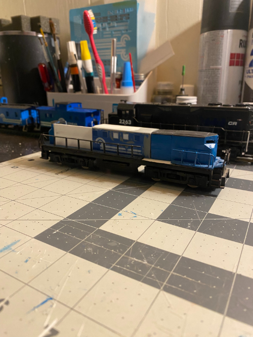

Small update to the MT-4 Slug. Progress is going at a nice pace on this and I am very happy with how it is turning out. The gaps you see will be filled in and I'm hoping to hide them the best that I can. Some more sanding needs done and pieces cut out to get it closer to being done. I am definitely having fun with the kitbash and it is pushing me to do more scratch building and kitbashing.
Conrail's Blairsville Cutoff
We're having fun following along! Keep up the good work!
(11-08-2025, 03:12 PM)TMo Wrote: We're having fun following along!  Keep up the good work!
Thank You. It definitely is a learning experience for me.
starting to look like something. the thing I use to fill gaps is automotive lacquer filler comes in white, black and red.
Jim
(11-08-2025, 07:47 PM)jim currie Wrote: starting to look like something. the thing I use to fill gaps is automotive lacquer filler comes in white, black and red.
Jim
That is different. Shocking enough using the joint compound is actually working and I didn't think it would work but it was worth a try and I'm happy with the results. I will keep the automotive lacquer filler in mind.
