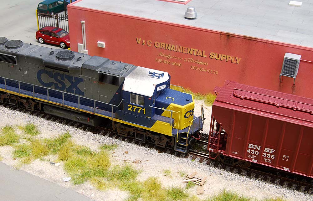

Kurt, I really like the tank! I must ask though, what do you use to weather your wheels? Chalks or paints? They look awesome, and thats one of my weak spots. I want them to look like yours! LOL

Josh, I don’t use chalks or paints, I use chalks and paints to weather trucks and wheels. I don’t use regular paint, I mix rust colored chalk with clear matt solvent based paint (Revell Airbrush email color). When it has dried, I seal it with Dullcoat. I think it looks more like rust than any paint I used so far.

Kurt, thank you!! I have the rust colored chalks, now I just need a clear matt solvent paint :oops:

Josh, I am not sure if it has to be matt solvent paint or if acrylic paint would do as well, but so far I have only used solvent paint for this purpose. If you try this method out, please tell me if you like the result.

Hey Kurt, I will give it a try. I have some Microscale Clear Flat Finish I think I will try and experiment with. Ill let you know how it works. But can you suggest a solvent based matt clear to get if it doesnt work? Like what is the brand/name of matt clear you are using? (I might have missed it if you already mentioned it)

Dullcote and Floquil Flat are both solvent-based flat finishes - I thin both with lacquer thinner.

frankcombe, I am using Micro Engineering code 70 flextrack, the turnouts are ME code 70 #6. The turnouts are sprung, so that I can operate them manually. I used switch machines on my previous layout, but I did not really like it. Coupling and uncoupling of rolling stock is done manually too. I usually use a toothpick, works fine for me.
[Image: m122.jpg]
