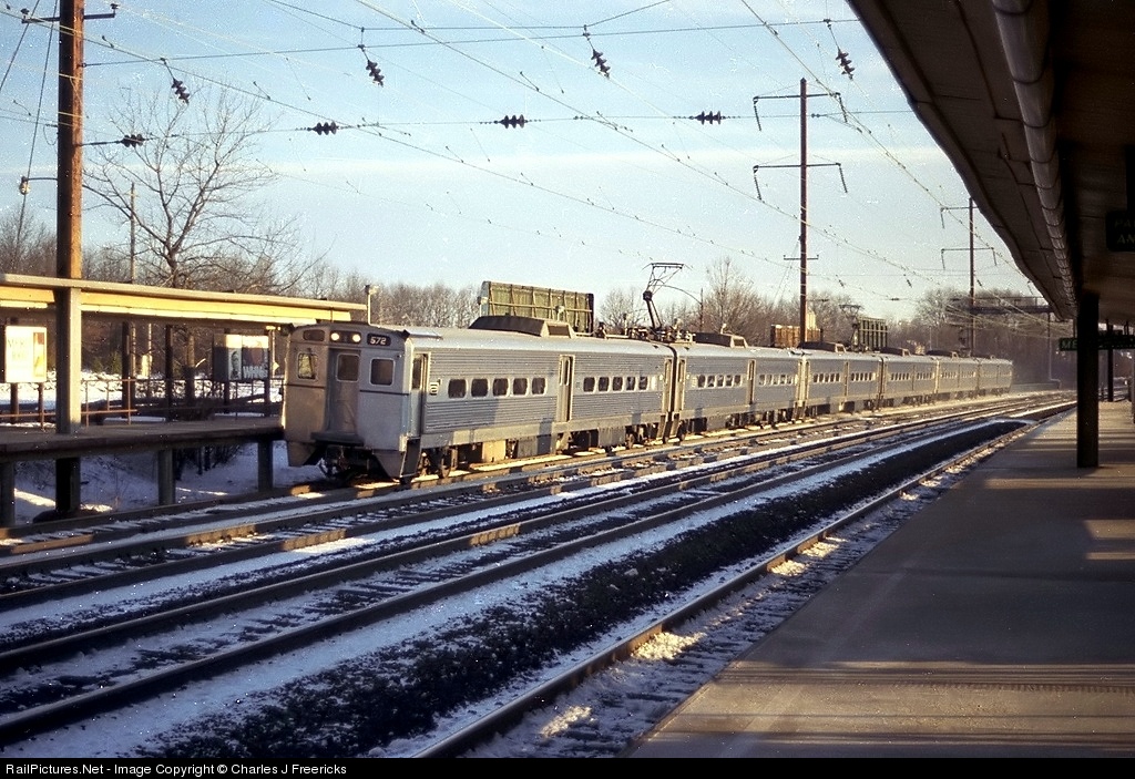

A six-car set of Arrow IIs are seen here in 1977. Arrow IIs can be distinguished from the Arrow III by the single arm faively pantograph, single roof hump, and corner air-scoops. All are married pairs that share electrical equipment.
[Image: 6402.1266465819.jpg]

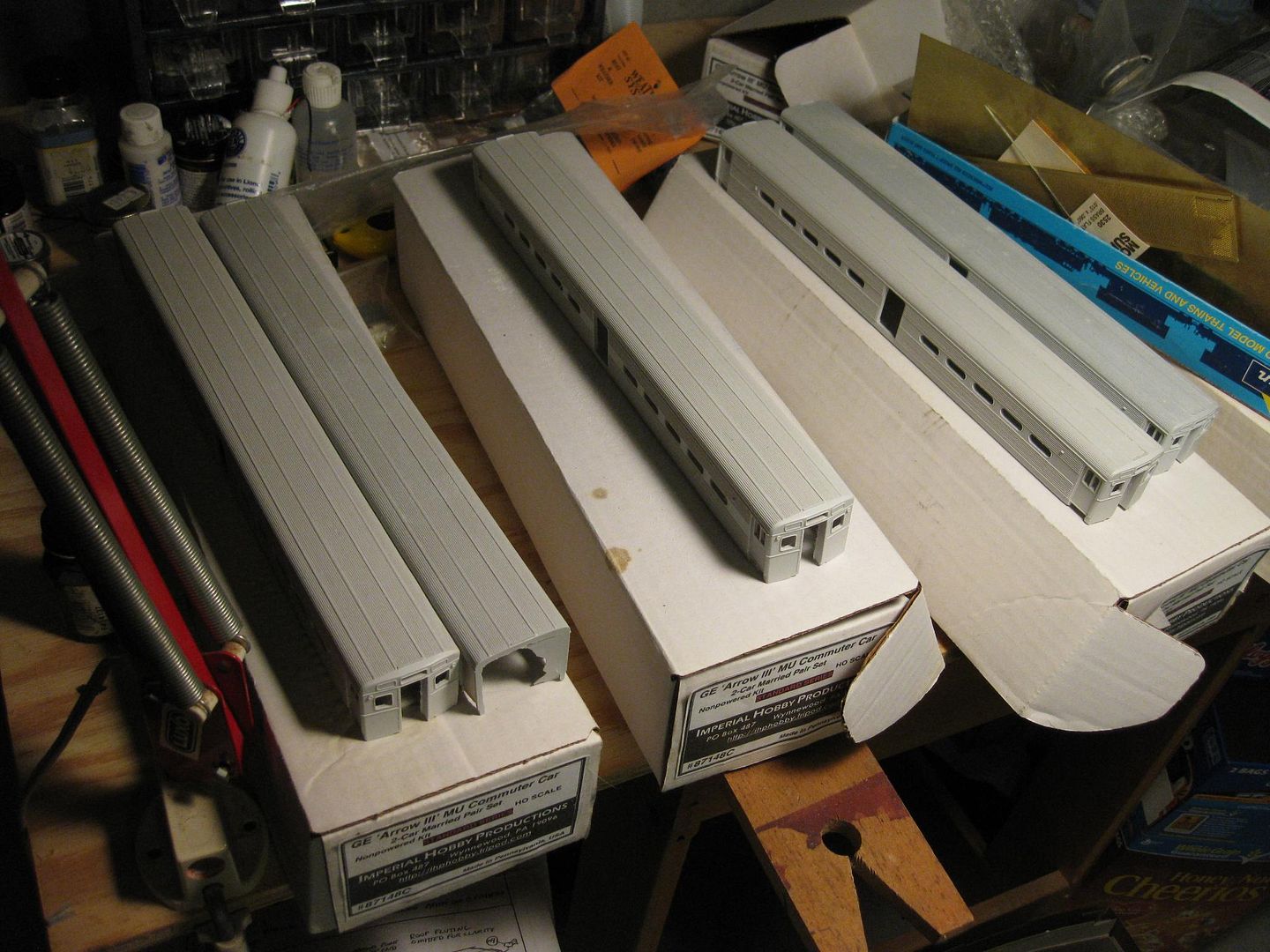

I Finally got around to building my Arrow III sets. Its very exciting, and I want to just put it all together, but I know I still have to paint most of them, and I should wait before i assemble anything permanently, since I still need LEDs and such to light the headlights and markers on these models (the cabs are not easily accessible if built as per the instructions). The only annoying part, is that 6 of my married pair kits (12 cars) were missing these small metal vent pieces. All other parts were there, so I'm assuming they were forgotten in the factory (though technically these 6 kits were second hand, they seemed un-opened). It would probably not be wise for me to paint the models without installing these first. I could use the ones I have as a guide in order to drill the mounting holes, but I think I might still wait.
Fortuneately, since i just put in an order of 8 Arrow II cars (4 married pairs) which are made by the same company, he said he'd throw in the extra vents with my order.
The Arrow IIs are supposed to arrive by the end of the month, hopefully with enough time before the Northeast Fallen Flags Rail Prototype Meet, which I plan to attend this year ( Saturday September 29, Bridgewater, NJ <!-- m --><a class="postlink" href="http://www.hansmanns.org/neff_rpm/">http://www.hansmanns.org/neff_rpm/</a><!-- m --> ).
Even if they aren't totally complete, it would be nice to have them on display.

Here is a married pair set of Arrow IIIs still under construction. These cars are single ended, but semi-permanently coupled together, both sharing power collected from the pantograph that will be on the "B" car (on the right). At the same time, the both the B car and the A car (on the left) have some equipment divided between the two of them, rather than cluttered under the floor like in the Single units.
Incidentally, all the Arrow II cars are married pairs, and will be its similar to this.
They still need to be painted before the windows can be installed, and the steps have to be installed last, after all the headlights, tail lights, and in this case, power-plugs between the cars are installed. Still working on pantographs, but I wonder if Walthers will sell spares from the metroliners?

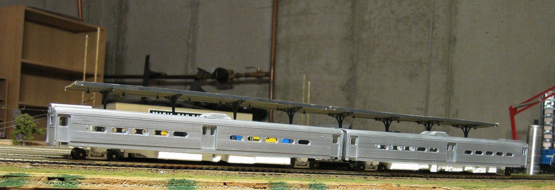

Speaking of the "Single" Arrow IIIs, I just added grab irons to mine. This is the "A" end, which is the blank end on the Married pairs. This is why this car has a ladder on its face. It was a huge pain in the butt, since the end-door grab irons were a pain to install. I knicked the model a little, but it doesn't show up in photos, so i'm not to worried.
Even though this came with silver paint, i'll probably repaint it to match the others, which will have more metallic paint on it.
[Image: IMG_0081.jpg]

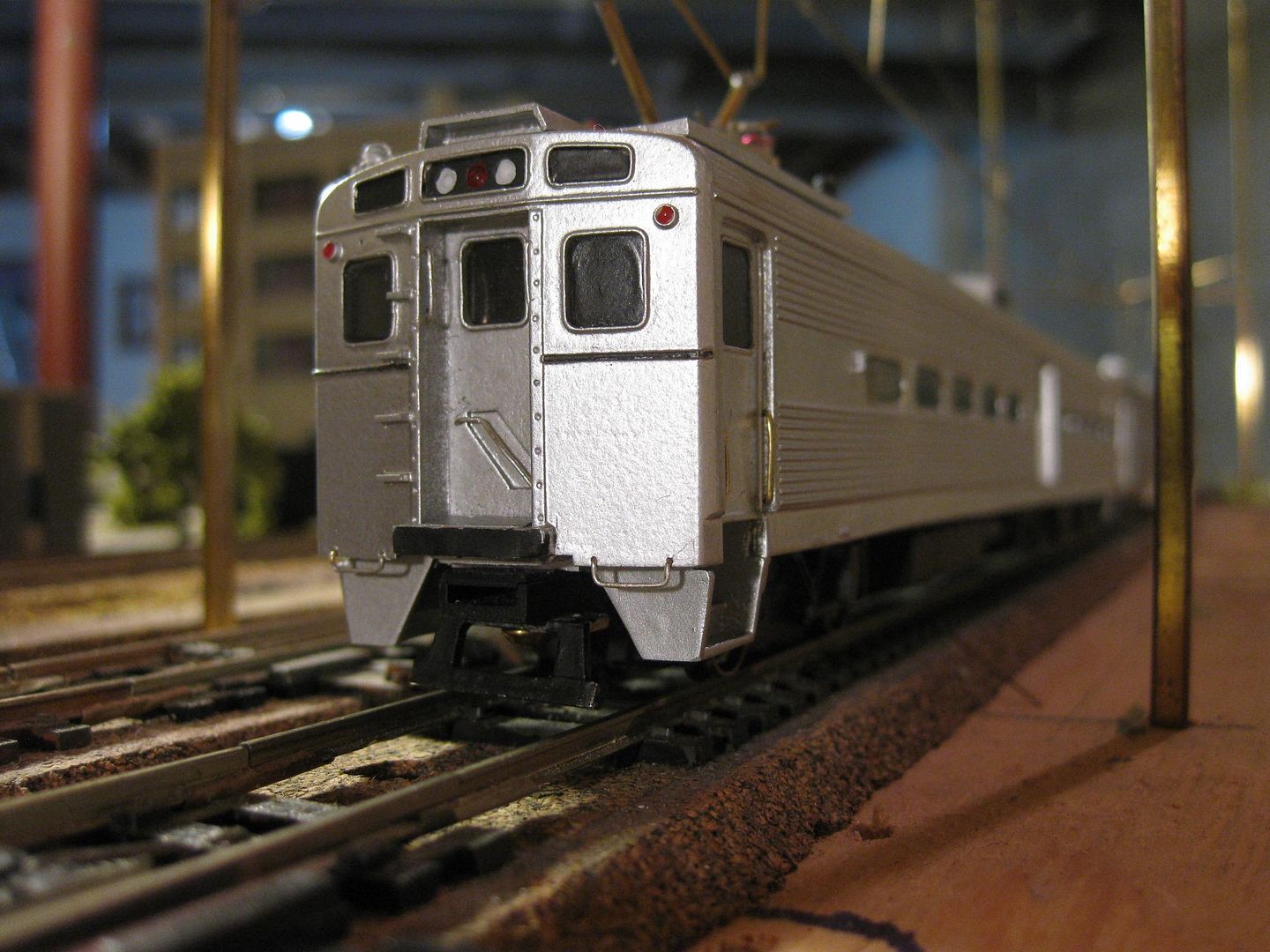

Once I finish repainting my original single Arrow III (which is also powered), I'll have at least two powered cars, that might be able to haul the married pair cars around until I can power them.
here are some additional Arrow III bodies cleaned up and ready for assembly.
[Image: IMG_0092.jpg]

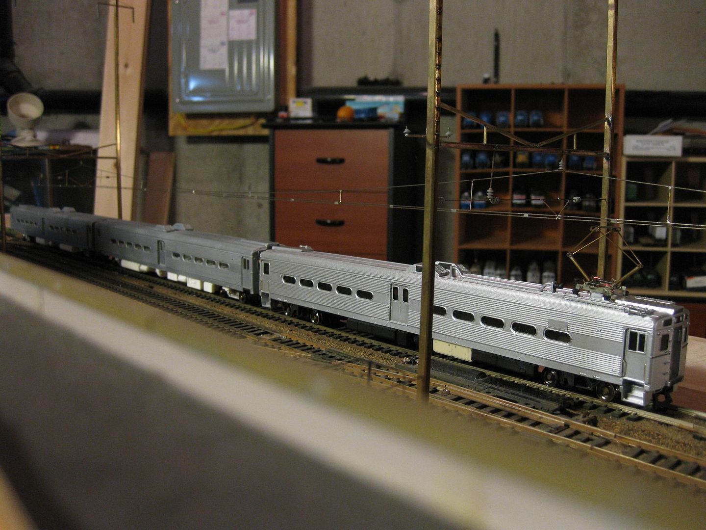

For now a "mock" three car train
[Image: IMG_0089.jpg]
[Image: IMG_0087.jpg]
[Image: IMG_0085.jpg]

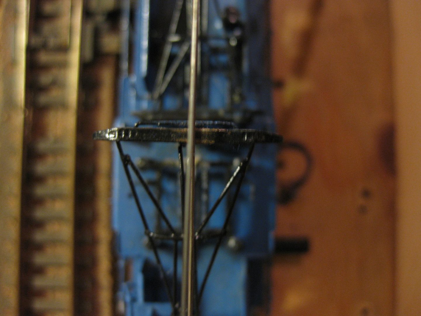

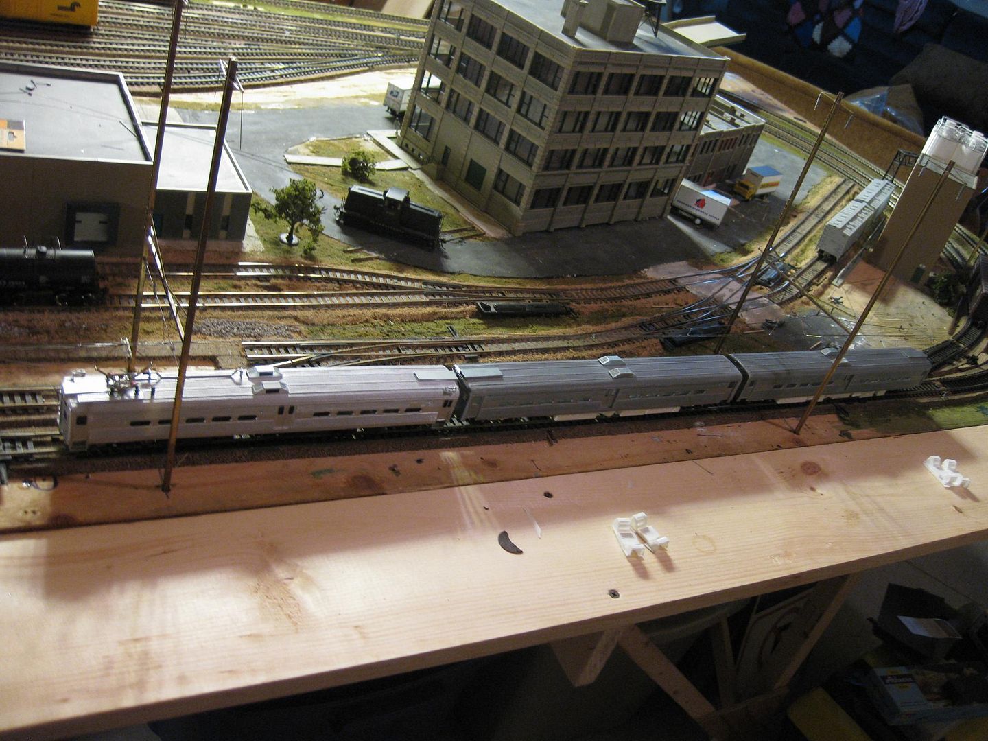

Also, as may be visible, I've installed my first lenght of overhead wire, following my PRR diagrams from the compound catenary (which includes the curve Messenger wire, then an auxilliary wire, and finally the contact "trolley" wire. Simple catenary is just the Messenger and trolley wire).
Its been a learning experience. Making the wire was not teribbly difficult or even time consuming. The hardest part was actually attaching the wires to the catenary towers. In the future, I will leave some additional excess on the messenger wires where they connect to the towers, since these might help adjust the tension. I'll cut them flush when the tension is good. another problem, is since the system isn't totally complete (no actual "anchors" for the wire yet), I'm not sure the tension is even going to be that fantastic.
Having the wire there is also good practice for NOT bumping it. So far, i've had several small breaks, but everything was quickly repairable. the system will probably become more stable as more wires and catenary towers are added to maintain tension.
Another problem is that the wire has ALREADY begun to wear the pantograph shoes of the test enginees! brass is already visible on the pantograph of my E44!
[Image: IMG_0120.jpg]

Its all patience! I use the smallest diameter solder and Tix flux, which seems to work. Besides, I don't think the catenary is as hard as it looks, it just looks scary when its all done. The individual components are relatively easy to build.
