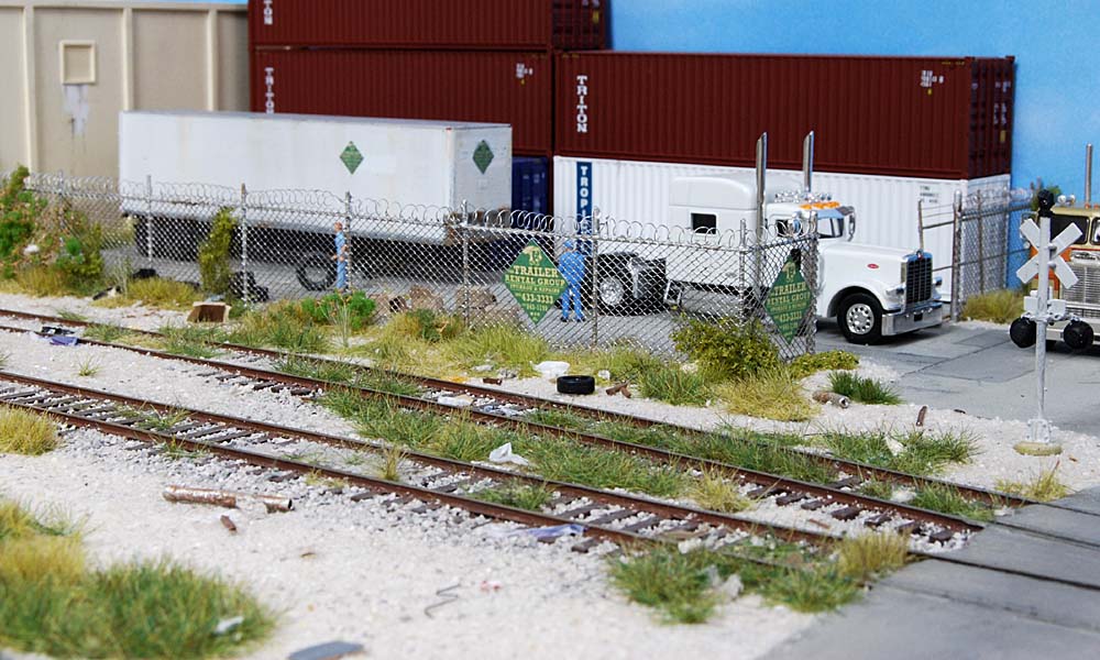

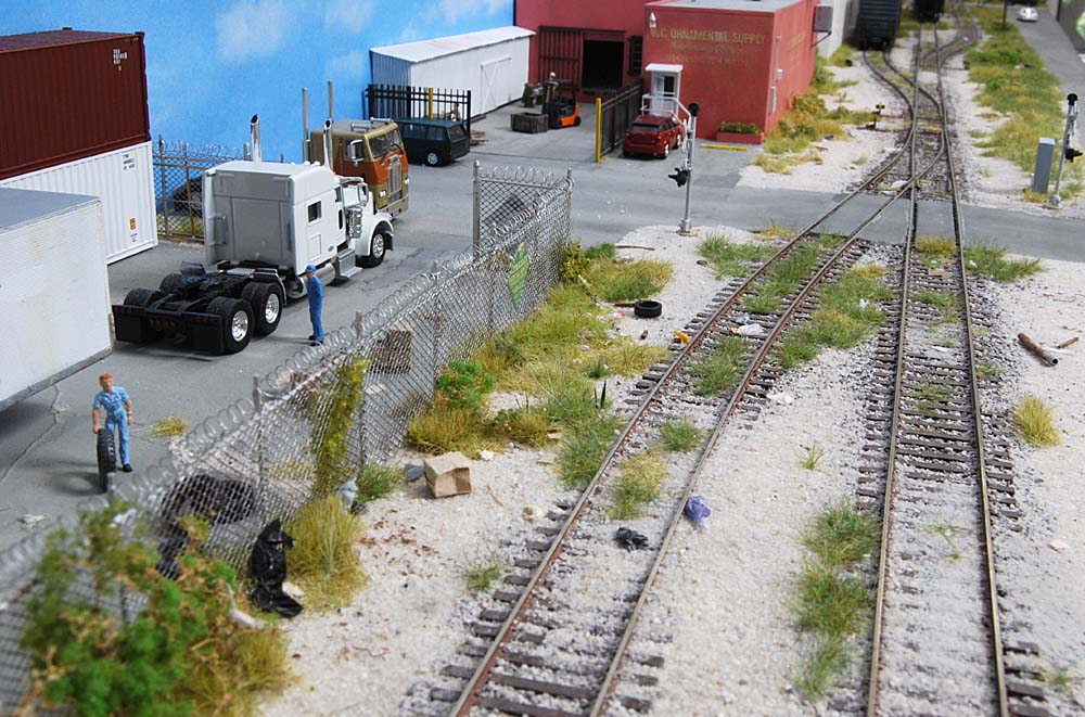

So, as announced earlier, here is some more trash. I try to give some spots a more heavy treatment and not to spread garbage evenly on the layout ... more to come ...

Now THAT is the kind of detail I want in my industrial areas. Keep up the great work and keep posting photos, Kurt!

Just one incredible wealth of detail ... I've just now spent more than the last several minutes staring at all the wonderful details in that first photo at the top of the page!
Beautiful!  :mrgreen:

Okay, seriously Kurt, my jaw just hit my laptop keyboard when i saw those 2 pictures above! That is by far, the most beautiful trash I have ever seen!  Im speechless right now, and I cant wait to see some more pictures!!

Kurt,
The additional trash looks great. You have really matched the photos for a realistic scene. A couple of questions come to mind:
What are you using for your soil base color?
Also, are you using a light ballast for your ground cover?
I am presently considering a light gray for the base soil color mixed with "Mudstone"from Ceramic Coat, a brown gray color that Lance Mindheim suggested. This color is available from Michael's Craft Stores. I will be using light gray/white N scale ballast stone from Arizona Rockand Mineral for the tracks as well as the general base cover over the paint. The soils in the Miami-Dade area are a dirty white-gray in color due to the high marl content.
Larry

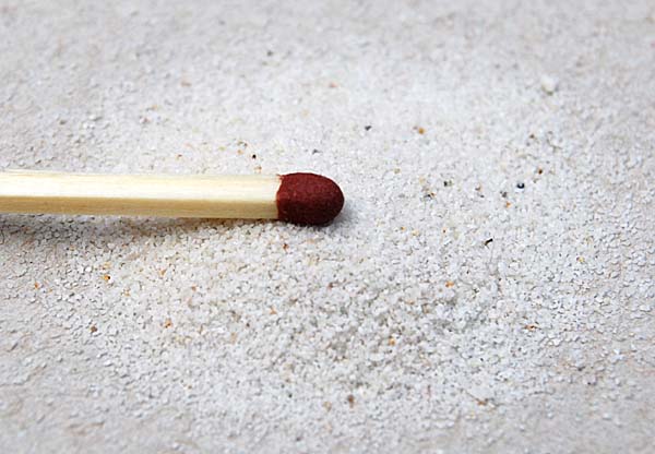

Thank you guys, for so kindly responding to all this trash. Let’s face it, we are all pretty weird!  Me, because I enjoy putting all this garbage on my layout and you, because you are so delighted to see all the trash ...
Larry, my ground cover is very fine white sand (the stuff you’d put into a hour glass) that I mix with a bit of coarser, lightly darker sand. I add gray tile grout to achive that dirty white-gray color you mentioned. Unfortunately, that gray color does not show as well in the pics as it does in person.

cnw1961 Wrote:Larry, my ground cover is very fine white sand (the stuff you’d put into a hour glass) that I mix with a bit of coarser, lightly darker sand. I add gray tile grout to achive that dirty white-gray color you mentioned. Unfortunately, that gray color does not show as well in the pics as it does in person.
I found a small jug of "decorator's sand" or something like that at the dollar store, Is that the same type of white sand you are talking about? cause if it is, I could do most of the basic scenery on my layout for about $3

Justin, here is a pic that may help you to decide if the "dedorator’s sand" you found looks like mine.

Thanks for the picture Kurt! That looks just like the sand I found at the dollar store, If the pebbles of sand are about the same size I could easily spend only about $3 or less on sand for my layout, Looks like this means another trip to the dollar store.
