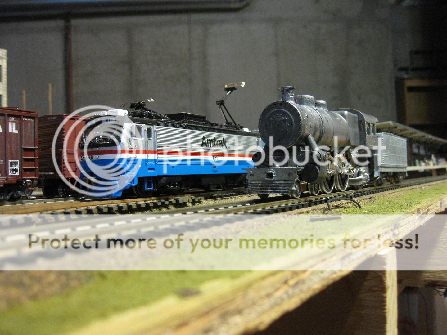

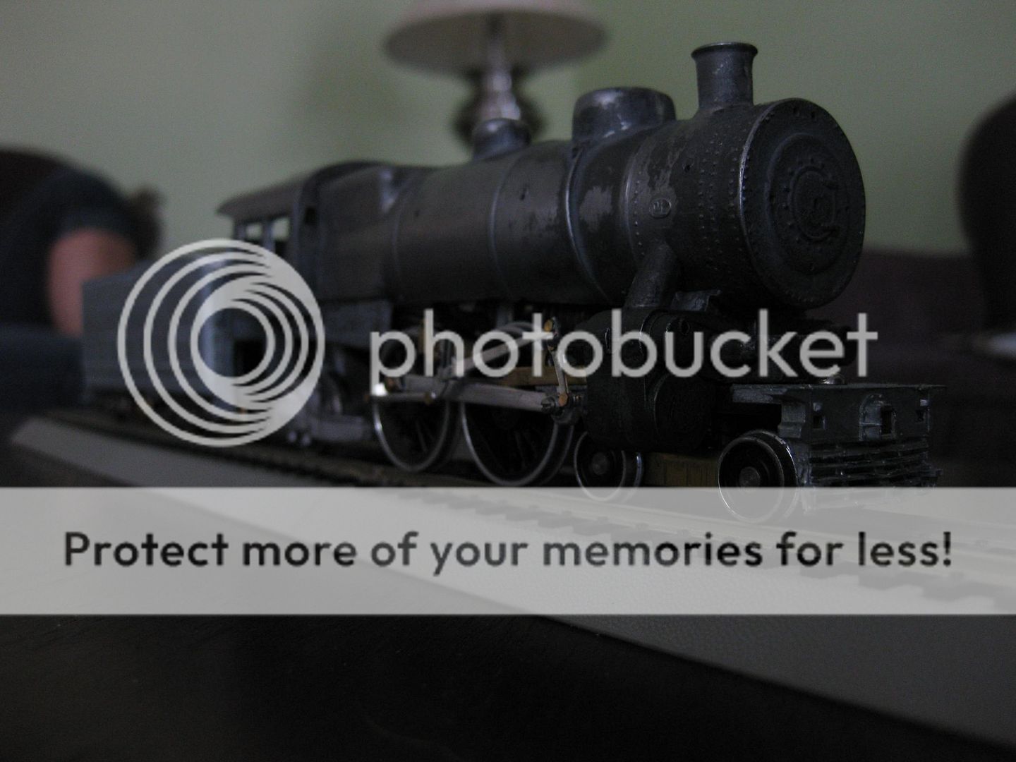

Pennsylvania Railroad E6
I picked up an OLD bowser kit of an E6. These 4-4-2 locomotives were the top passenger steam locomotives in Southern New Jersey service. Though generally overshadowed by the railroad's K4 Pacifics, The E6s broke several speed reccords, in particular when the crew of #460 was told "Go as fast as appears safe", when racing aircraft footage of Charles Lindbergh to New York city, reaching up to 115 mph on what is now the Northeast Corridor.
The model has been a little frustrating, since part of the cylinder casting came off, and so I'm working on putting a "post" in to hold it back on. The valve gear and pistons seem to have some resistance, but it doesn't seem to be to detrimental. The motor probably needs the most work, but i'm told that I can refurbish the motor (as opposed to buying an expensive Helix Humper Can motor repowering kit).
I'm still trying to get more detailed photos of the locomotives, and while the REAL #460 is only an hour or so away at the RR Museum of PA, I think its being refurbished right now, so i'm not sure if i'd be able to get a good look at it.
[Image: IMG_0325.jpg]
[Image: IMG_0334.jpg]
