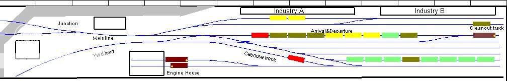

[Image: popp_yard.jpg]
In N scale, a yard area that is 14 feet long in H0 scale would be about 7 feet 8 inches. That is from the far left end (yard ladder) to the far right. Body tracks is contained within an 8 foot long box in H0 scale (about 4 feet 6 inches in N scale).
The shortest of the three yard classification tracks in the Popp-inspired plan here are long enough for eight cars. The primary A/D track is long enough for an arriving train of eight cars, an engine and a caboose.
In contrast, you have 9 body tracks or AD tracks, plus a ladder bypass/caboose track in your the yard and four tracks, a turntable and a five-track roundhouse for the engine terminal.

[Image: image.php?album_id=6&image_id=569]
[Image: image.php?album_id=98&image_id=1460]

E.g. like this:
[Image: DSCN4390.JPG]
Not ideal to have a duck-under/lift-out in front of the door, but model railroading is often a question of trade-offs and compromises.
Anyways - if you are going to do dog-bone shaped layouts with turnback curves at the end, I would definitely recommend staying in N scale - going to H0 scale just makes it worse - you can reach in across 30" of table to reach the innermost end of a N scale 14-15" radius turnback loop, even at a fairly high shelf, but it is pretty hard to reach across 44-46" of table to reach the innermost end of a H0 scale 22-23" radius turnback loop.
Smile,
Stein
