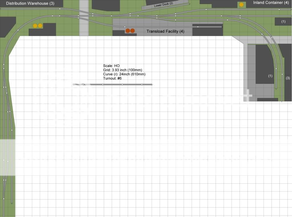

What app are you using to draw your plan?

I'm using Anyrail.
It is downloadable from the net in a demo version which is good but I boutht the licence and it is well worth it and so easy and straight forward to use.

Well was hoping to start the shelf this week but there is a problem with my order and so the materials will be here Tuesday. I've gone for a shelf system and design similar to Lance M's books but instead of a hollow core door I am laminating 1 inch thick high grade foam between two 3mm pieces of masonite with a 1 inch pine edge... Basically i have used this design before as a roof structure on my house and it is increadibly light and strong. Will post pics as soon as I start.
Here is the latest version of my ISL... Which needs a name guys!!!

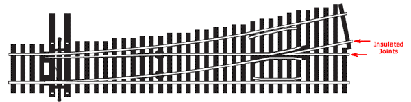

So I have bought my DCC system some time ago, a Digitrax Zephyr, seems to be all I need for this ISL and it is a breaze to use so far. Also have the programer so now all I need is to figure out the wiring.. I have PECO code 83 Electrofrog turnouts that I will be using so my questions are:
Is the Zephyr powerfull enough to run this layout without a booster?
Can I wire it as simply as Lance mindheim does the Palmeto spur in his latest book (Bus and feeders off to each spur?
Do I need to rewire the Electrofrogs as per the instruction in the package or is there another way or can I run them out the box?
Thanks

On a former layout that I ran with a Lenz DCC system I used Peco Electrofrogs straight from the box without any modifications made and I did not have any problems with cars or engines causing shorts by touching point rails and stock rails simultaneously. You only have to use insulated rail joiners on the frog rails.

I agree with Kurt. He practically described my setup, only different thing being I use the D'trax Zephyr. The Z has plenty of punch for that layout, just use the proper gauge wire for your power distribution (12-14 ga.) and feeders (18-22 ga.).

Just wondering where exactly those insulated joiners will go, just onto the rail ends which lead to the frogs? Would that in effect be doing the same as the modification detailed in the PECO packaging?

SSWUPinSA Wrote:Just wondering where exactly those insulated joiners will go, just onto the rail ends which lead to the frogs? Would that in effect be doing the same as the modification detailed in the PECO packaging?
Callum;
Using insulated joints as shown here should work just fine without making any of the optional modifications shown on the Peco instructions.
I used the Electro-frog turnouts this way and never had a problem with them.
