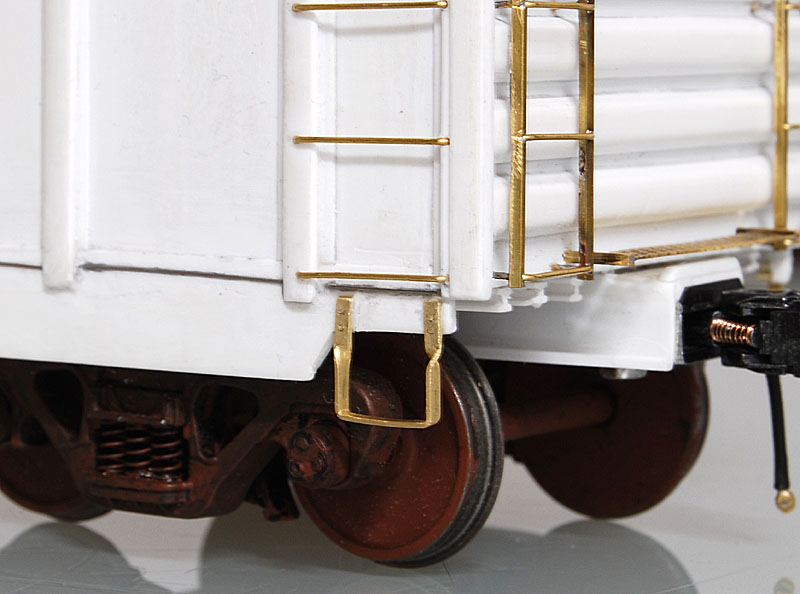

Bernahrd, I used a T-shaped 2 mm brass profile for the door tracks. I soldered three little pieces of 0.8 mm brass wire to the long leg of the T to hold the tracks. Two of these pins were soldered to the top of the T so that they are hidden by the door now and the third was soldered to the bottom as you can see in the next two pics.

Stirrups. I used a .050" x .010" brass strip and fixed the stirrups on the car with .020" brass pins and CA.

![[Image: ps27.JPG]](http://www.cnw.mattheydesign.de/ps27.JPG)
Extremely accurate worked details! I love such handmade precision.

I'm just blown away..!!
The styrene work is fantastic...But the metal work is "out of this world"...
Having done some of this on my "scratchbuilt" 2-8-2, I can attest it is no easy task, but the accuracy and workmanship shown here is just at another level altogether...!!

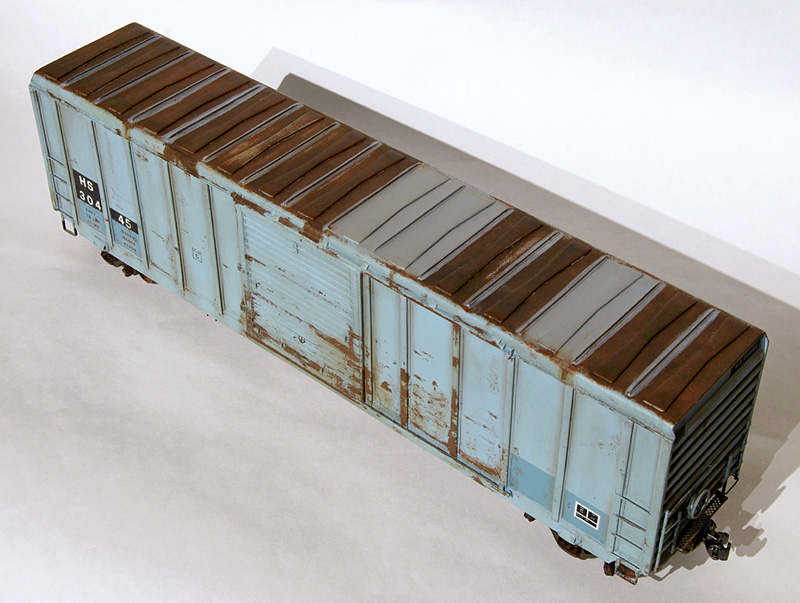

Gus, don’t forget it is O scale. That makes the metal work much easier and when I take pics, I scale them down to the same size as if I had taken a pic of a HO scale car … so they’d better look good or it would mean that I had done a lousy job
Progress has been slow, but now I only need to add a few more details and the car is finished. Since my last post I have added the upper door tracks and the brake gear. The white metal brake parts are from Selley. When doing the brake gear I was not interested in absolute accuracy, I only wanted to make it look right when viewing the car from the side at eye level.

Kurt,
Glad to see you posting again. What a great looking scratch built car, along with a truely believable paint and weathering job. Nicely done.
Any updates on the layout?

A very realistic aging, Kurt. Enjoy your work!

Wow that is a superior modeling job very realistic

Absolutely beautiful work! It looks 1:1 REAL!!!!
