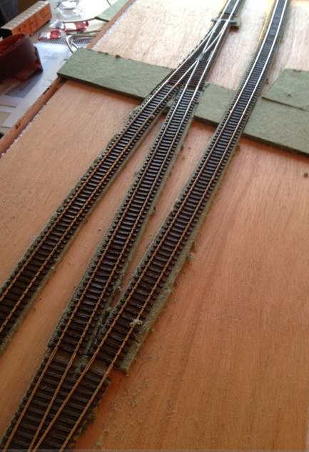

Hi all, I've struggled a bit recently to make some progress. I was looking to get material to make my roadbed with, and I intended to use carpet / underfloor tiles.
It's currently difficult enough at most DIY stores to get the right type of underfloor here in the UK. Most sell foam rolls, or have tiles that have a much coarser and more brittle fiber at present, and usually in packs which they often do not want to open. However I found some loose ones and could continue with the module boards.
Why underfloor tiles? While any other roadbed (cork or foam types) would be good for the tracks, I want to use the same material as the base for the roads and line side structures, as to bring them up to the same level, on a level surface. These tiles are relatively easy to cut, if you take your time, and use the right tools.
I've found that knives work, but they need to be clean and sharp, otherwise they'll start to rip into the material. A better option is a razor saw, which cuts cleaner lines. It creates a bit of dust though so have a vacuum cleaner at hand to clean everything up after you're done.
After the roadbed is glued down (using no more nails or similar) it's easy to use a few rail spikes to secure the track , in addition to some white glue mixed with alcohol (70 or 90% is both fine). This mix will ensure that if you make it wet again, it will turn back in to a gum like consistency and you can remove the track for future use. Don't worry when ballasting, the glue will set again after it dries.
Next will be to use Woodland scenics hydrocal, or another landscape moulding material, to smooth the edges and surfaces of the road, the sides of the trackbed and other landscape contours.
Then I will paint the surface of the entire board an earth colour, as the base of all scenery.
