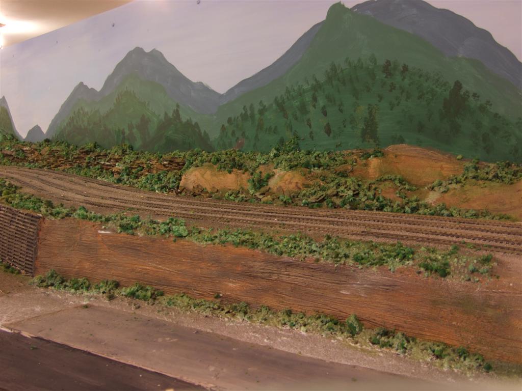

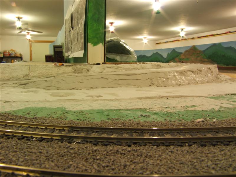

I took every thing back off the area so I could plant some grass and bushes. Probably will take the glue about 3 months to dry. Icon_lol
I used all the foam I had made so while this is drying I can make another batch.
Background building bonanza, boomtown building explosion, and now flash forestation - I'm gettin' exhausted just watching all the progress you're making. Eek It's a good thing that I'm not there helping - we probably wouldn't even be started yet. Misngth Misngth Lookin' good, my friend. Thumbsup Thumbsup
If you were here, we would be drinking coffee and watching train videos, thinking about working on the trains.
Your shots and Ed's pictures, as well as Ralph's motivation have built a fire under me.
I was at a standstill for a while trying to figure how to make this area work. In this case, the best plan was no plan at all. It worked out that I did what would have to be done in the real world, and I think it will come together very well in the end.

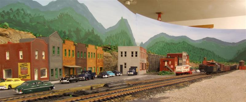

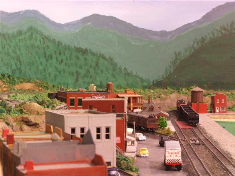

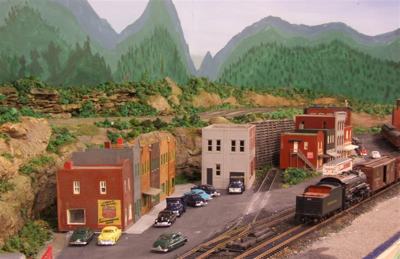

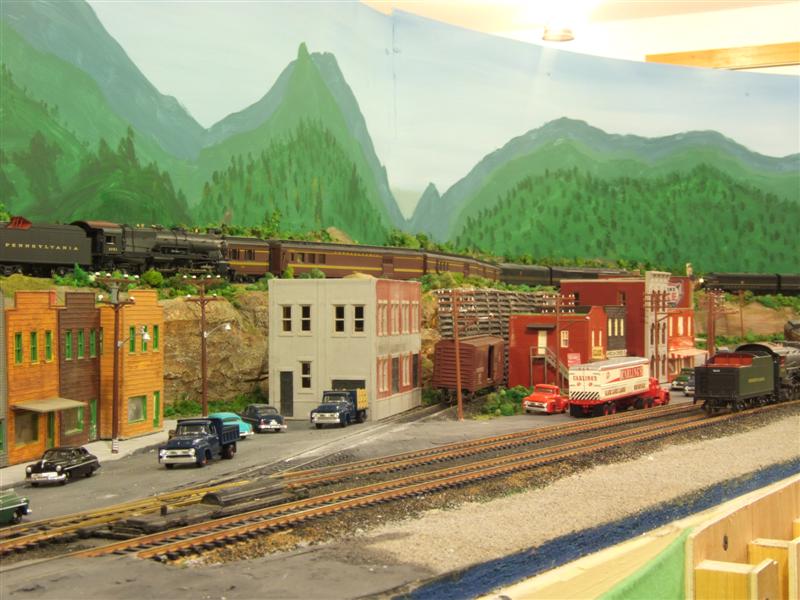

Another rainy day here so plenty of work is done. The glue is dry on the "brush" so I put some paint on some buildings and did some rearranging of structures. Still plenty of detail work to do, signs and poles are really needed. Some of the buildings need some trim paint and touch up, but I have things almost ready to show to folks over the holiday.
Thanks for all of your kind comments. They go a long way.

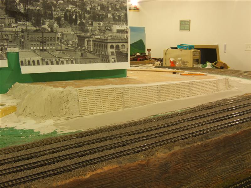

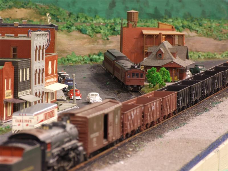

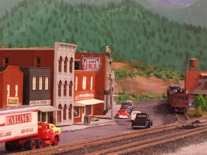

I have been working on the area that will be a small town at the top of the mountain. I haven't named it yet, but hope to be able to represent a small mountain community from the 50's. Not much progress, but it's a start.
The pics in your next to last post of the town are very nice, so I have no doubt the town refered to in your last post while be great also! Thumbsup

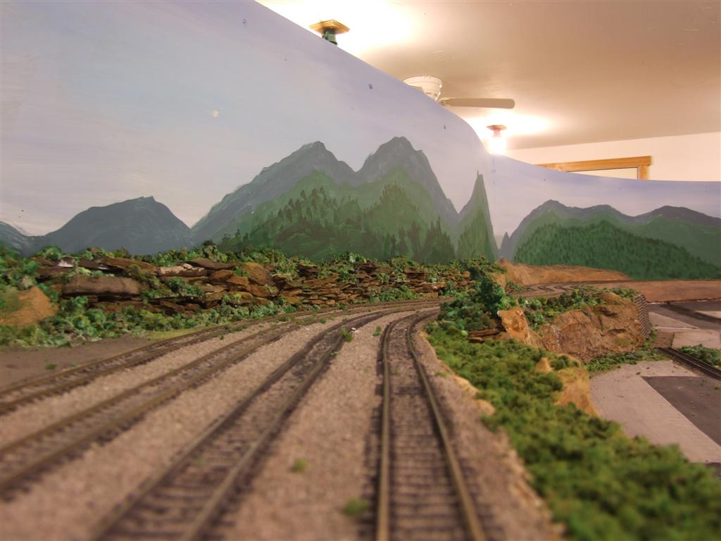

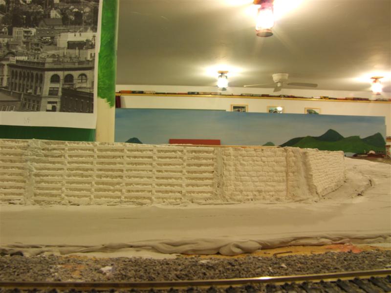

Those are great retaining walls Charlie. Thumbsup
I love seeing the updates on this thread. Charlie, you are building one of my favorite layouts on this forum. That 4-track mainline could be the subject of a song train

Nice work Charlie, your small town got a lot of character. As CN nut said in a previous post, the passenger stub is really a nice addition.

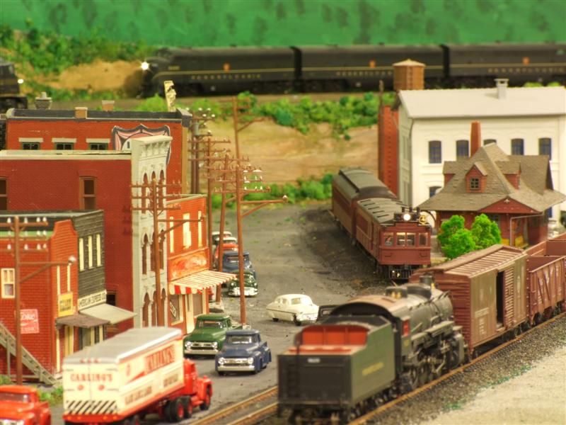

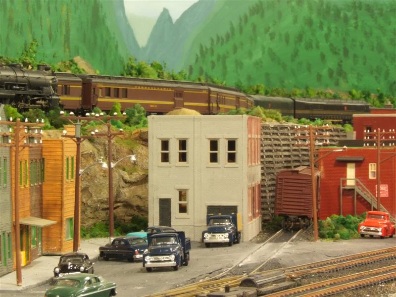

Same town, just a little more clutter. I found a great way to "plant" telephone poles. I have a roll of 16 ga. solid wire so I took the plastic bases off the poles, drilled a hole up the center of the pole about 3/4 of an inch and glued a piece of wire 1 1/2 inches long in the hole.
I left the insulation on the half that sticks out and drilled a 1/16 in hole where the poles had to be. this gives them a little flex so a goofball like me might not break them quite so easy, and if I do they are easy to replace.
Neat idea Charlie! The poles really add to your city scene. Thumbsup
