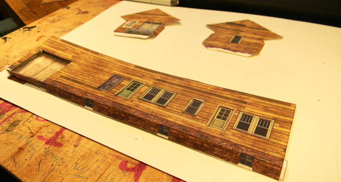

While I was watching baseball last night I mostly finished two of the four sides.  I still need to figure out some rafter supports - I may resort to some plastic there.

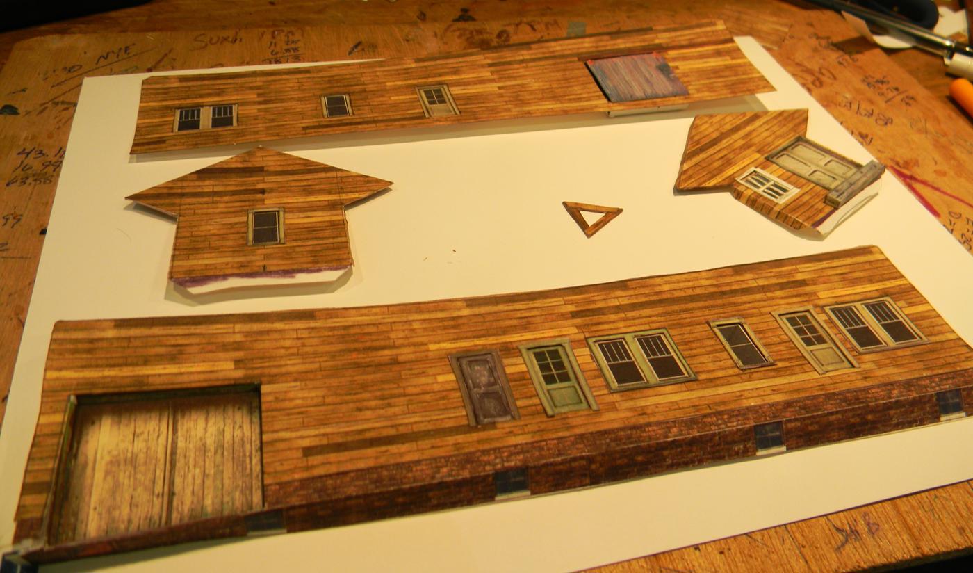

After that frustration, I got back to some building of the White Haven LVRR station.  The four exterior walls have been completed aside from some detail work and foundation adds on three of the sides.  In preparation for the roof, I built one of 32 of the rafter trusses (equilateral triangle-shaped truss in the center of the photo) that will support the extended roofline on each long side of the building.  Each truss is made from six pieces of sliced paper siding glued back to back.  Tedium x 32!
Several loading docks and steps from the doorways will also have to be built, and all of the corners will get corner trim after assembly.  The roof fascia boards on the prototype have scalloped edges.  I don't think I want to drive myself nuts doing that, but I may....

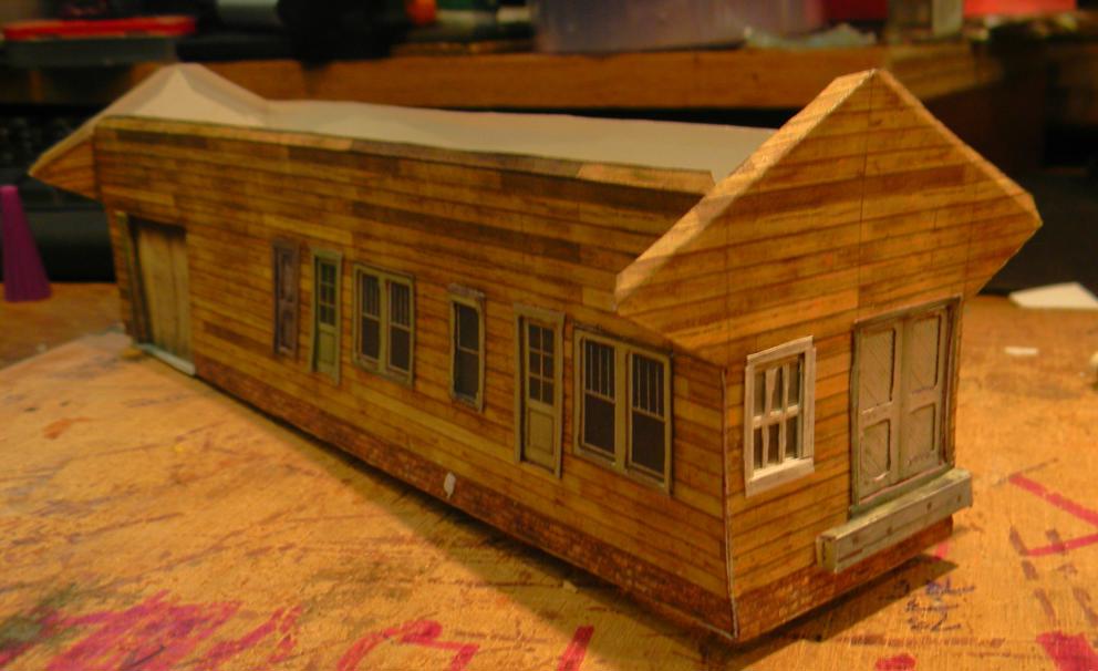

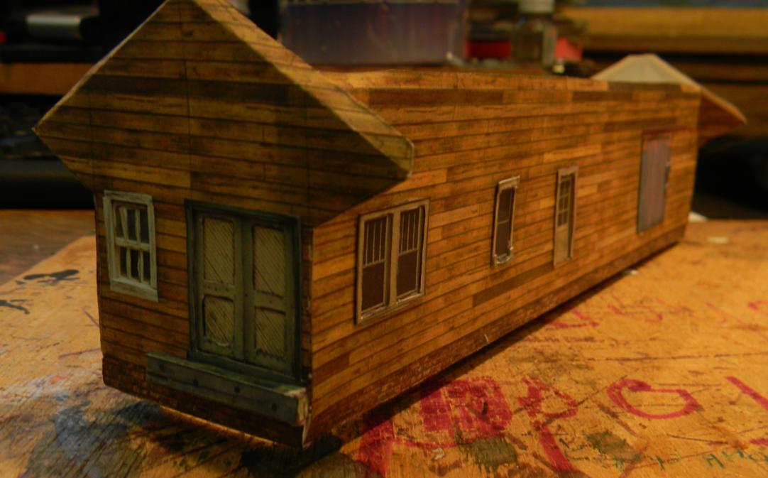

Installed some of the detail trim and joined the four sides together.  Next, I'll be reinforcing the structure internally to take some of the bow out of the middle before making those rafter trusses and installing some corner trim followed by the roof construction.

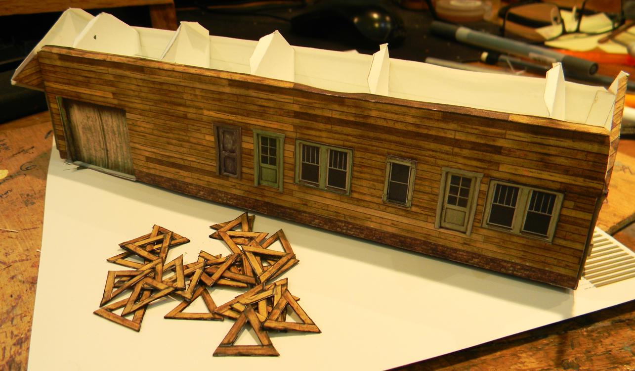

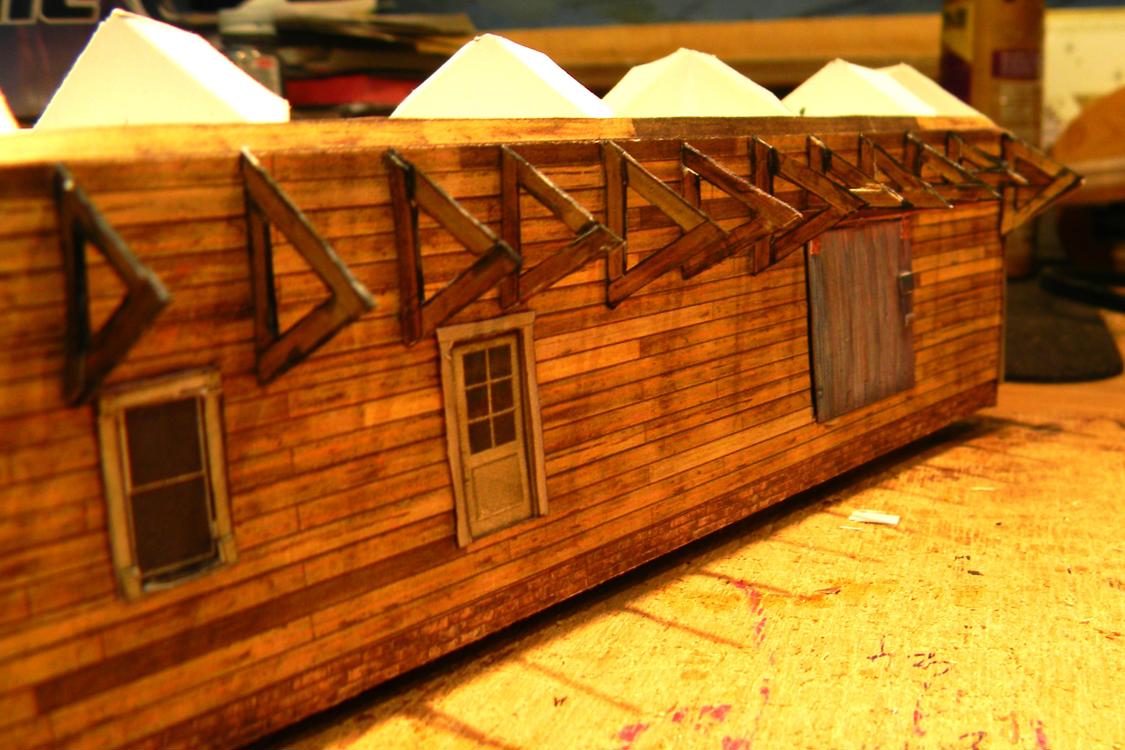

The marathon production of roof trusses is finally finished to include doing all of the edge work on each of these 30 rafter trusses.  Ready for roof construction!  I did put the corner details in and added internal reinforcement at the base and at the ceiling level.  The sporadic roofline supports will give me something to glue the roof to.  I may get to some of that tonight, but the next few days are full with visiting kids and grandkid as well as dear old dad being pulled into a prospective home inspection for my other son.  Things should settle down by Monday night.

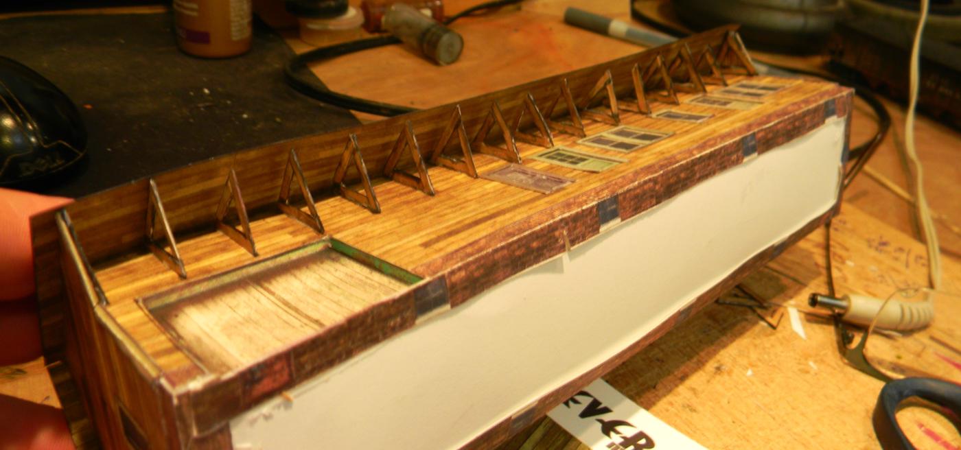

I look forward to seeing those photos, Jim.  Until then, photo progress of my own as I've installed all of the roof truss supports (had to do something a bit different over the sliding barn door due to space limits on the slider.  If I had to do it all over again, I'd have made one single truss in MS Paint and duplicated it 30 times before printing - I could have produced much better uniformity.  However, these will do.

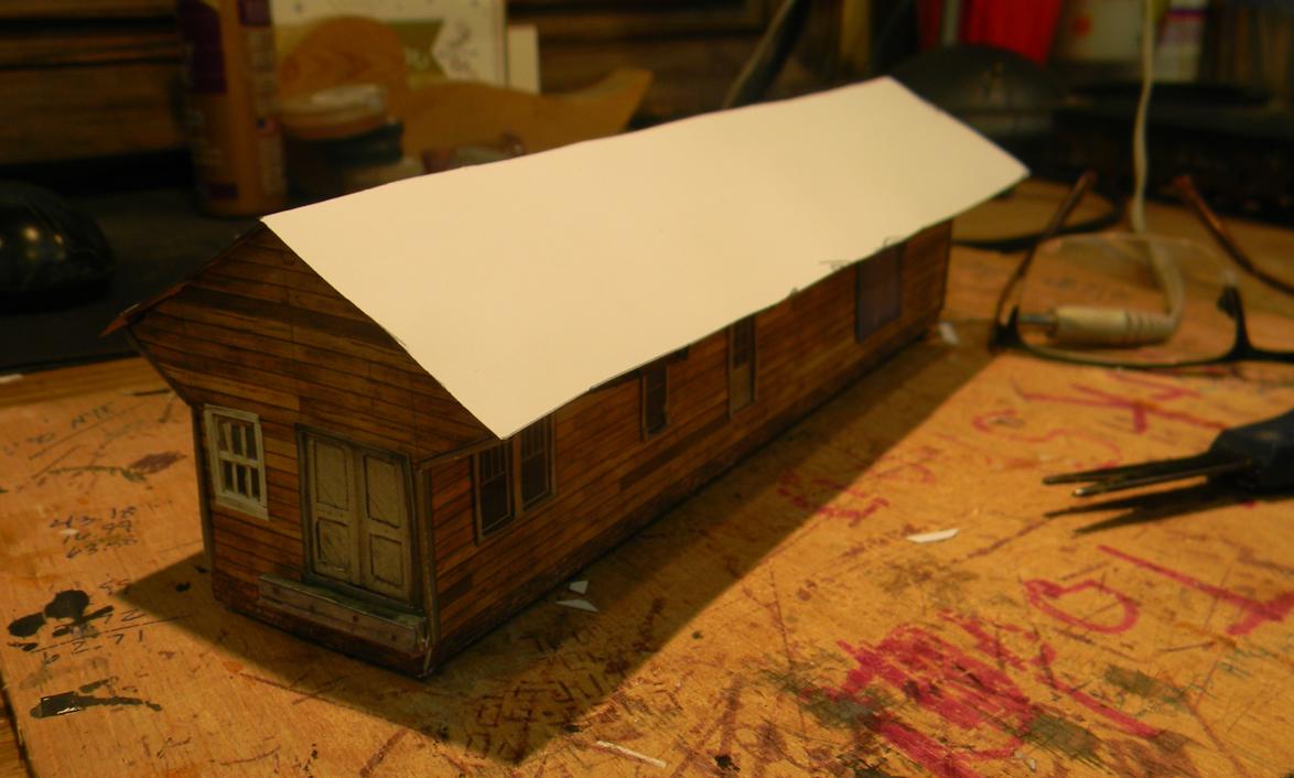

I cut to strips of siding to serve as the underlayment for the roof and glued those in place.
Next comes a complete fascia board around the edge of the roof followed by a "metal" roof to cover all of the white space.  Don't know when I'll get to that...
trusses took great wood and paint don't age at the same rate gives the building a look of age.

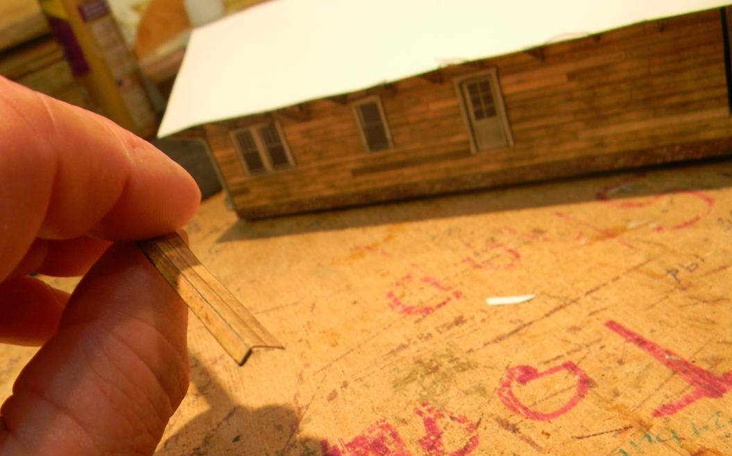

I did get the fascia built (the photo below is folded siding that got glued on top of the underlayment)....

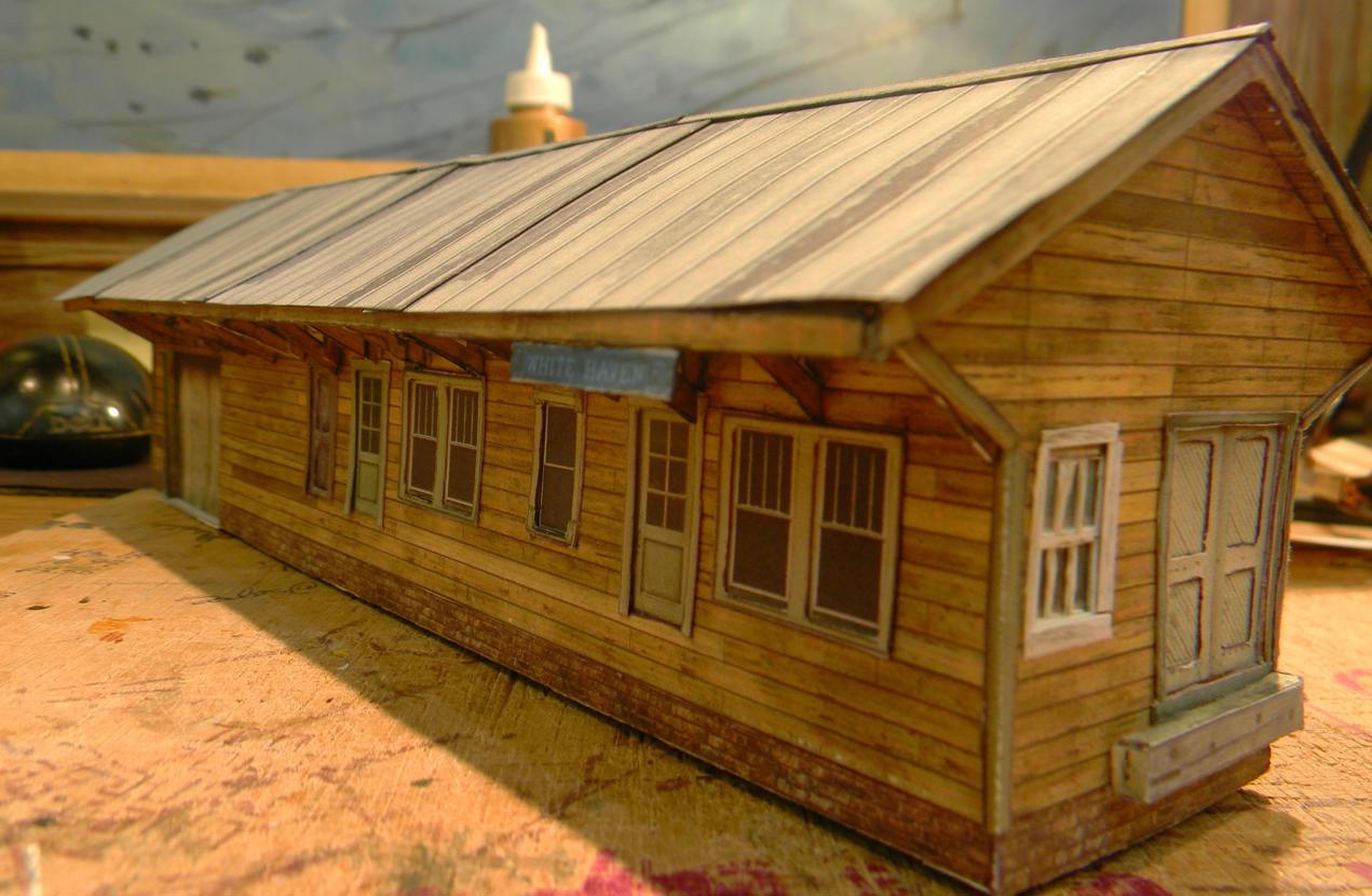

and roof installed this evening along with the White Haven sign pulled off of the same website I got the station photos from.  Next come some loading docks and steps.  All in all, this kitbashed station is going to work well once I get a space to install it.

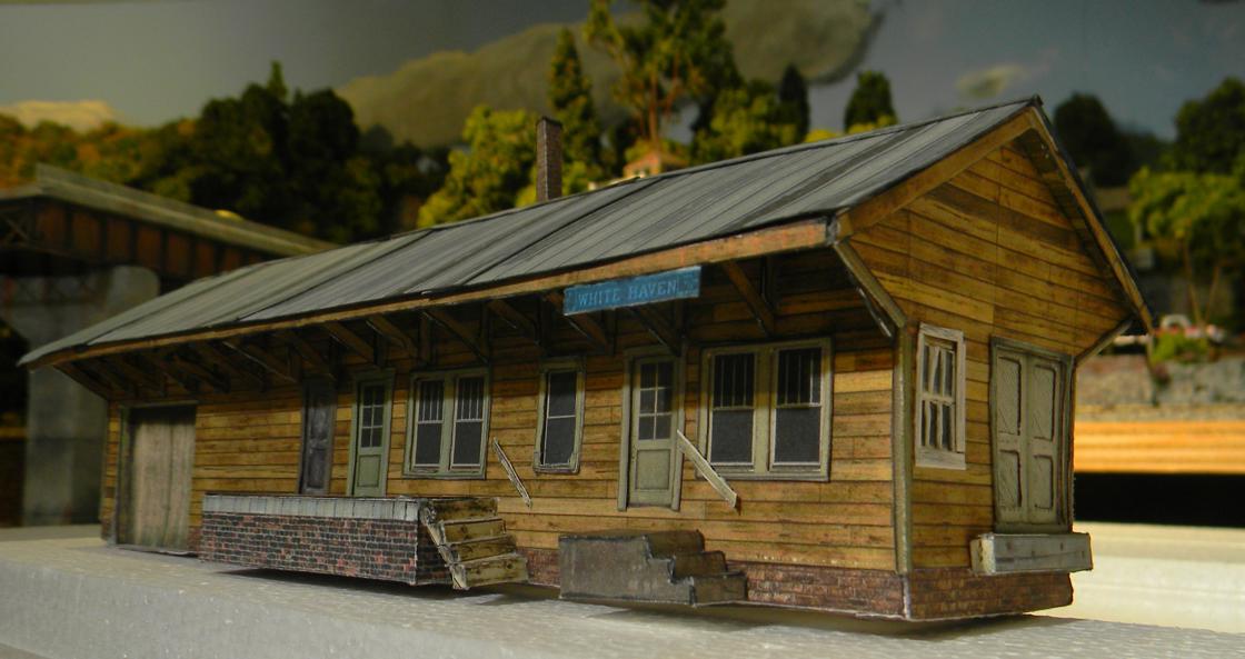

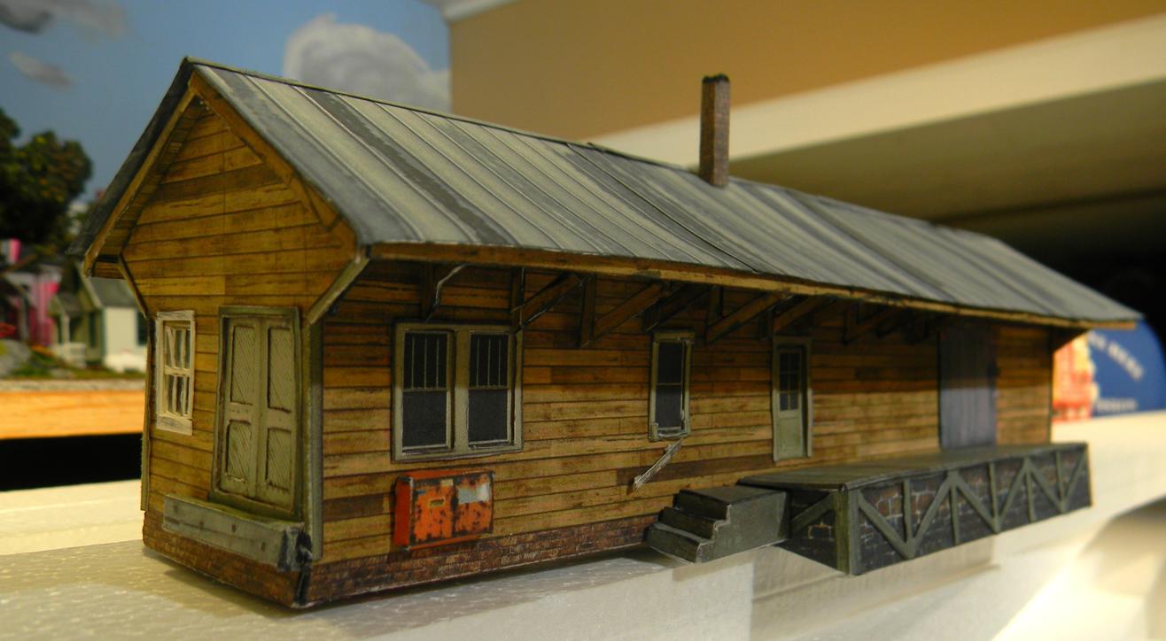

Tonight I installed some steps, handrails and finished installing loading ramps.  I think construction is complete on the LVRR station.  I guess it's time to move on to another structure!
looks great!
