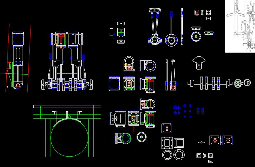

Gerd, thanks for these overview of your Shay. An absolutely fine work!
I'm not sure if you know that I worked as an steam loco repair man (here in Germny I learned this as a profession with certification) and so I know all these parts of a steam loco and I know the construction of steam engines with their valve gears - here a typical Allan gear with two excentrics für each cylinder. This all are many movable parts and these need many work and high precision while manufacturing - all in all a fine job with my highest compliments!

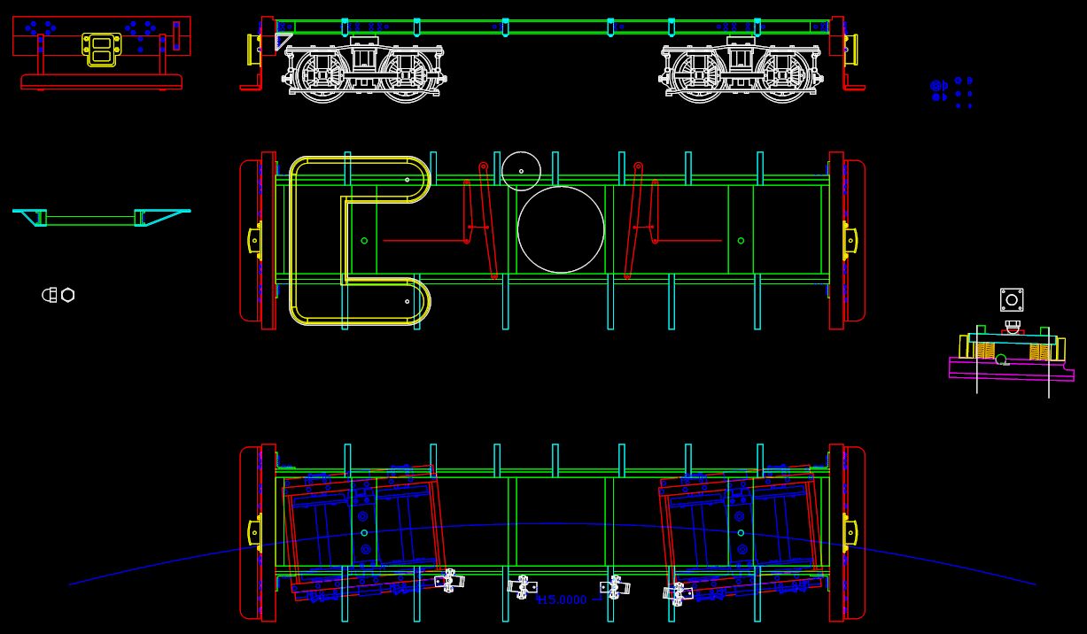

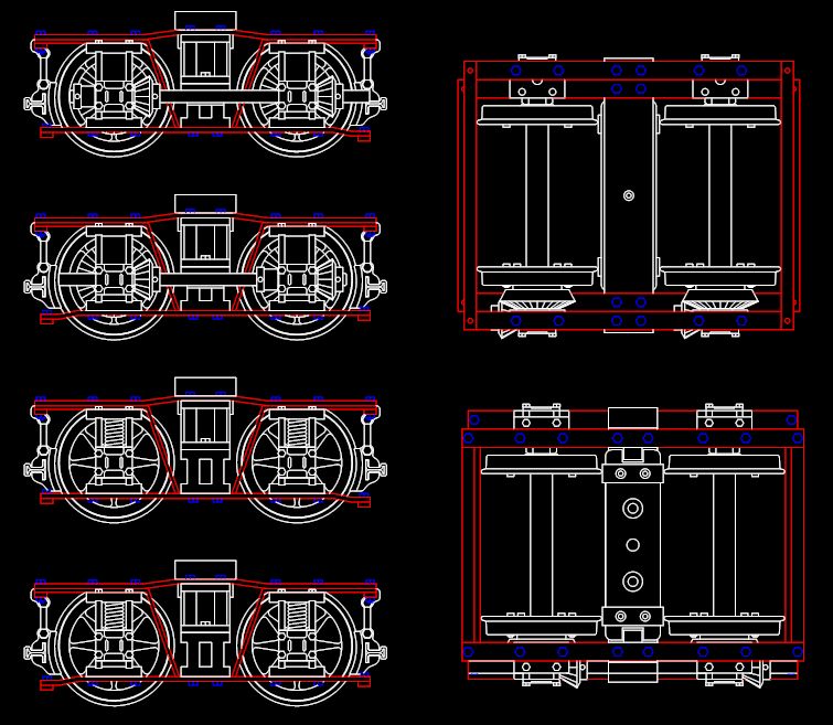

 Your drawings of the shay trucks, answered a few questions that were bothering me.
Thank You!
Now, once I get "out of scenery mode", I can make a few needed repairs, and get my HO shay running again, and, looking better!!!
