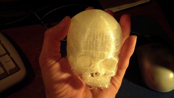

I have to sharpen my drawing skills on the computer before trying to make a buck or two, besides I have to wait and see how the Job situation turns out so I can gauge how much time I can devote to 3D printing, but it is a possibility down the road. All that I have printed are files that came with the included SD card and the downloadable Makerware that converts some rendering file extentions to G code which is what the Makerbot Replicator 2 uses to generate tool path. It took 4 hours and 38min for the skull to print out, whereas the chain took about 15 min. .

Still not sure how much plastic the skull took but here are 2 size comparasions to give a general idea of the size.
I thought I had 2 pics but there is only one.

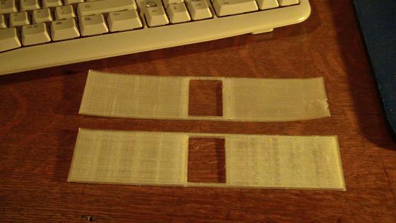

I test printed a basic rectangle with a smaller rectangle hole that is aprox. the size of a 40' box car side in S scale it was half a success as the ends started to curl up and caused a slight jam, I need to clean up the build platform as oil from hands and fingers will cause the plastic not to adhear to the build platform
Getting closer to useable train parts

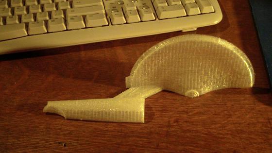

In case sumpter is following this theard I printed half of the enterprise from a file on thingaverse :ugeek:

Are they smooth? Looks like they have a bit of a texture to them. Nice job - looks like you are having fun.
Posts: 1,475
Threads: 44
Yes they have a slight texture, but I think a light sanding job and a coat of paint might fix that, also the spool of PLA plastic that came with the printer is clear so you can see the layers which looks like cross-hatching(an artist's term for a process of creating texture in a drawing).

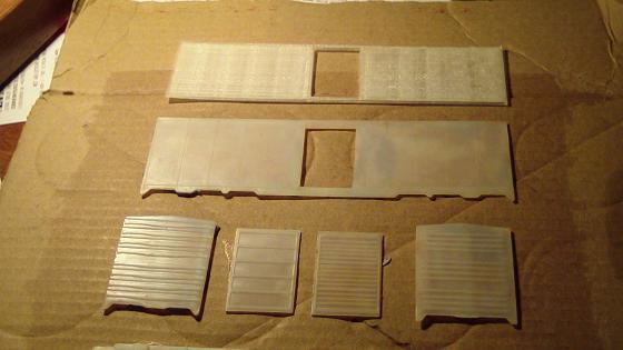

Well the latest on the 3D printer is a few more adjustments and I had a perfect print first time out today, it almost looks like build platform needs tweaked before each print for best results. also the feed of the filament needs to be just right or too much or too little pressure from the plunger will cause the bot to stop extruding. Did a test on the print from today to see how enamel paint reacts to the PLA plastic, will try sanding down the texture as well.
Will have to see what resolution I am printing at that may make a big difference.
Posts: 1,475
Threads: 44
Well the PLA plastic took paint with no negative reactions. Next is to see if it can be smoothed by sanding. Also will have to check the resolution setting. I will not waste anymore plastic until I have a decent box car side drawn up(getting close). Did a test print was a near perfect print....one corner warped at some point in the print as it would not stick to build surface will have to do two things adjust the tension on the feed pully and relevel the build platform.
