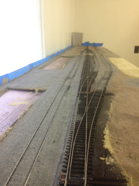

Just a little more progress.
I got the basic ground cover down on the modules and the ballast on the auxiliary track. Next will be static grass and grass tufts. I also need to get the rest of the buildings at least partially assembled so I can get their place on the modules finalized.
[Image: IMG_0803.JPG]
[Image: IMG_0804.JPG]
[Image: IMG_0805.JPG]

That looks very good. How did you do the ballasting of the left hand track? It looks to my like street running done with ballast only and the ballast is very even distributed. Are the rails still a tad higher than the ground cover?
#48
Reinhard,
I was trying to figure out how to achieve this look without creating a giant pain in the a** for myself later. I was looking at a few things as to how to achieve this and I looked around at my available tools. I had been checking the gauge of a few switches using my NMRA gauge and a Micro Engineering track gauge, looking at them I had a moment of inspiration.
I placed the ballast on the track and using my fingers spread out the material as evenly as possible. I then used the NMRA gauge as a regulator using the switch gauge section between the rails, this side has the three prongs on it for checking gauges of switches and frogs. After a few passes over the track less and less ballast was being plowed out of the way. I then flipped the gauge over to the track gauge part and made sure it cleared the track. I also found that this set the track level just slightly higher then the ballast. I then wetted the ballast using a misting spray bottle to keep the ballast from moving, which further settled the ballast below the track level. This was then secured with a 50:50 mix of white glue and water. I ran a couple of cars over the track today and have a few spots I need to dig out with a dental pick, but it is very minimal.
