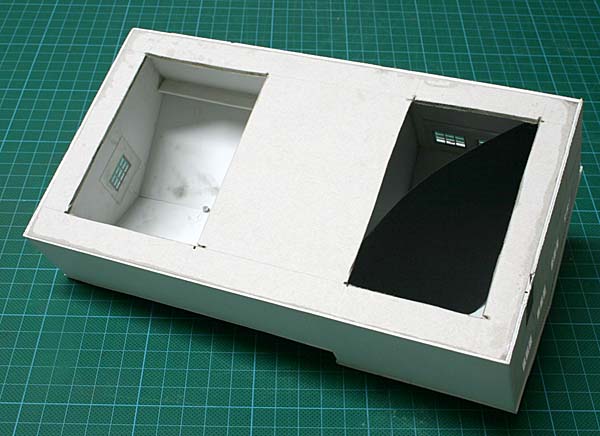

I do brace my styrene models with styrene strips just the way you mentioned and I will brace the bottom of the walls of my ugly duckling when everything else is finished. I don’t want to get the braces in my way while detailing the structure. Until then, the 1/8" cardboard roof will keep the walls in shape and with the structure being only about 8" x 7", the roof is definitely strong enough to prevent sagging. When I built Sentry Industries, which is about 2" long, I used another method for the first time. Before I started to build it, I had made a mock-up from .080" cardboard. The dimensions of the mock-up were about right, so I decided to build my styrene structure around it. I only added a second layer of 1/8" cardboard to the roof to gain some height. The roof is absolutely bullet proof now Goldth. To glue the styrene walls one by one to the cardboard mock-up made building the structure a lot easier (especially the curved rear) and resulted in a very sturdy model. Here is a shot of the interior of Sentry.

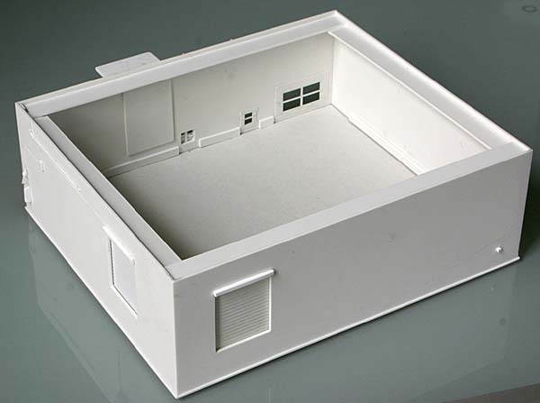

Wayne, I did not mention bracing explicitly when I built Sentry and with the structure I am currently building, I planned to do the bracing as one of the last steps. So you could easily get the notion I was neglecting it. Anyway, though it sometimes may look like I knew what I am doing, I am far from making no mistakes, so I really appreciate your help. When you posted your reply, I was still trying to decide how to brace my building. On one of my former projects I used cardboard, which worked very well.
[Image: m65.jpg]
But now that you mentioned styrene strips, it is settled that I use them Big Grin .

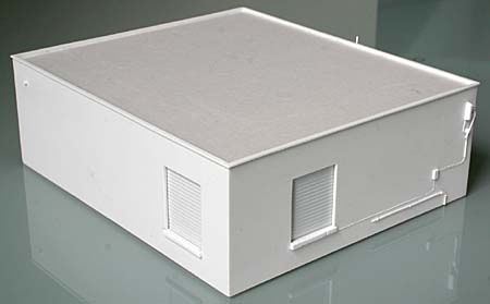

After sanding the walls, the joints will no longer be visible once the structure will have been painted. I use a sanding block or wrap my sanding paper around a piece of wood when I sand the walls to avoid rounding the corners. After sanding the walls I could apply the last details, only an air conditioner is still to be put on the wall with the rolling door, but I will do that after painting the structure, and painting will have to wait until the weather ...etc., etc.
So here are some pictures of the finished structure.
[Image: m66.jpg]
I did not apply any details to the rear wall, as it will face to the rear of the layout (what a coincidence Goldth), I only built in a rolling door to justify rail service.

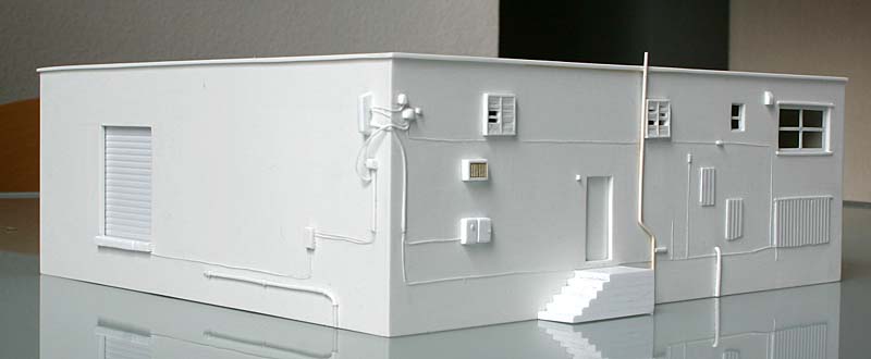

[Image: m67.jpg]
I hope we do not have an electrician on this forum, he will go crazy when looking at the wiring on the corner of my building. For what I could see in the blurry picture of Google street view, it looked very much like a spaghetti bowl to me, impossible to unravel. So I did some creative wiring .....

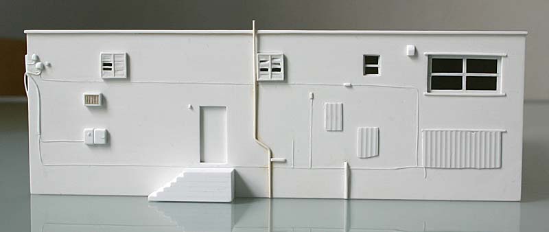

[Image: m68.jpg]
The last picture shows the front side of my structure (which is the left side of the prototype) exactly as you can see it in the prototype pic in the first post of my step-by-step. I did not get it 100% right, but I think I got close enough.
[Image: m69.jpg]
