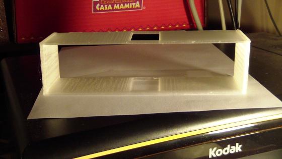

Why print a box car side and not a whole box car? Does the plastic glue well?
#62
Funny you should ask that Icon_lol
Question #1--- Was thinking about that a few min. ago, It could be done and might solve most of the texture problem in the highest resolution setting, the reasoning behind the car sides was that there are more than one type of car end out there. Next experimental print a complete car body less roof and floor(have to have some kind of assembly Icon_lol )
Question #2--- Have not used any glue yet but will post results later

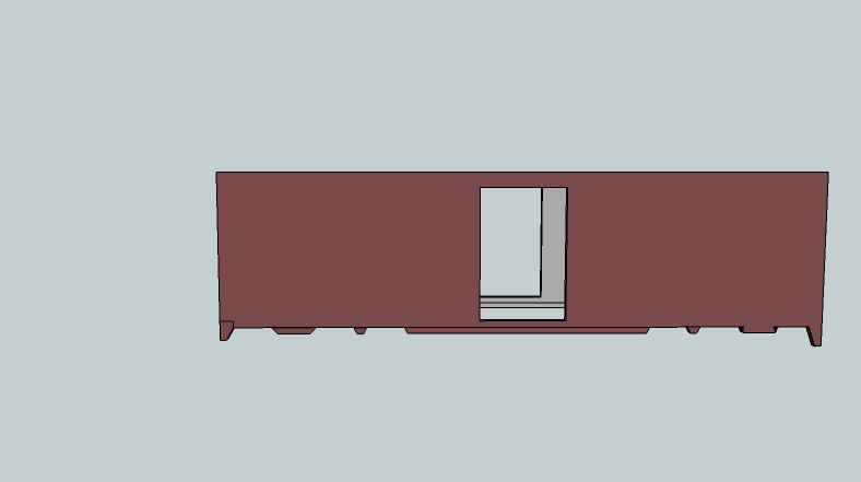

Here is a 2D(jpg) pic of the carbody that I will try next on the printer

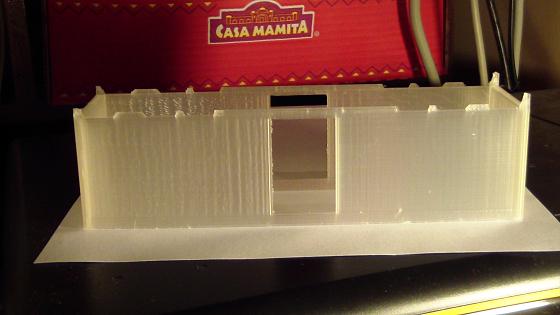

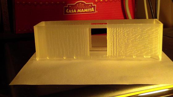

Well 3 trys and 3 fails to print out a box car body 35 The MakerBot support team is looking into the file to see if it is the file that is causing so much trouble as the test files that come with the printer print out fine but my design(s) are 50/50 at best , the texture with the side only was due to middle res setting, the weave pattern is much tighter and less noticable at the high res setting, the scoup on paint is that they suggest a coat of gray primer and then any kind paint you like. As for glue for most purposes crazy glue is fine. Maybe by this time tomorrow I will know if it is my drawing skills(or the lack there of). Untill I know where I went wrong will not waste anymore plastic Nope on a boxcar body but might reslice the boxcar side file at the high res setting.

Hello all it took 6 hours and 20 some min. to print out the first successfull aprox s scale botted boxcar 2285_ 2285_ 2285_
Here are some pics of the body of the box car still need to design the roof and chassies.

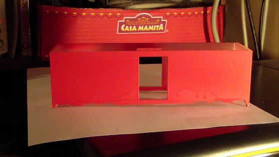

This is looking really interesting. The real test of the `finish' is how it looks with a coat of paint. Any chance of spraying one side and end of the box car body primer grey, and the other side and end box car red?

I will paint it with primer but I am out of oxide red/brown paint. It was printed at the highest resolution but is pretty much smooth and lacks the panel and rivet details (will add these to the next revision) as this was a concept test, the more details the longer it takes to print 24 but I have the confidence that I can print up a few boxcars with little to no problems now. 2285_

This machine realy impressed me once I ironed out some design snags in the sketchup file, I draw the part in sketch up first then export the file to a .dae file which I import into Blender where I again export as an .STL file for use by the MakerBot software called Maker Ware, sounds complicated but is not that bad once you have done it a few times.
here is a pic of the carbody with one thin coat of testor's flat red from a rattle can. Judge for yourself, personaly I would give it at least 2 coats. Did not use any grey primer this is paint on the raw plastic.
