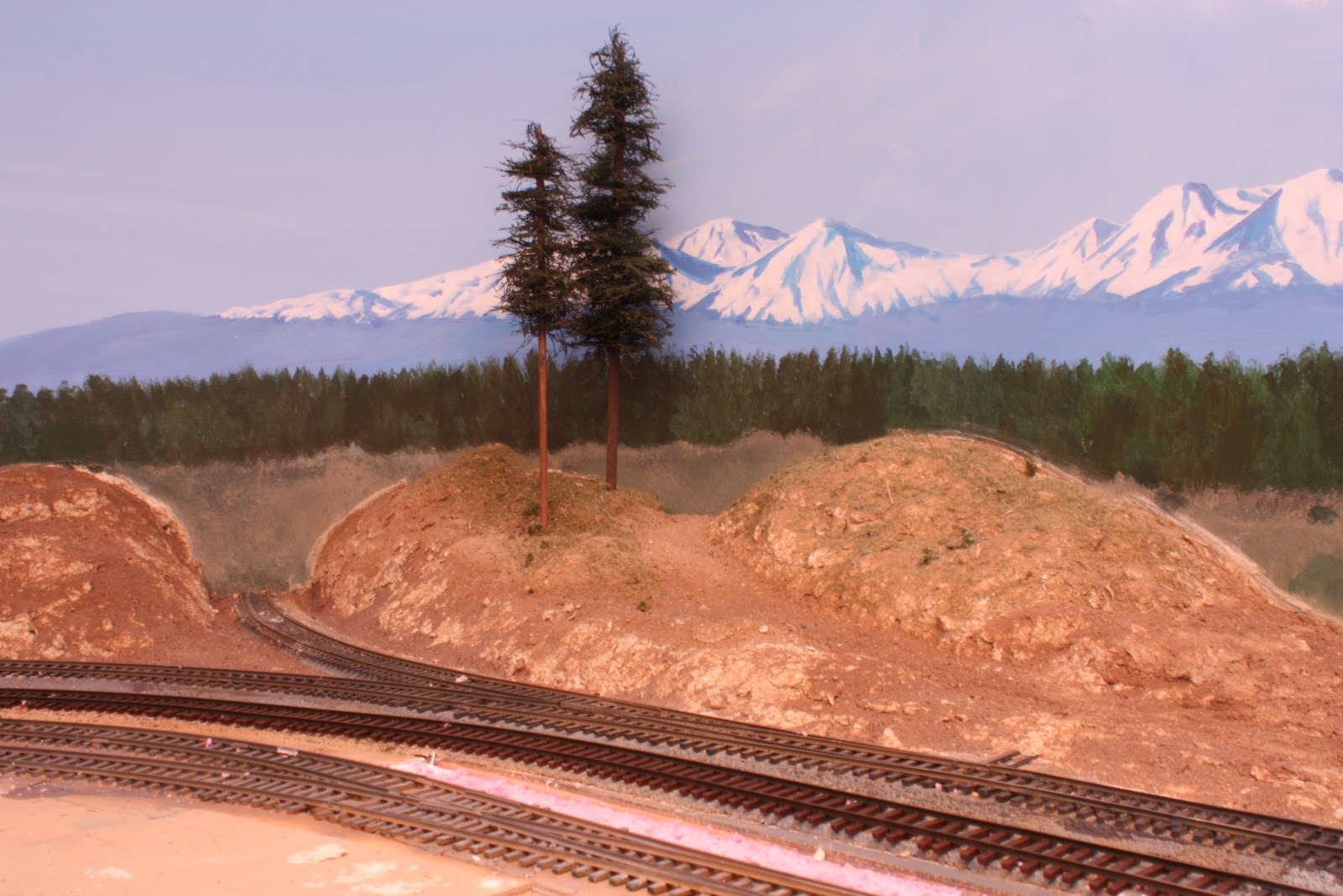

Well guys I have to admit I cheated....All these trees are commercial models.
I have been working on how to model pine trees using some stuff I found at HobbyLobby, if it works out I will let you know.
Here is an update to my little scene.

Looking really good there! I like the theme, the colors, the backdrop, the trackplan (I've only got a small space myself so I like seeing small layouts for inspiration etc.). Keep it going :-) And I've signed up as a friend to your blog too (I'm TJ)
#78
Beautifully done Greg. Every time I see your scenes I'm reminded of my trip on the Empire Builder to Portland a couple of years ago. Mt. Hood looked just like your mountains. Thumbsup

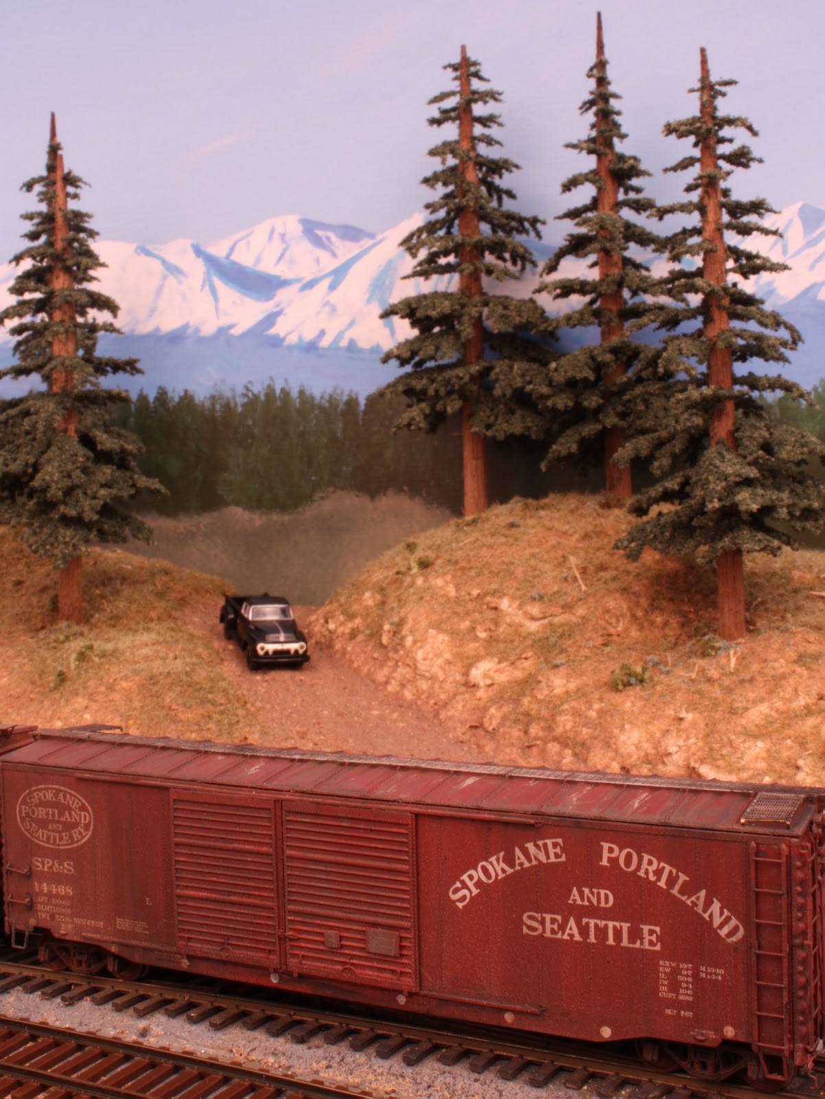

Thanks guys for the comments I am pretty happy with the way this little scene is coming out. I affixed the seperate scene to the benchwork and added a new piece of scenery on the other side to complete the cut. I started on making a few trees using furnace filter and dowels, they are still a little rough and need some tree trimming. I think they are heading in the right direction, just not quite to the level I want them to be.

I missed your photo earlier today. Wow, that turned out good. The transition from layout to backdrop worked out very nicely. The road looks good, along with the truck, and there is my favorite boxcar in the foreground. The ground cover under the trees looks natural. And last but not least, the painted mountains in the background finish the scene.
Thumbsup
I've really been "stressing" over how I am going to blend my backdrop into my shelves. For that matter, been wondering if I can paint them or what. You sure did great with yours.

The transition between background and foreground continues...
[Image: IMG_0393.JPG]
A close up
[Image: IMG_0392.JPG]

excellent job on the painted trees, and their color match with the scenery in front of it, it gels together, you sure you're not secretly a painter or went to art school or something? :-)
#86
That looks fantastic Greg. How exactly did you make the trees? They look really good. Thumbsup
#87
Reinhard: Thank you for the great comment, maybe I should hang pine airfresheners from under the layout, I bet that would really get people to wonder...
Torikoos: I took a few art classes in High School and maybe a painting class but I think all we ever painted was fruit... Wink
Tetters: The trees are made from simple and cheap material. I think if I make another 100 or so I will get the hang of what exactly I need to do to make them look "right" I have found thatm like most modeling, scenery is not defined but what components you use but in the way your artfully belnd them together...or fail to blend them together. I still have a little bit of work to do on the backdrop trees before I am 100% satisfied with their look but I think the color and texture are correct. I will post a quick tutorial if you want but it is pretty basic.
