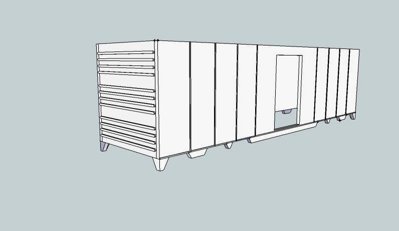

Rev.2 of box car is almost completly drawn(the body anyways) with panel lines now to study the pan head rivet engineering chart I downloaded and add the end details.
A question about shapeways, I assume they have a much better resolution on thier machines than my MakerBot has? I ask because what looks good on the screen some times does not translate well into a 3D print.

Here is a progress pic of the box car redesign so far.

AF350 Wrote:A question about shapeways, I assume they have a much better resolution on thier machines than my MakerBot has? I ask because what looks good on the screen some times does not translate well into a 3D print.
It isn't just resolution, but also the rigidity of the printer structure, the calibration/alignment of the printer, etc. The resolution is better too. Essentially, what features do you give up in reducing the cost of a machine from $25,000 down to $2,500? For some modeling applications, your Makerbot is just fine, but for others, I don't think you'll be able to get as good of results as can be obtained with commercial printers. As your feel for what it can do and how best to draw objects, you'll see it translate better into prints.

$48.00 per 1Kg spool PLA plastic, will have to weigh a printed boxcar body to find the cost of material.
I am finding sneaky ways around the freebie Sketchup limitations, can not make a circle small enough to be a rivet so I hand draw a hex head which looks like a dot when zoomed out to close to actual size of model 24 maybe there is another way that I have not discovered yet.
It will print out on the MakerBot so maybe there is a good chance it will work with shapeways set up?

$48 per KG is quite a bit more expensive than resin, so I'd suggest combining the two since I know you've cast cars before.
I draw everything in 1:1 scale, and then reduce it for printing. This eliminates the minimum circle threshold as you can have small circles in Sketchup, you just can't draw them. Similarly, cutting truck springs off flat is usually much easier at 4:1 or even 10:1 scale. Sketchup is a perfectly capable engine for doing most of what you could want, it is just a matter of learning how to do it.
