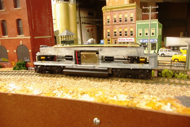

Here's a shot of the chassis of the latest-version Bachmann GP50:
Reinhard says his last-but-one (presumably) has two small flywheels -- I certainly wish they'd stayed with what they had!

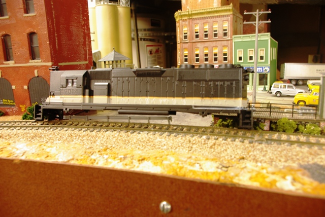

I got as far as removing the lettering and number from my body with some kind of paint remover for plastics, don't remember what was exactly in the jar. This wasn't simple, and it took off some layers of paint as well, so I masked off the light gray tuxedo and resprayed the rest.
Not a perfect job, but I'll fix it with weathering later.
OK, there are lots of problems with the Bachmann model, leaving aside the lack of flywheels on the current run: engineers side (long hood forward) dynamic brake not correct. Fans not correct, the radiator fans should be Q-fans. If the LHS had had those in stock, I would have replaced them, but no luck there. Trucks should be the late dash-2 Blombergs, but these are the older Blomberg-B. Fuel tank too big for SOU GP50. This is a 3-foot, layout quality model. If Athearn RTR had brought out a high hood GP50 in the $100 range, there would be no contest, but they haven't, and we can probably kiss $100 models good-bye for now anyhow. So a $30 SOU high-hood GP50 with some work needed -- I dunno, you decide.

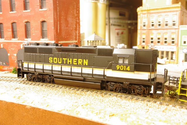

Oops, I slipped east again..... but I could not resist 48 hours delivery to Germany and the special price at Trainworld
SOU decals are on order but that will take some time. In the meantime I borrowed some NYC numbers for the number boards and some CSX YN3 numbers for the cab sides. I am not optimistic if I will try to remove the large "southern" letters from the long hood. The damage might exceed the advantage.
However, all four engines are smooth runners.
The horns (both sides) and bells (long hood) are on most but not all photos black as the engine itself. I think I should follow the majority and paint them black too.
I did not do the white stripes at the ends because that would have delayed the installation of snow plow and the MU cables until the decls arrive.
ps. Don't be confused, I am working on a SoCal layout and have no intention to change that!
pps. The price is so low that the German customs at Leipzig airport (port of arrival for DHL express) used to Maerklin prices put the parcel on hold and requested a proof of payment on Saturday morning. They considered the invoice a fake :o

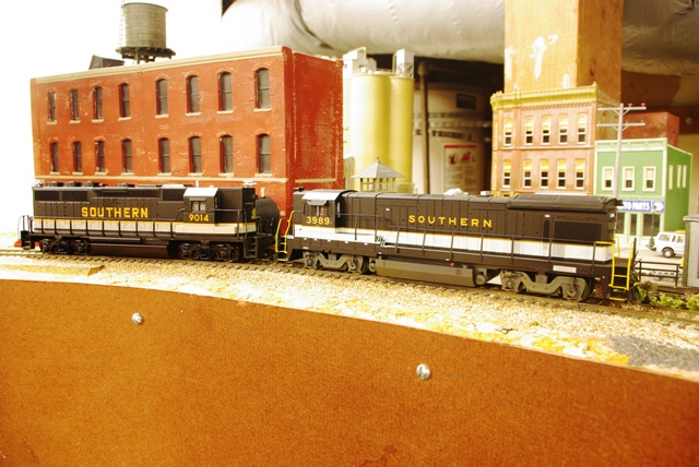

Some time later....
Ok, southern lady, no more pose. Get the job done
