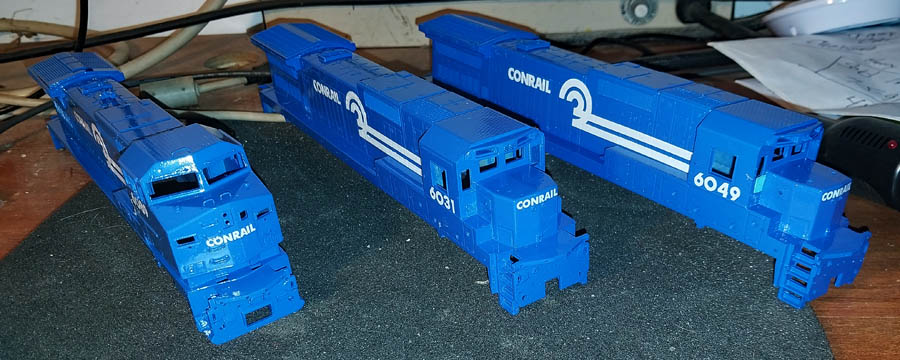

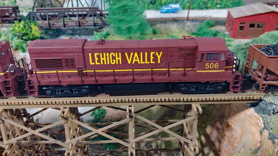

I finished the U23B's tonight. Not perfect but I am OK with them.

Great!!!!
As long as you are satisfied, that's all that matters!!
They look perfect from here...
Posts: 1,405
Threads: 153
love the u boats my second favorite diesel.

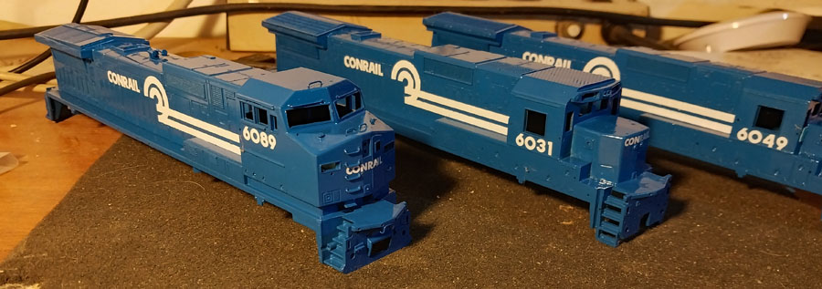

Yesterday I did something I never do....I read directions on a bottle of Badger air brush paint. I had 3 undecorated locomotives to paint and I took a lot of time washing the bodies so there would be nothing to make flaws in the finished product. I sprayed the bodies with my airbrush and when I was finished they looked great. Tonight after 24 hours of dry time I went out to look at them and the paint was flaking off in some places on all 3 bodies,
I have painted at least 125 locomotives and over 200 freight cars and never had this happen, I also have never used Badger airbrush paint (especially made for model railroad items) so I have concluded this will be the last time I use this product. Now I can look forward to a couple hours clean up before repainting with another brand of paint and most likely it will be Rustoleum. I have had very good results using this and a half pint is just a little more in cost than a 1 oz bottle of model paint, and it is simple to get a close color match.

According to the directions no primer needed although one was primed and it didn't make a difference. Everything has to be environmentally friendly in todays world but the folks making the rules don't look at the whole scenario. I have spent 5 hours today cleaning these so I can repaint them. I used alcohol and brake fluid and I will have to use a toothpick and a straight pin to clean some of the details. Never once did I have a problem with Scale Coat or Floquil paints but they were solvent based and you had to be careful of the fumes. Comparing painting a 1/87 to the full size job the fumes are nothing.  I probably painted well over 300 automobiles and trucks (full size) and 3 locomotives and one tender.

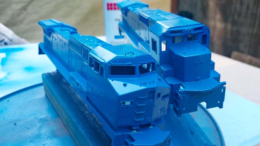

I got the bodies cleaned up yesterday and the paint has been applied. I compared the Conrail Historical Society paint chip to the Rustoleum sail blue gloss. Close enough because the paint faded to many blue shades over the years.
I just applied it out of the spray can. Paint seems to keep better in spray cans. This cost was 6.95 from Walmart and I even got free delivery. It will take longer to dry before I can apply decals but I am in no hurry. My roster consists of PRR/ Penn Central/Conrail/Norfolk Southern and all of the roads that made up these class ones.

The rustoleum came out great!

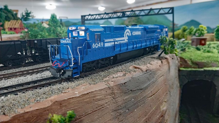

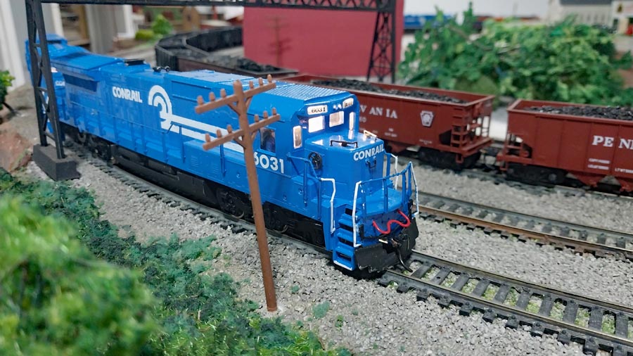

Well, I finally got some time so I got some decals applied. I will need to add grabs on the two C40-8s and of course all the other details. I also have to install decoders but though they have to be hard wired I don't find them too hard to do.

Looks great!!! Funny how that spray paint matches the prototype color.

Just like they came out fresh from the paint booth in Altooner! Love 'em Charlie.

Most of the decals are on as well as the details on the Conrail C40-8s The second decoder install was a breeze.
