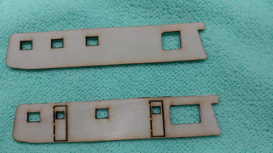

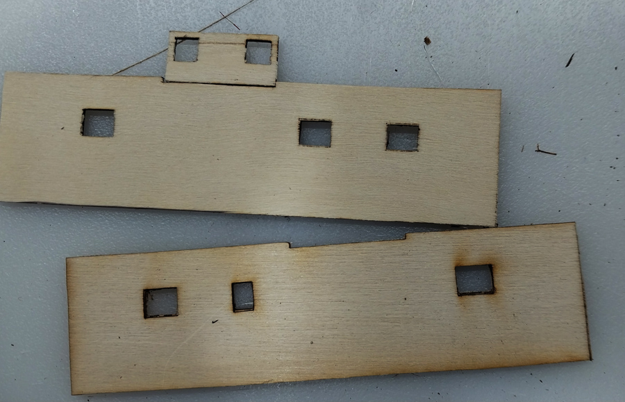

I took the time last night to punch out a couple parts and did a glue test with the UV epoxy. It works well
I did do a little cutting with my exacto knife to make sure they came clean and still managed to rip a little of the outer layer in one place that will have to be fixed. It's called learning the hard way.

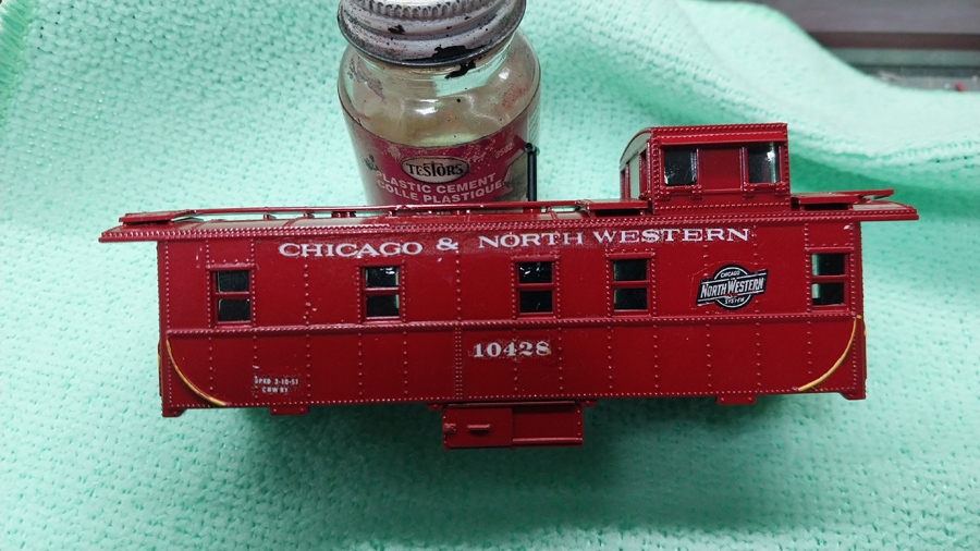

I also finished the stripes on the other cruiser and installed glazing in the CNW caboose.

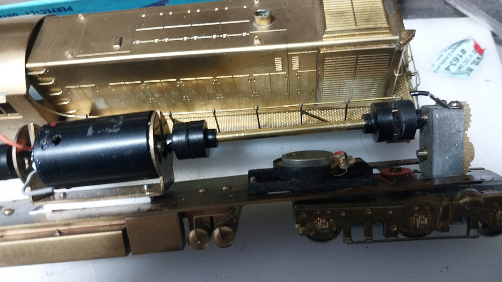

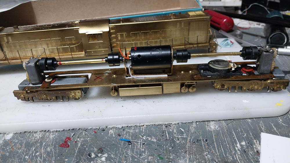

     I am sorry but I am just not taking many photos of my work in progress. A lot of things I used to do easily I struggle with now and don't even think about a photo until it is too late.  I took a few when I started this decoder install but didn't keep at it like I should have. I found time to finish a sound decoder install on a brass BP20 from Alco products. A used ebay purchase.  The powered unit had had a NWSL motor installed so it was fairly easy to isolate the motor.  I drilled holes under the rear drive shaft and installed the speaker there. I built a platform over the driveshaft so I could put the decoder and current keeper away from the moving parts. I held them in place with UV epoxy and used some of the same to hold the wires away from the shafts.  I used a 3mm warm white LED with a 1000 ohm resistor for the headlight. I used the epoxy to hold it in too. The stuff is great because it is hands free in about 10 seconds with the UV light and cures hard in a minute or less.
     The rear drive shaft universal to the flywheel was the wrong one but I hat the right one in my spare parts as well as the proper universal joint so I fixed that and gave the gears and bearings oil and grease where needed.
     The current keeper just plugs into the decoder and the locomotive will run at least 10 seconds after the power is turned off so it does not have a problem picking up juice.
     Here are a couple quick photos.

An "Alco" brass production! I recognize the gear towers. Makes me think about my brass RS2 that I gave up on and made into a dummy. Someday I may try making that one work again. Love the sharks, Charlie!

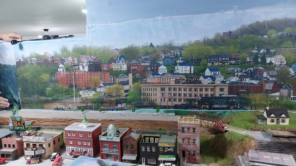

     I was looking for some reasonably priced backdrops for my layout but I just couldn't find anything that I thought was affordable for what I need. I thought about printing my own but they would have to have been printed on letter size paper and stitched together and the ink is not waterproof so they would have to be coated with dull coat so they could be put up.
     My friend (railcop) bought some that were about 18 x 48 and he had a heck of a time gluing them up and they were paper.
 Now, my wife has been buying a waterproof cloth shower curtain of various designs for less than 10 bucks for a 6x6 foot curtain. It came to me that perhaps you could have custom shower curtains made so I did a search and I found a seller on TEMU that offered them for around 10 bucks each. The wheels started spinning and I thought that with a little work in photo shop I could make my own backdrops and have them printed on waterproof shower curtain cloth.
     Last week I made one and ordered it from the company. This is what I ordered and it was around 12 bucks with shipping and sales tax
     I rushed it just to see what they could do.  It came today, beautiful job and will work great but I did not scale it right, it is too big. Not a loss though because my youngest son models "O" scale. He will be happy to have 18 foot of backdrop.
     Tonight I worked on 4 more and I hope I got the scale right.  I played with a picture and used one of my pictures I had taken and merged it into this shot, just a quick and dirty photo edit to see if I could make one work.
     I was pleased with what I got so that photo is one included in the order I sent today. I ordered 4 "curtains" and if all goes well I should have 16 6 foot x 18 inch high backdrops for $48.72 and shipping was free. . I used the same photos by flipping them horizontally and they will be on different sides of the layout so it should not be noticeable.
     Here are the ones ordered and they will be here before the 10th or I get 5 bucks back.

Where was that idea when I was stitching Hazleton together from inkjet-printed letter-sized prints about two years ago? Awesome idea, Charlie!
I'm also looking forward to seeing those in place...

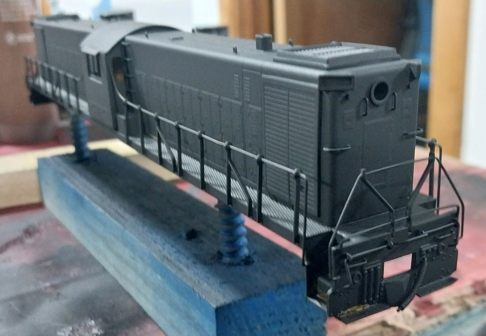

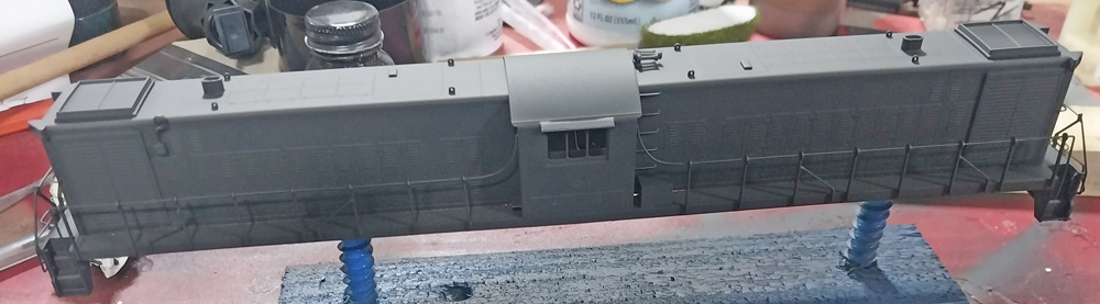

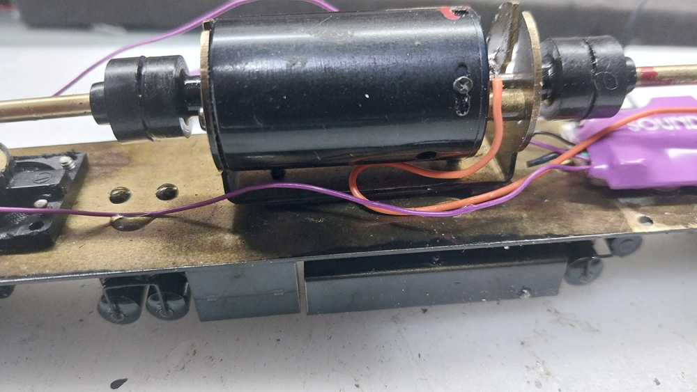

      I have been working on the NJ brass RT624. I have got a can motor installed and the drive shafts I had were too short but I had some brass tubing that would work by drilling out the center holes in the universal joints a tiny bit so I cut two to the proper length.
      I also placed the speaker under the shaft in the rear. I had to shave the side of the speaker a tiny  bit so the shell would fit. I am going to install a TSU2200 sound decoder (for Baldwin). I already installed 2 of these with current keepers in 2 passenger sharks and the sound is incredible, even having the correct A200 Leslie honker horn that the PRR used. Not a pretty sounding horn, but I remember them from my childhood living along the tracks from 1953 until 1959. Fitting the current keeper is going to be a problem but if the one from Soundtrax won't fit I can build my own and spread the components into some nooks and crannies. The current keepers really keep them running smooth.
     Before I quit tonight I painted the under body and trucks black and the shell got a coat of Brunswick Green. I may have enough Floquil left for one more locomotive. I bought 5 bottles 40 years ago and they have served well. No pictures of the paintwork because I didn't take my phone to the shed with me. I will post some tomorrow.

The paint has dried and the decoder is installed and tested with the exception of the lights. There is only the front and rear light that I will be installing. I got the LEDs wired to the resistor and tested them and now I will have to put them in the body and make room for the current keeper. I think there is room over top of the front end drive shaft.
     I have been using the UV activated epoxy to keep wires out of the way and I have used it to secure a few decoders. It works well but the drawback i it has to have UV light to cure it so if you can't get the light on the glue it won't cure. It cures clear but I would not use it where a joint is visible.

Definitely Brunswick Green - lookin' good! I've been using clear silicone for securing wires - downside is that it takes a while to set up. Upside is that you can remove the wires and pull off the extra silicone in case you need to mod. I've also seen people use small pieces of plastic tape.

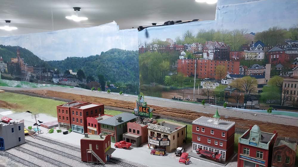

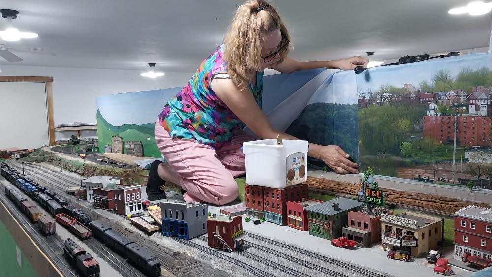

My daughter had some time tonight so we (she) put 2 sections of the backdrop curtains up. We used Elmer's white glue and they were very easy to apply. You cn see why I needed someone light weight to do the application. I will use the ones that are reasonably close in proportion but I will need to have more made now I have a better Idea what I am doing. I think 3 to a curtain will work better. That still gives me 17 foot of backdrop for 10 bucks.
