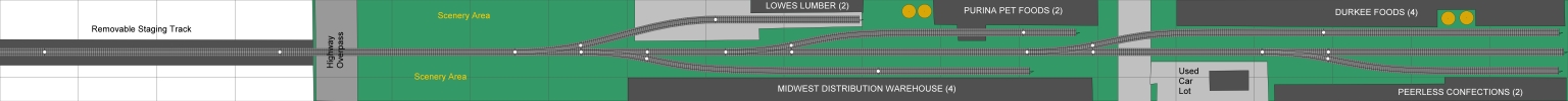

As I had mentioned in a previous posting (27 Dec 2010), this looks like it's going to be my final track plan arrangement. After a lot of experimenting with various track arrangements, I really can't come up with anything that suits me better and having temporarily put the track down and operated the layout many times, must say that I'm quite pleased with the plan.
The plan is designed to fit a 16 inch deep by 16 foot long shelf, with a 4 or 6 foot removable staging track (4 foot on this drawing). All turnouts are No. 8 (or the Peco equivalent to a No. 8) which give a more prototype look and smoother flow of the track.

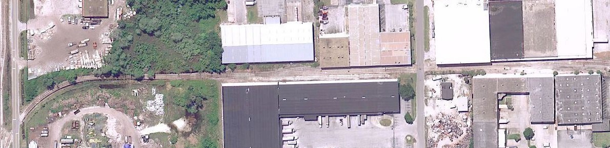

For the benefit of those who may not like the straight looking track plan, it's based on this portion of an FCEN industrial spur in northwest Orlando, FL., and matches the actual track arrangement quite well, although I don't model the connecting turnout and have added a highway overpass, about where the curve in the photo starts, to conceal the end of the main layout.
Of course my layout will be located much further North from Florida and the time period will be between 1978 and 1980, so I can have all those colorful short line IPD box cars. I've also picked industries for my ISL that are ones that appeal to me and also support my freight car fleet, along with industry names that are more appropriate for my part of the county; so of course this layout is entirely freelance.
Right now, the spur is supposed to be located on the L&N (one of my former employers), but I may later change it to be a spur operated by a fictional switching company or short line operator. Motive power is currently an L&N MP-15dc along with an NW-2 (yet to be painted L&N) and now and then I switch the layout with an L&N C-420 like we often used on our local freights. Love those ALCo's! Layout power is of course DCC with sound equipped locomotives.
Industries are:
Durkee Foods - Spots one to two tank cars of vegetable oil, and one or two reefers or box cars.
Peerless Confections - Spots one tank car of corn syrup and one Airslide covered hopper of sugar.
Purina Pet Foods - Spots two covered hoppers of bulk DDG or the occasional box car of bagged DDG for manufacturing dog food.
Midwest Distribution Warehouse - Spots up to four box cars. The prototype facility is a large Xpedx distribution warehouse that receives paper products.
Lowes Lumber - Spots box cars of building products and bulkhead flats of lumber.
I'm still working on ideas for how I want to model the two industries that will be between the front edge of the layout and their respective tracks and have several ideas. Right now, I've just got some rather crappy looking mockups placed in those locations and have no problem with spotting and uncoupling cars behind the structures and feel that having structures located on both sides of the industrial spur, just looks and feels more prototypical.
Don't know when construction will start in earnest as I have some medical problems and Dr. Tomassoni is scheduling me for surgery, within the next few weeks, to hopefully correct the problems. Those heart doctors are busy fellows! For now, I'm quite happy and satisfied to be able to operate the layout and often have a friend over for impromptu operating sessions, which generally take an hour or longer for a typical session.
Ed

Ed,I think you made a wise choice..
I like it a lot.
As far as Slate Creek..Its on hold pending a move to larger quarters..Like you I am thinking of the Slate Creek Industrial park owning a locomotive but,I'm not sure.My choices will be either a GE 44 ton GE70 Ton.
BTW..I did change the produce distributor to a Crispy Kreme bakery since that made better sense.
Larry

Ed, I think that is a great trackplan. I like that prototypical approach and it is a good idea to add this highway overpass to hide the end of the layout. Hope you are back to good health soon, not just because I’d like to see that layout being built.

Thanks Kurt. Like many others, I've been inspired a lot by the work done by Lance Mindheim, but must say that you're No. 1 in my book! Doubt that my modeling will ever be on the same level as the work you've done, but I'll be happy if my efforts just come close to yours.
It's so refreshing to see modelers taking a prototype approach to both track planning and operation and clearly demonstrate that you don't need switching puzzles with dozens of switches and short tracks to have "operation" on a small layout. Seeing the work done by you, Lance and a few others will hopefully get more people interested doing layouts like these.
Once I get the health issues resolved, then perhaps I can really get going on this plan. For now, I'm quite happy just being able to operate the plan some and stop wasting so much time planning and achieving nothing. I may even get up enough nerve to post photos of what I manage to accomplish.
Ed

Mike Kieran Wrote:But what would be the reason for 2 different customers on one spur? I've seen and worked lots of locations on the railroad where there is more than one customer on the same spur. You can find many such locations if you look around. I will say that in most such situations, you're more likely to find more than one customer on the same track in small towns or rural areas then in today's modern industrial parks. Many industrial areas in large cities that were and still are rail served, will have many such locations where there are several customers on the same spur.
If you look at the CSX Miami downtown spur that Lance Mindheim is modeling and follow it to the end, you'll see lots of locations where there is more than one customer located on the same spur or where there used to be more than one customer on the same spur.
For example: Here's one location http://www.bing.com/maps/?v=2&cp=n8zmq28...orm=LMLTCC. If you rotate the view looking south, you'll see that there are two customers on that one spur. Another example: http://www.bing.com/maps/?v=2&cp=n8zp0k8...orm=LMLTCC where you have two customers on the same spur. Looking closely at this location, you can also see how that spur once had a dog-leg in it and served yet a third customer across the street.
I personally have no problem with there being more than one customer on the same track and at one time in layout planning, was going to have just such an arrangement. It does interfere with customers when you have to pull their cars in order to spot cars for a second customer, during working hours, but often industrial spurs will be switched at night when this is less of a problem. Like many other things in the railroad business, it just depends on who, what and where.
Main point is, if it fits then don't worry about it. Such an arrangement can also add operating interest too.
