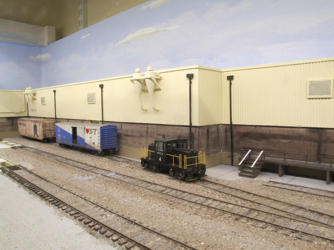

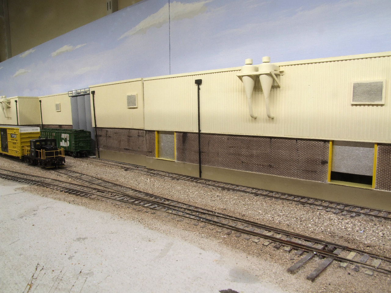

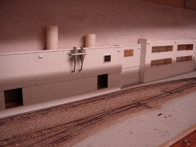

All the buildings were painted before being fixed to the layout, while these were drying I painted the sky and installed the layout lighting, which is a strip of led lights (cool white),glued to a 30 degree angled batten (this will also hold the front fascia) I had allow for 2 strips ,but was really please how bright one strip worked out.
Bricks were weathered, down spouts fixed, roller doors made and fixed and some of the smaller detail added before fixing
below is a overall view of the layout with just the led lights, they work really well Thumbsup Applause

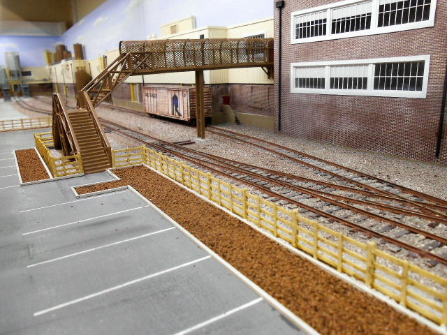

Next job was to scratch build the foot bridge from the car park into the building

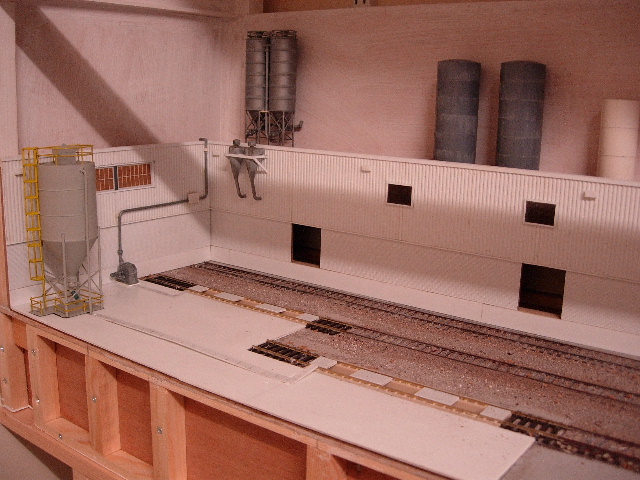

Matt, i'll try and explain the build.
Here you see the end plate ( as top of page 2) this is cut out of one piece of 9mm ply, the 2 hole are for dowels for ailment, there will be one at the top once I've finish.
to this is fixed a 35 x 18 mm piece of timber and a 6mm strip of ply along the top to add more strength, you can also see the access hole for the fiddle yard.
this forms the corner for the base to be fix to and also back boards, the little L shape at the bottom, is were the legs will slot in ( when finished)
the support for the fascia is screwed in between these end pieces, a L shape is made out of 35 x 18 mm and 38 x 12, which has a 30 degree angle planed on one side for the led lights
All this still needs painting, and a roof added to each board ,still on the "to do list", hope these photo's help understand how I built each board.
Ray

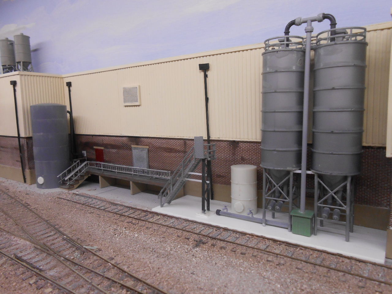

next up was to finalise the other detail locations
on roof tanks and safety platforms for covered hoppers
overhead crane for machine parts etc
substation
door for footbridge
ground level tanks
next job car park and paint those tanks
Ray

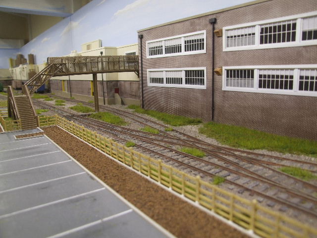

To bring you up to date.
footbridge painted and installed, car park finished, fencing finished, just some small tree to plant.
grass finished, all safety ladders done.
Ray

substation painted, fence added.
all tanks painted and installed
grass added
overhead crane painted and rusted up, fixed
all windows fixed.
That's us up to date, next job is front fascia's, and buildings etc weathered.
Ray

Ray,I must be going blind in my old age..I just notice the caged employee walkway over the tracks..Nice touch! Applause Thumbsup
