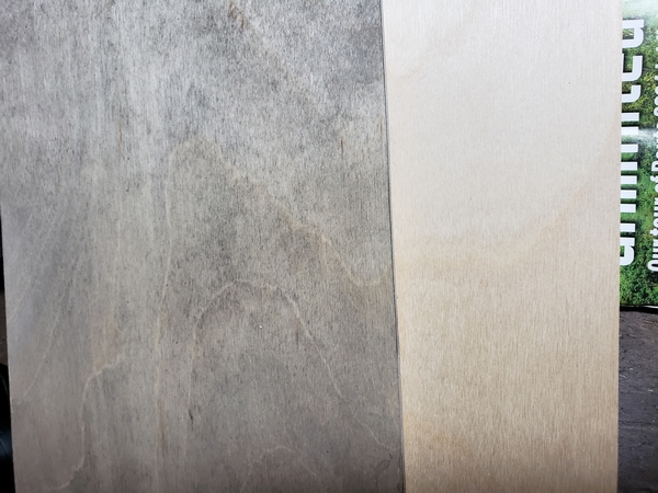

I decided to try using India Ink for the first time to age the wood.  Here are the before and after shots of the deck and a few pieces of wood.
Satisfied with the results of the color i found an online picture of a square wood engine to copy.

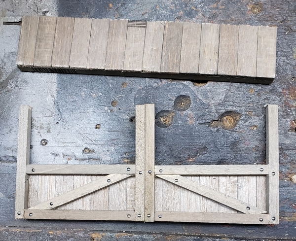

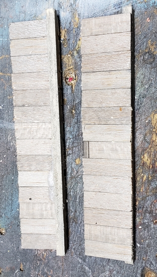

So, I began by making the side walls (about 7-1/2 inches long)
Gluing them to a 1/4 X 1/4 inked piece of wood.
The left is the inside the right is the outside
Then it was a matter of designing the height of the roofline for the upright supports and what the outside of the walls should look like.
Top - the wall from the last post.
Bottom - The wall with the uprights and the outside bracing.  The dots are nails I installed to supplement the white glue.

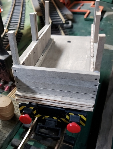

and after building the second wall, I positioned them on the base.
i then cut, glued and nailed strips to the rear to support the walls and act as the rear wall of the engine.
Close up of the rear of the engine
