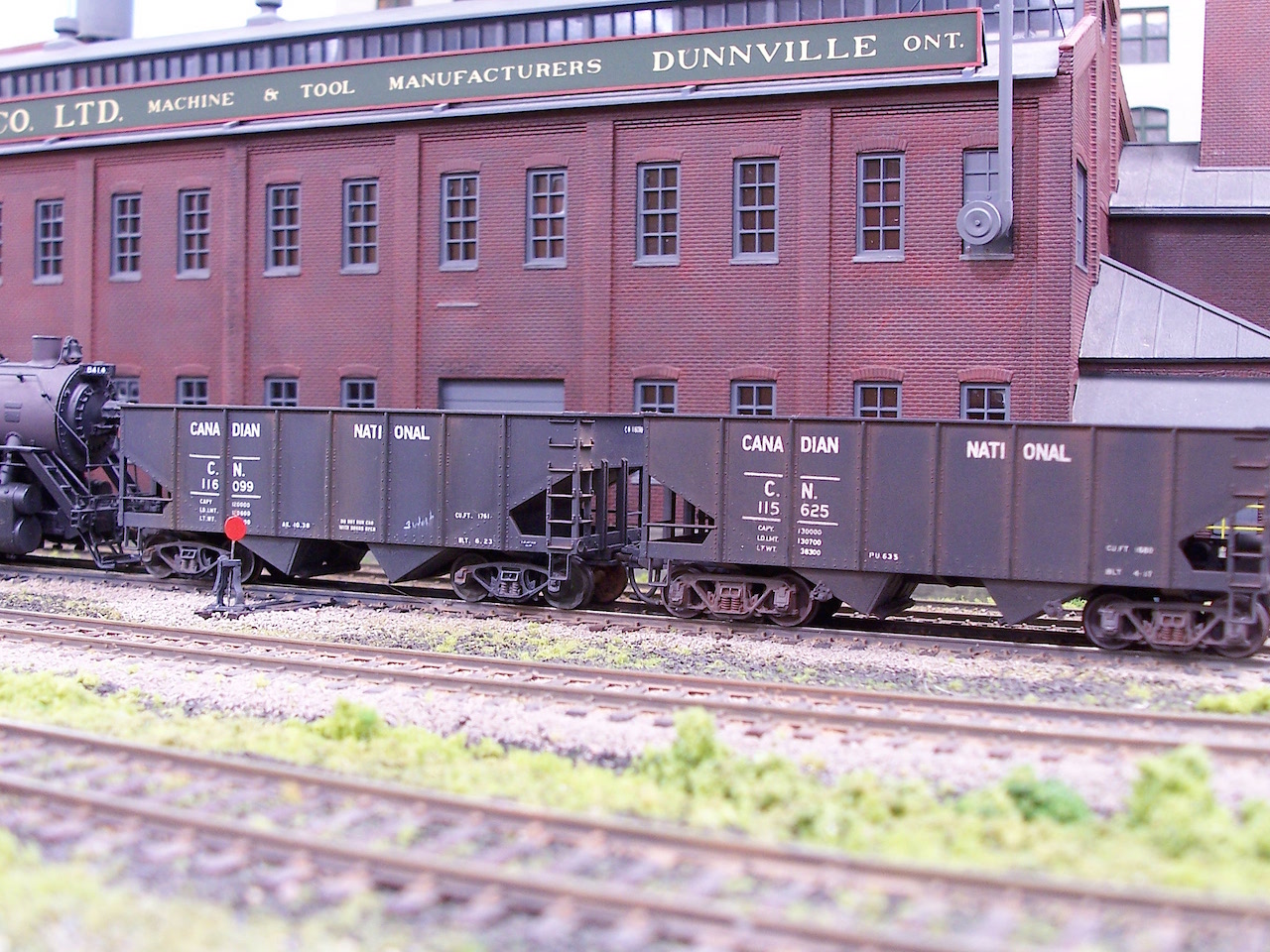

I have only a couple of CNR hoppers, and they're in the pre-war black paint scheme. I'd offer a photo, but I'd have to find it in my disorganised disc collection, as Big Blue will not show images from the "new" version of photobucket...I've tried, but all that shows-up is this...
undefined
I did try to find a photo on-disc, and actually found the one I wanted, on the first disc that I viewed. However, when enlarged, or "copied", to transfer to my desktop for re-sizing as an attachment, it enlarges as a totally different picture of a N&W hopper...talk about juggling numbers!
Anyway, here's the two hoppers in a just-taken-a-minute-ago picture...
...not that it'll be much help in finding that C-D-S set.

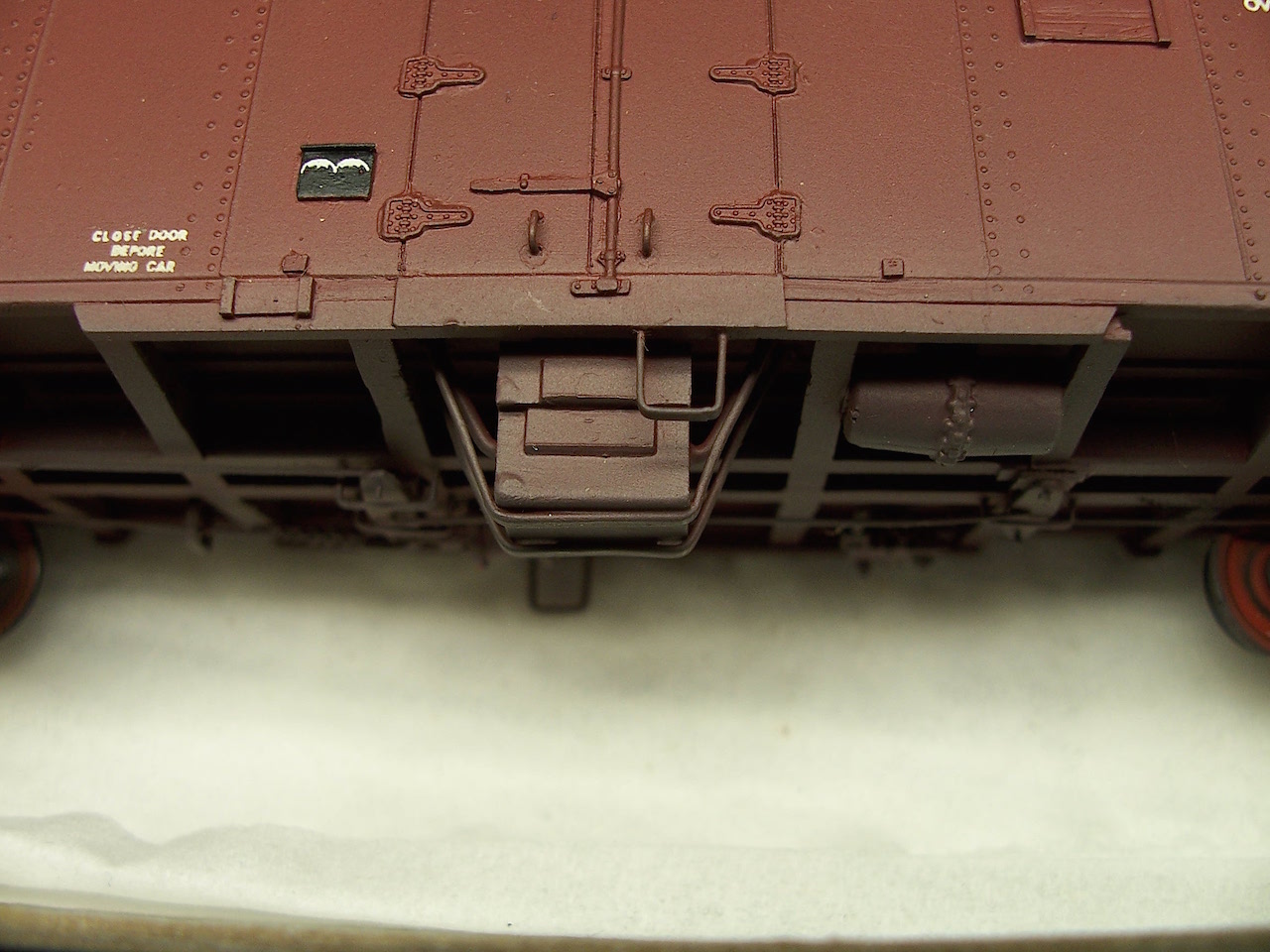

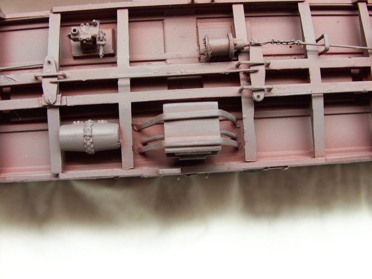

(08-19-2020, 10:29 PM)cnrglen Wrote: ...One thing I would like to add to this car in an underbody charcoal heater. I just wish I could either find a casting or figure out how to scratchbuild one.
I sorta semi-faked this one....
...from a multi-part feature in the Dec. '95 and Jan./Feb. '96 issues of RMC, covering the development of the 8 hatch reefers of the CNR, CPR, PGE, and GTW.
The heater was charcoal-fired, but unlike the ones use in end-type ice bunkers (the bunkers were usually fitted with a small hinged side-door) the underfloor type was developed around 1936 by CN and CP, in cooperation with the National Research Council.
It used an anti-freeze solution in copper coils, with the coils above the floor, but below the interior floor racks. The solution moved through the coils and back to the heater by convection, while the heater was fed automatically from a 60lb. charcoal magazine.
Mine was made from a piece of Evergreen (or perhaps Plastruct) 3/8" square tubing, with a .010" piece of sheet styrene to cover the front and rear of the heater box, which sits on a square of .060" sheet styrene (to allow it to project further below the car's sidesill. I then added a few more bits of styrene on the face of the box to represent whatever was shown in the photos (probably a door for the charcoal magazine...my guess, anyway).
The straps, supposedly holding the heater in place, are Detail Associates flat brass bar (.010"x.030")(if you don't have any flat brass bar, strip styrene should work, too) and I used what appears to be some .030" or .040" brass wire for the pipes leading to- and from- the coils.
A couple of photos....
I faked the liquidometer using a square of .010" sheet styrene, with a .010"x.020" strip of styrene on its top edge. The "dials" are the top portion from a couple of dry transfer "0"s

Thanks Wayne. I have everything I need except the 3/8" tube, which I'll be picking up tomorrow after work.
Your tip with the liquidometer will come in handy too.

Thanks to Wayne's instructions, I scatchbuilt the heater. At first I was a bit taken aback by how large 3/8 is compared to the car but I opened an unbuilt resin kit of a CN 8 hatch reefer to check it's casting and it's about the same size.
and while I was building one, why not build three:
The three units were sprayed with primer this evening and I'll be airbrushing them in boxcar red shortly.
Now it's starting to look 'Canadian'

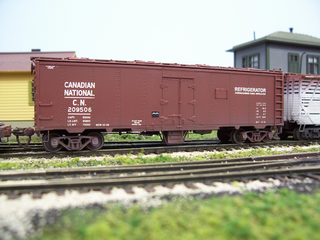

I finished off the decal work on my Cn reefer:
![[Image: 202083019415_DSCF8855.JPG]](http://www.railroad-line.com/forum/data/Glen%20Haasdyk/202083019415_DSCF8855.JPG)
I think I might have gotten some earlier decals from Black cat because I didn't seem to manage to make the decal edges completely disappear. I've have better luck with other decals of theirs. I also added the charcoal heater and the liquidometer gauges
![[Image: 2020830194339_DSCF8862.JPG]](http://www.railroad-line.com/forum/data/Glen%20Haasdyk/2020830194339_DSCF8862.JPG)
I made the liquidometer panel as per Wayne's instructions but I added gauges with the top 3/4 of the zeroes of the dimensional data decals. I found it easier to use waterslide decals here instead of dry transfers.
I still have to weather the car. I'm not sure how heavy I would go the weather it. Seeing as it's 1958-59 I would figure that a wood car would have quite a few miles and years on it. But then CN kept these cars in pretty decent shape right through their careers.
I also added the heaters and liquidometer gauges to the other two CP steel reefers.

Those cars look great, Glen!
