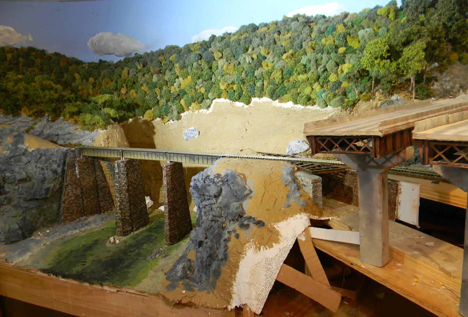

No rest for the weary, however!  We move about 14 (non-scale) feet to the east.  I know I've posted some photos of this area in "Side Shot Saturdays" or "Photos of the Week", and each time I see a photo I see how nice this area could be if I finished the scenery!

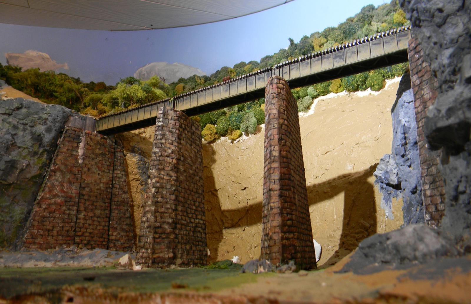

There are two railroad bridges between Jim Thorpe and White Haven, PA on the former LV mainline.  While the CNJ travelled strictly on the west side of the Lehigh River in the gorge, the LV started on the west side, switched over to the east side at Penn Haven Junction, and then crossed again just south of the town of White Haven and then crossed over the CNJ and paralelled the CNJ toward Wilkes Barre.  There's a contemporary shot on the west side of the Lehigh here: https://www.railpictures.net/images/d2/8...524858.jpg.
I never had enough room to duplicate the straight section of the river here, as my storage level is in the way.  So, my river bends sharply just past the bridge.  The real bridge is a double track (2 sets of deck girder bridges), but since the double track was reduced to a single they only use half of it.  So, mine is a single deck girder bridge with two abutments rising from the riverbed and two abutments built into the river bank.
Here's the current scenic state.
On the far right you see the ends of my I-80 bridges (intent on leaving those as is), the crossing of the CNJ (in 1976 the tracks had already been pulled up here) and then the deck girder bridge that's probably about 60 feet to the surface of the river.  If I've had extra paint from the Mud Run project, I've been getting rid of it on the foreground rocks and the riverbed (which still needs copious amounts of Realistic Water to be applied. There's a bunch of dark brown, painted surfaces that desperately need attention, most of which are behind the bridge.
The fun begins behind the bridge.  Rather than squeeze myself in between the bridge abutments, I'm going to take down the bridge until the scenery is done.  That means I won't be running any trains on the viewing level after the dismantling, which means I may have extra incentive to get this project completed, or it may mean installing a temporary bridge I can run on in the interim without abutments.
So, just like Mud Run, the first order of business after dismantling will be getting the riverbed fully painted and prepped.  Once the riverbed is poured, I'll be working from the back to the front in stages (painting, layering with ground covers, applying shrubs and underbrush, and then finally trees).  I'll once again be providing progress reports as things progress.
I am impressed by the bridge and the scene already. I am looking forward to see how the work progresses.
Thanks Tom.  With so much going on here (an interstate highway, an active railway crossing over an inactive one, a river and a railroad bridge with massive abutments), this was always going to be a feature that draws interest.  I wanted to make sure I had a good handle on background and foreground scenery before attacking this one.  So, it's time.

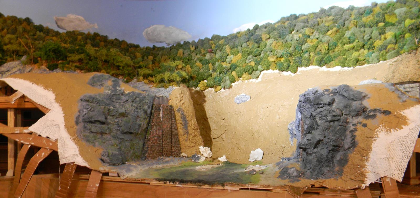

Took the bridge and the free-standing abutments out this evening.  Won't be running trains through here for a while!

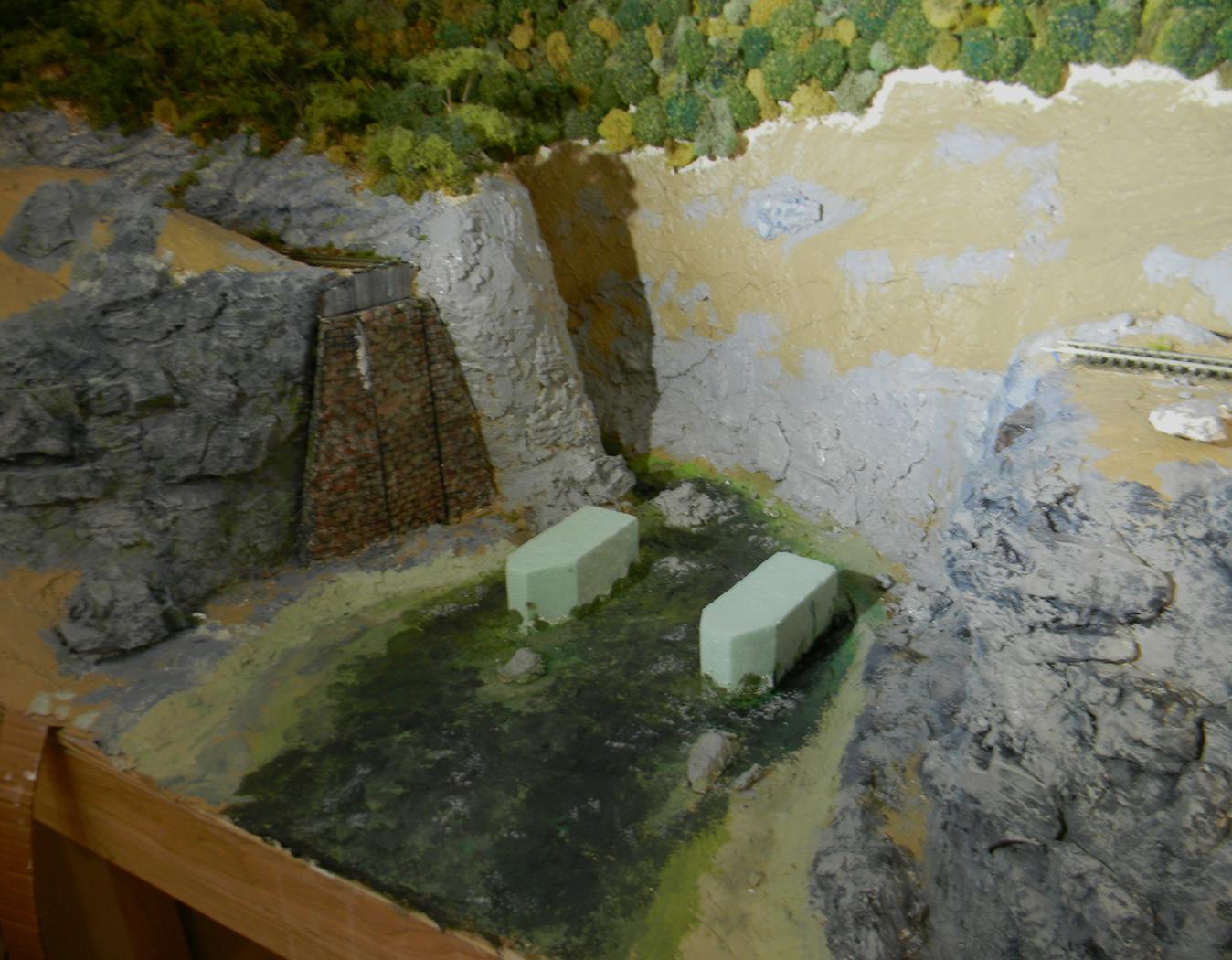

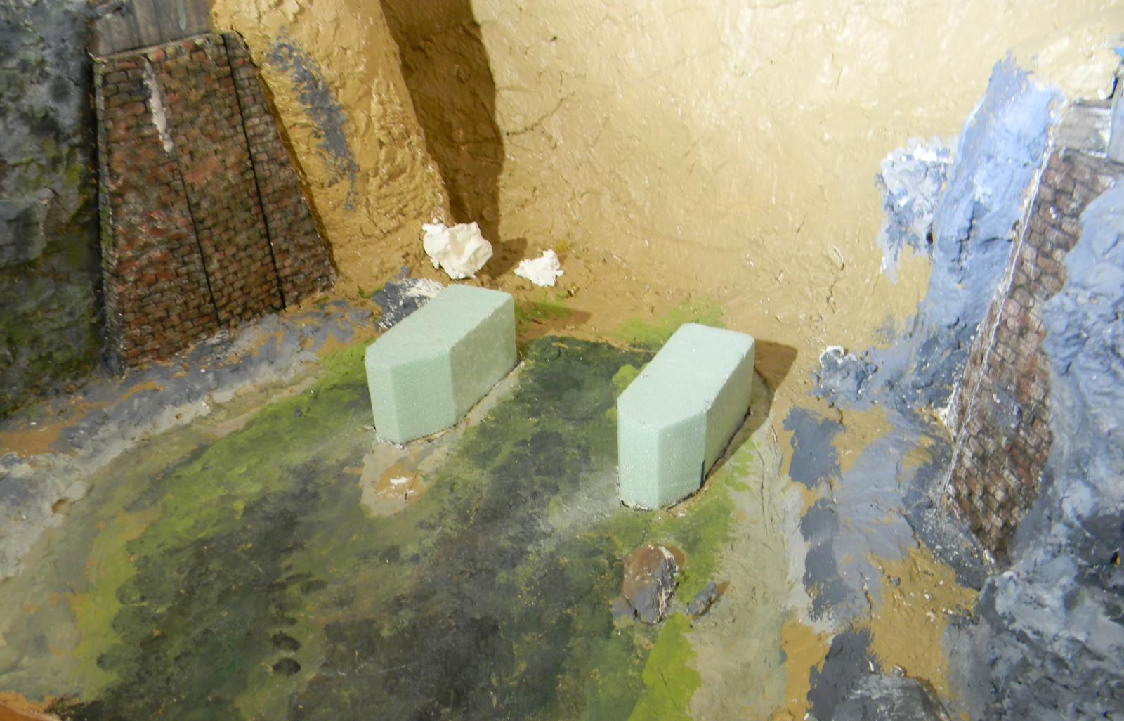

I also spent some time making sure of the abutment locations.  Before I removed the bridges and after pulling the abutments out I dropped a small plumb bob from the support pins under the ends of the bridge sections and got good centering, spacing and alignment for each free-standing abutment.  Marked those locations on the Sculptamold and made adjustments with a hobby knife to clear the Sculptamold and plaster cloth off of the plywood base.
I'm going to add a bit more Sculptamold to areas around the base of the abutments and want to keep the Realistic Water from seeping under the areas for each abutment, so I made two surrogate bases out of Styrofoam board and screwed them into the plywood base from underneath.  Once the Realistic Water finishes curing, I'll remove the surrogate bases to give me a little more room to work.
Painting starts tomorrow!

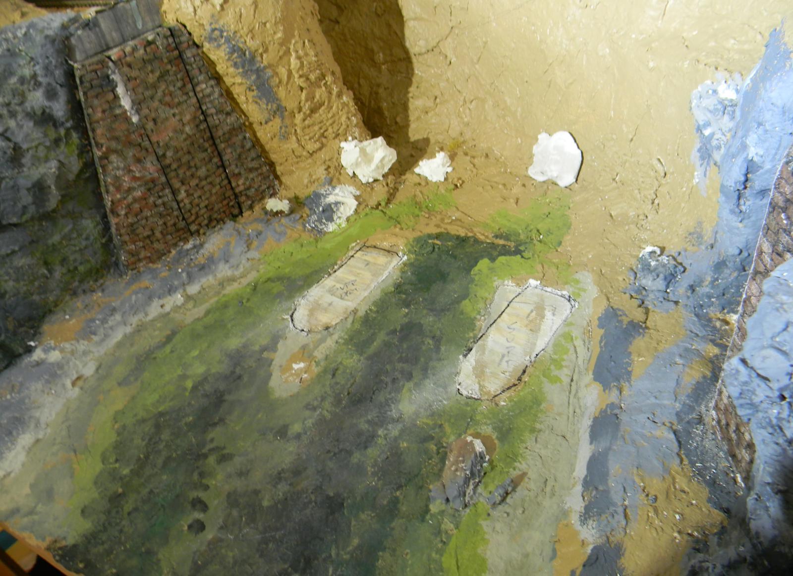

Did some base coat painting this evening, focused mostly on the riverbed or the banks just above it.  With the river making a sharp bend (in real life it's much more gradual), there will have been quite a few scouring events during heavy rainfalls.  I gave some thought to adding some of the ruins of the old canal that existed on the west side, but there just isn't enough room.  It's going to be a rocky bank with some stubborn trees and shrubs.  As I get about 20 feet up the trees will get more substantial.  Tomorrow night I'll focus in on detail work on the potential rock areas and detailing the riverbed itself.  Once I'm happy with the riverbed I'll get the Realistic Water out and pour the lowest areas (in the turn) first and build up toward the edge of the layout.
Adjusted some of the riverbed tonight with a pallet of greens and browns - I have to detail the rocks prior to pouring Realistic Water.

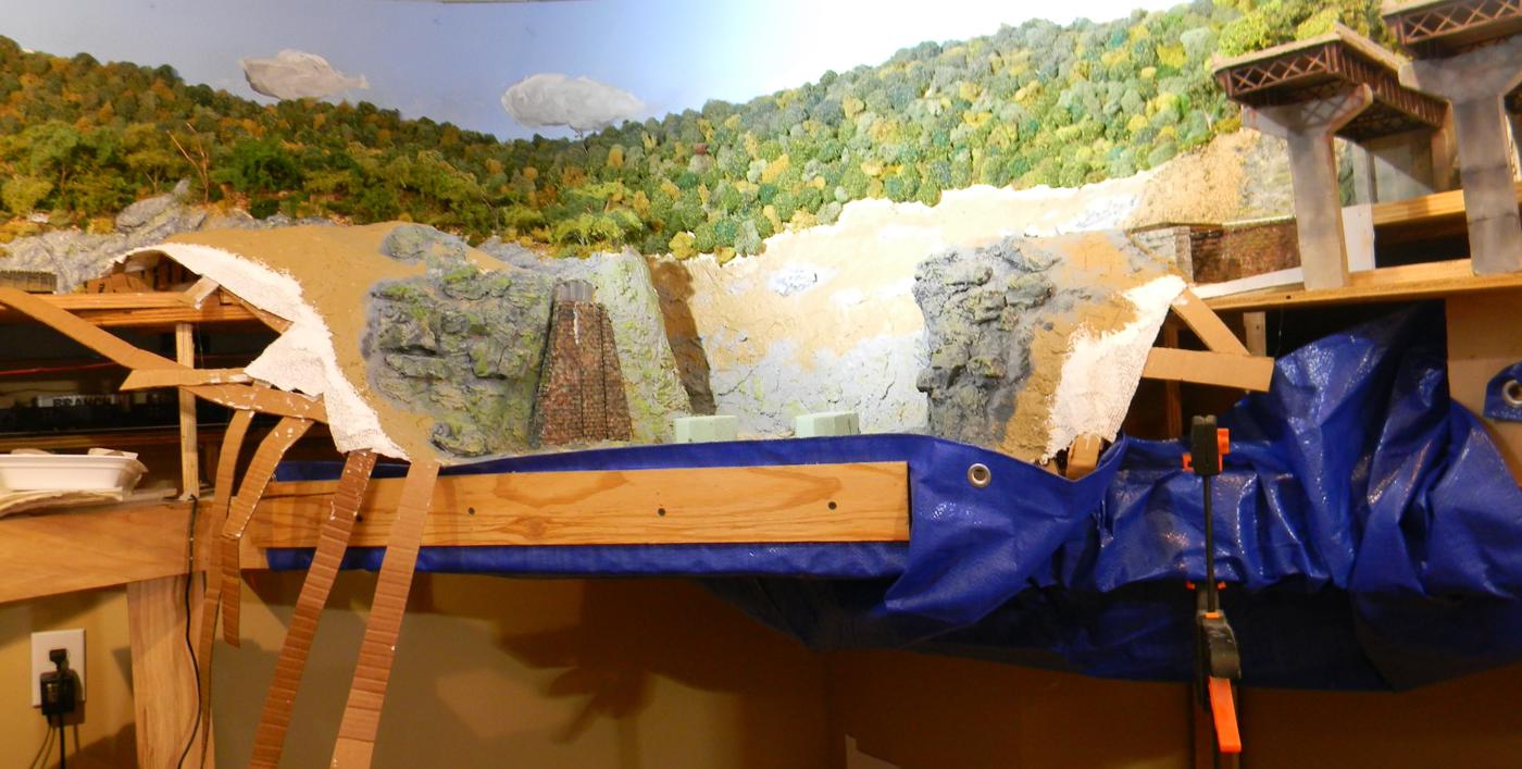

In the meantime, I've installed my dam - a blue tarp that I secured up against the edge of the layout with a few screws into a piece of scab plywood, and worked under the supports and secured using the grommets of the tarp.  If I do get some drips, the tarp will keep the polyurethane from setting up in my carpet.  I also ran a bead of silicone between the tarp and the riverbed.  Eventually there will be a piece of fascia at the edge of the river.
