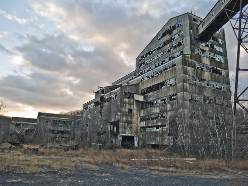

So, I've been focusing on ideas for my coal breaker.  There are some pictures out there, but not much from my model timeframe (a lot of early 1900's stuff, some at abandonment).  I've decided to wing it and design my own breaker.
My available height is 28" at that point of my layout, which would allow for a breaker of roughly 200' in height.  Most of the big ones didn't typically exceed 150 ft (a view of the St. Nicholas breaker is here... https://www.vagabondish.com/wp-content/u...00x600.jpg), so I don't have to go all the way to the ceiling.  I'm also doing one side in full facade and angling away from the track as it makes it's way down to the storage level, so there's going to be a short side wall and a long side wall off of the facade.  The structure itself will be concrete posts for the first floor, and then steel posts with corrugated sheet metal skinning the structure.  There will also be walls with a bunch of dirty windows that would have allowed some light to get inside for the sorting.  I'll also make the upper floors with a smaller footprint than the base, so, some sloped roofs (corrugated steel again) at various points upward along the structure.  After placing the finished structure, I think I'll be doing some painting on the backdrop to extend the depth of the breaker (which is going to be a challenge because the backdrop has a substantial curve!).

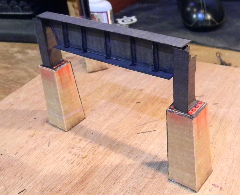

Made my purchases for the kits needed to bash my coal breaker.  I'm starting on the ground level and building support posts for the structure.  The posts are from the Traveling Crane kit (sheets shown below in the photo).  Built my first one (cutting, folding, edging, gluing), splitting time between last night and this afternoon after hiking, running errands and cutting the grass.  I figure I'll build about 10 of these posts which are just about 4 inches tall.  Once they're built, I'll then integrate each onto the layout, which is not flat or level, so shimming is going to be necessary to get a level first floor.  Once all the posts are built, there are also horizontal beams that run between each post that will support my floor level.
After building a few posts, I thought I'd built a girder that runs between them (also included in the crane kit).  I'll have to build enough girders to run between each post and the decide if I want to run stringers between posts in depth to support the first floor of the breaker.  There's a lot of folding and cutting for each girder, but they do look pretty good when complete.  Gravity mounted a girder between two posts, and I like the look.  Vertical distance between the base of the posts and the underside of the girder is 3 inches, which is good clearance for almost all of my rolling stock.  I'm probably going to build a small base under each post to add a little more verticality.
Pretty good looking!
