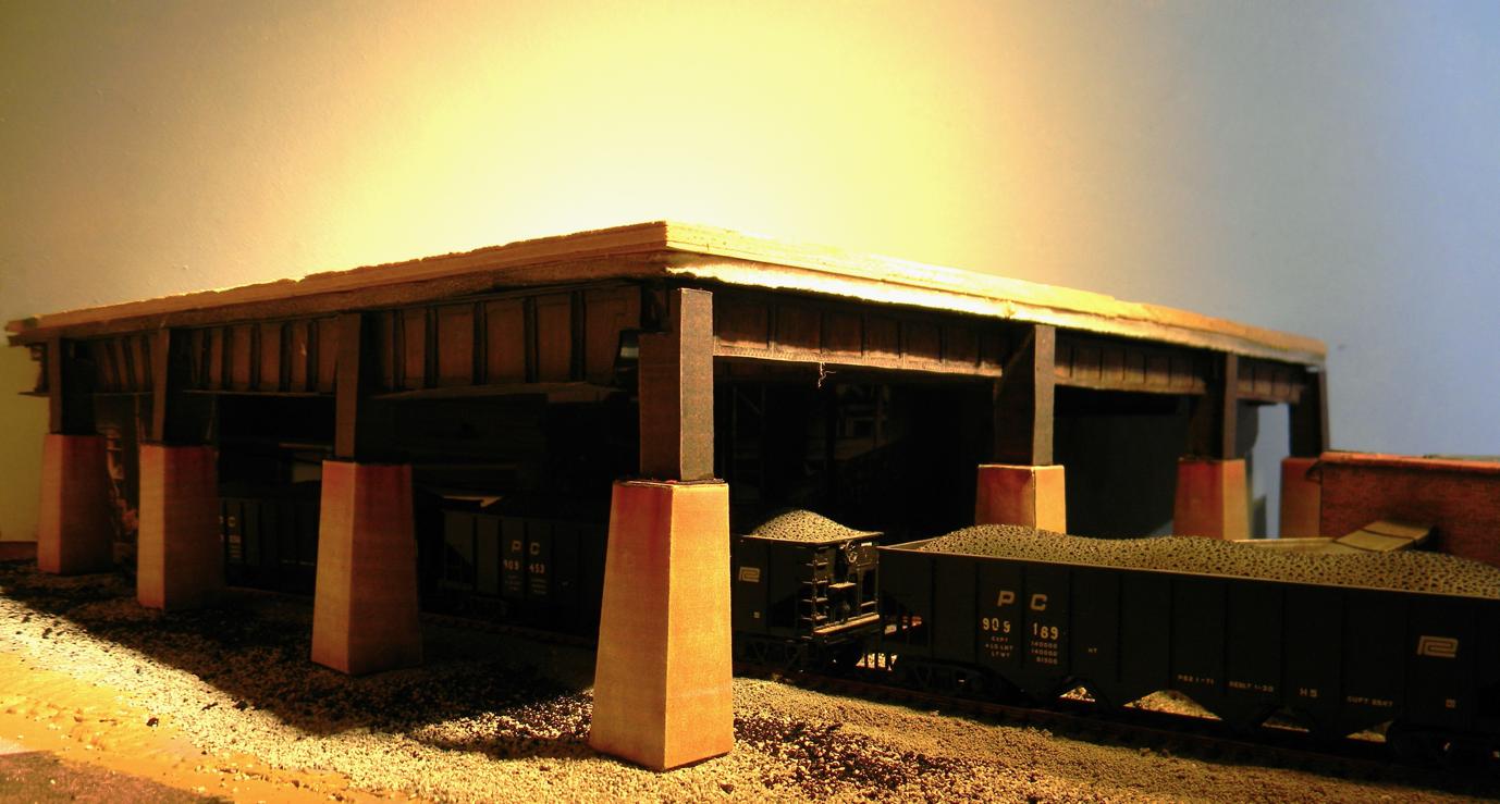

Last night was the night. Slapped a bead of silicone sealant on the edge of the first floor where it rests against the backdrop and let it set up in place overnight. Added the piers this afternoon and I also placed three hoppers on the track to nowhere. Roughly positioned "Plant #2" (sits in the picture behind the last hopper), and as you can see in the picture below, I think the entry to my storage level is now effectively hidden - that part of the mission I can now say is complete. I have a few things to add to the understory, but for the most part, the upper stories of the coal breaker are now my focus, which means a lot of printing and bashing of paper. I think the understory looks beefy enough to support a massive structure above it.

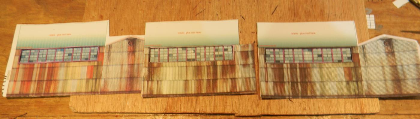

With the foundation built (and level), this job MAY get easier....

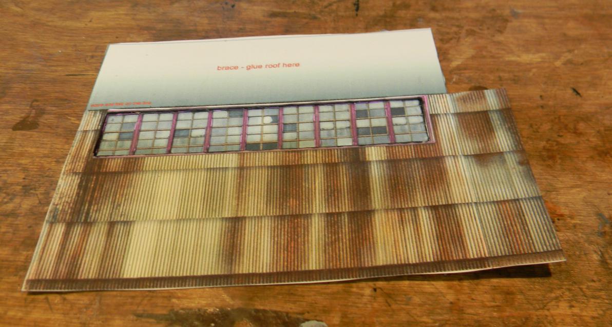

The basic exterior is nothing more than joining together sidewalls of the "Small Steel Mill" kit. I had 15 inches to cover on the short side, and each of the sidewalls is nearly 5 inches wide, so three sections were laid out, measured for overlap, and the edges folded over to accomodate the corner, and windows inset back from the front face. The kit comes with additional steel siding that you can overlap over the existing printout, but on something of this scale, I think it's overkill (I may change my mind). The section on the left was done with an ink cartridge that was almost expended, so I got a different color combination. I figure I can always adjust with paint or PanPastels if I think the transition is too harsh.
Pinned the first story in place to get an idea of scale and how many of these stories I'll implement vertically - I'm going one story at a time with only a basic concept in my head. After I get a full wall section together, I'll reinforce the whole deal with foam board supports which will join all of the walls and roofs together.

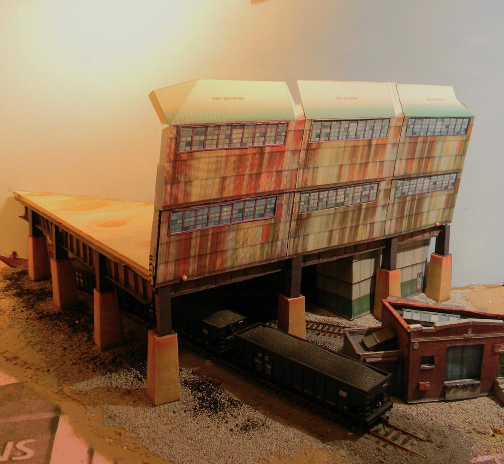

I haven't worked on the long side yet, but I have glued together enough sections to make the "2nd" story. In the picture below you can see it temporarily held at a jaunty angle by a couple of push pins. At the top of the 2nd story, I'm going to have a small roof section and the building will get smaller dimensionally (the third story will have a smaller footprint, and that trend will generally continue up to the top where I'll have a conveyer chute running back down into mine area. All of these plans are still vapor in my head and (of course) subject to change... heck, if I don't like it, it's paper... I wad it up and try again!

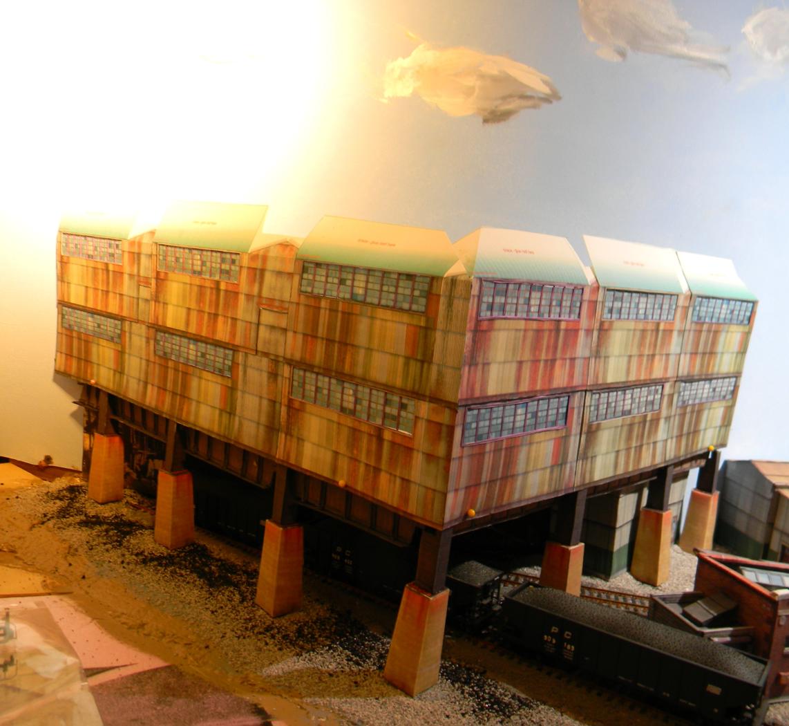

More printing, cutting, joining. The photo below is the first two floors of the beast pinned to the floor without any integral supports (those come next). Not sure if that means this weekend or later. I'll also be developing the sloped roofs that run up to the (smaller in floor space) third floor.

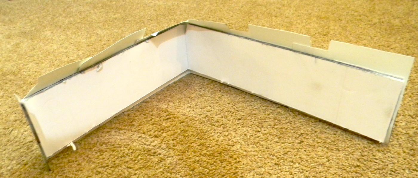

Slow progress is still progress. You build something large with cardstock and you're asking for trouble if you don't reinforce it. I cut a couple of foam board panels that'll sit on the plywood first floor and get glued to the backside of the cardstock. Before gluing, I spray painted the panels black - thus eliminating any gaps between windows and window frames.

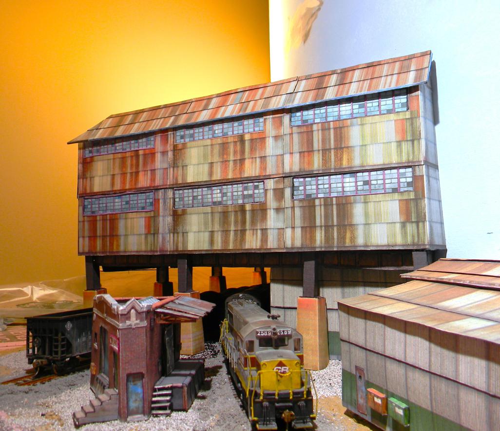

I also started on the roof that'll run around the north and west sides of the breaker, joining roof sections and then adding some depth by layering. Once I get those roof sections done, I'll be measuring for the third story which will be a smaller repetition of the first two using the same sections of the Small Steel Mill. That floor will also be supported by foam board panels that'll go all the way down to the plywood first floor.
