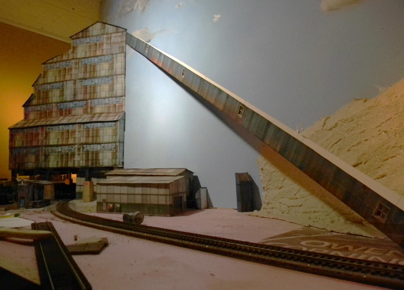

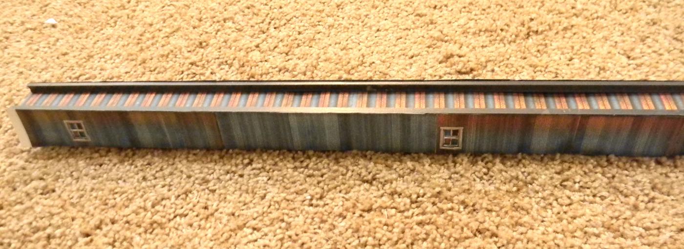

Next, I spent some time last evening coming up with a conveyor shaft to bring the bulk coal up from underground to the top of the building.  There were some nice siding pieces left over from my "Silver City Factory Flat" kit that I thought had the right scale and corrugated steel look, so I joined about 6 sections together and cut the end to the right angle, added windows (out of the same kit), and mocked up three sides and a floor....  Here it is just resting against the top of the breaker and the foam board, but you get the idea.
Tonight I'll add a roof sections (also from the Silver City Factory Flat).  The conveyor structure starts out virtually 2D right near the breaker, but transitions to 3-D and moves away from the backdrop on the way down.  I'll have to figure out some towers to support the conveyor at different spacings on the way down, and eventually, I'll be building some coal and stone berms to hide the lower end of the conveyor.  I supported the floor of the conveyor with some leftover plastic I-beams to give the whole thing some stiffness.  The picture below shows the underside of the floor and some of the siding details.
Two nights were spent on the roof of the conveyor, but here she is (not in the final location yet).  I need to build my support columns - have some ideas, but I'm going to play around until I find something I like.

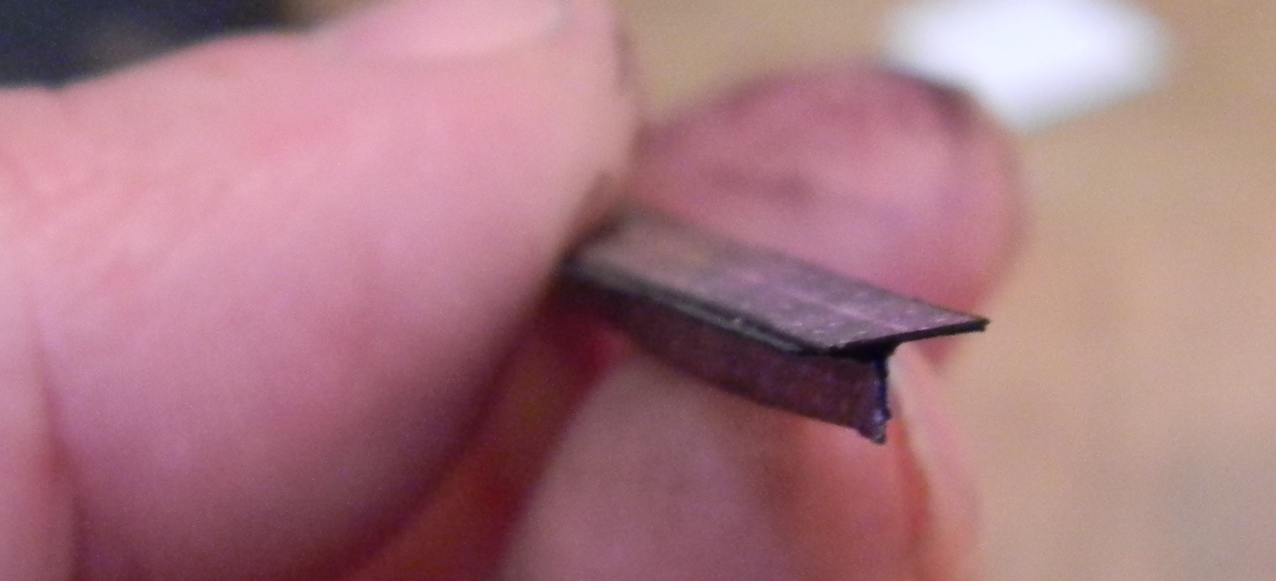

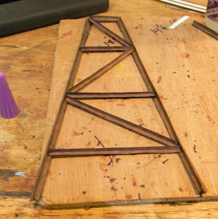

Back to the files from Clever Models.  For the girder bridge kit, there are a ton of long, thin rivetted lengths of rusty steel.  I decided to cut them out, and and join three of them together (two folded into 90-degree angles and a flat on the other side).  I built maybe seven or eight of these "triple girders" and then made a template on a piece of plywood and joined the girders with a dab of glue.

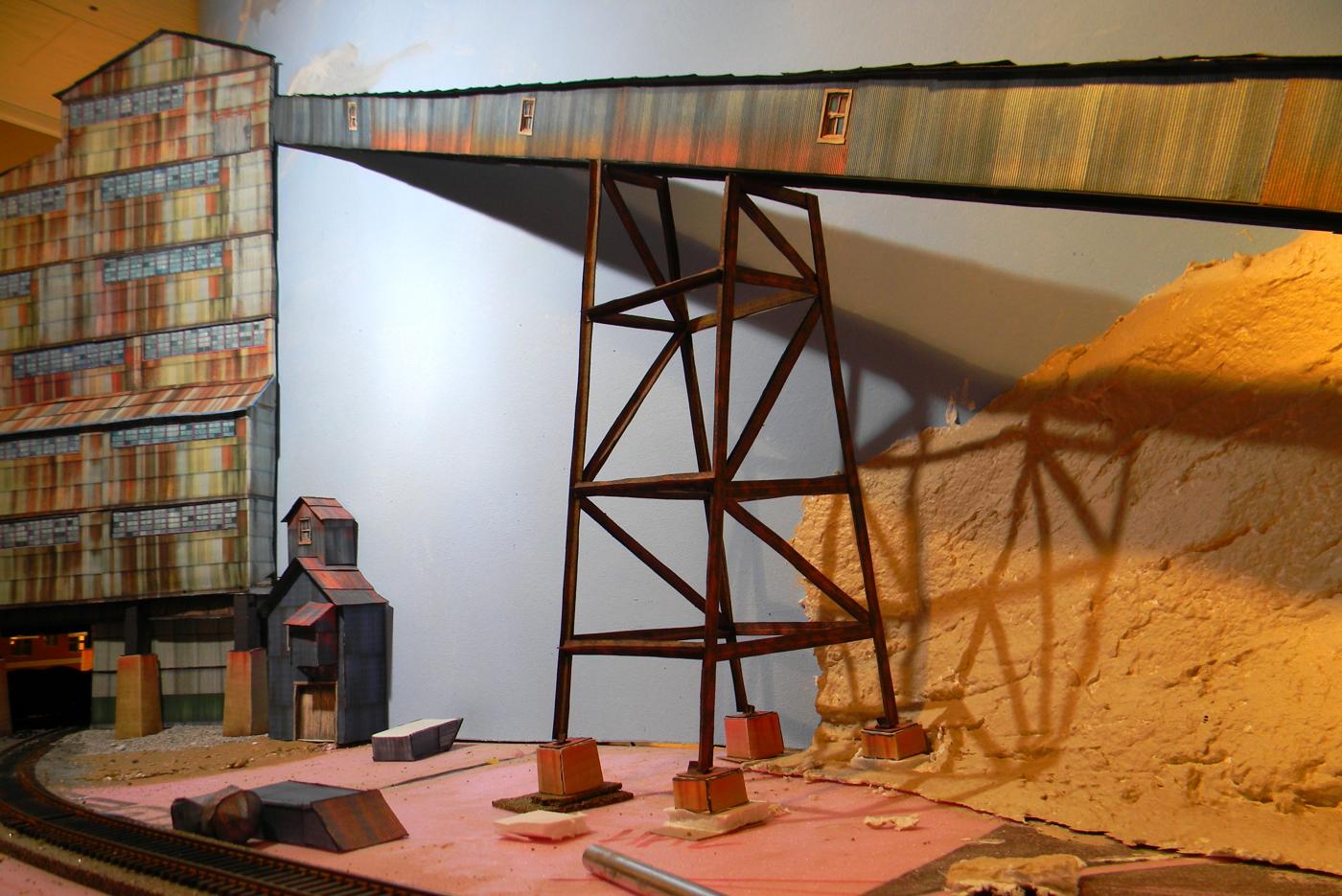

Then there was the support from ground level.  I used a shorter version of the piers used for the support of the breaker from the Overhead Crane kit for those, and put a short foot on the bottom of each main girder.  I'll eventually pair this tall support structure with another that's slightly shorter and link those with other girder pieces to create a tower.
Although the footings aren't in their final orientations and nothing's been glued down, here's the look I'm heading toward.  The scale on the girders is a little too chunky, but I'd rather have too much beef than it be undersized.

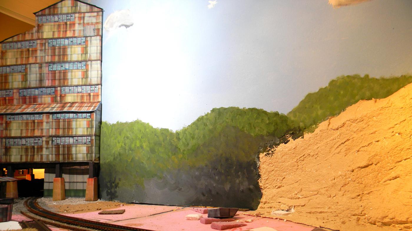

I did get the paints out briefly during the 2nd game of the wild card series between my Phillies and the Marlins.  Roughed in some hill profiles and then went to town with a bunch of greens and grays - first with a relatively wide brush...  Color pallette was inspired by a current picture of the area around the old Hazleton Shaft Colliery via Google maps.  I did pull down one of those that I'll mount on some wallboard and place somewhere on the backdrop.
...and then a bit of detail with a smaller one.
