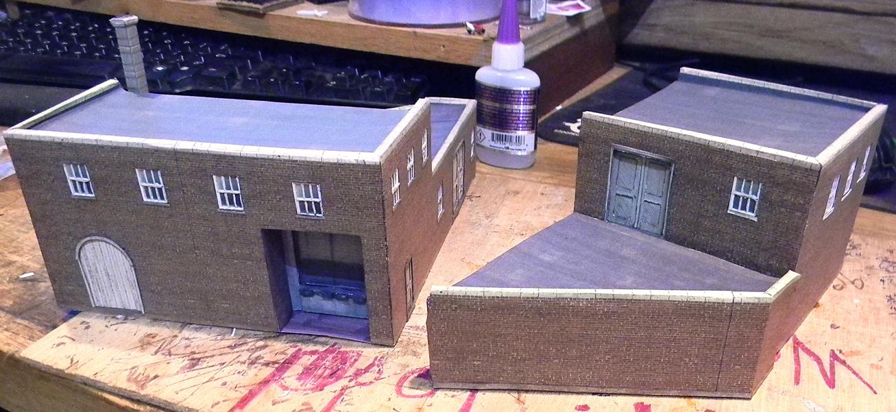

Finished up the basis of Building B (it's on the right side of the photo below) last night while watching my Phillies pull out game 2 of their series with the Mets.  Building B was a little smaller in footprint and could be integrated into portions of building A (on the left), but these are going to be separate for the brewery.  I'm still thinking about some grain and water storage for the brewery, and I may have some leftovers from some old plastic kits that would suffice.
I'm planning on a large "Pilsner" billboard on the top of the 2nd story of either building A or B along with some additional signage on the building, I hope to build that stuff in the next couple of weeks.

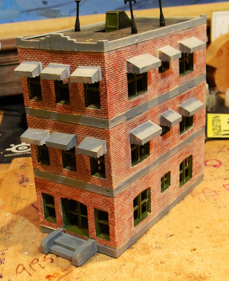

I spent a little more time this afternoon with a stiff brush painting the concrete features on this building, and while I was at it, also hit the awnings with the same gray paint - nothing in Hazleton is white for more than a few weeks, so it stands to reason that the awnings wouldn't have started as white either.

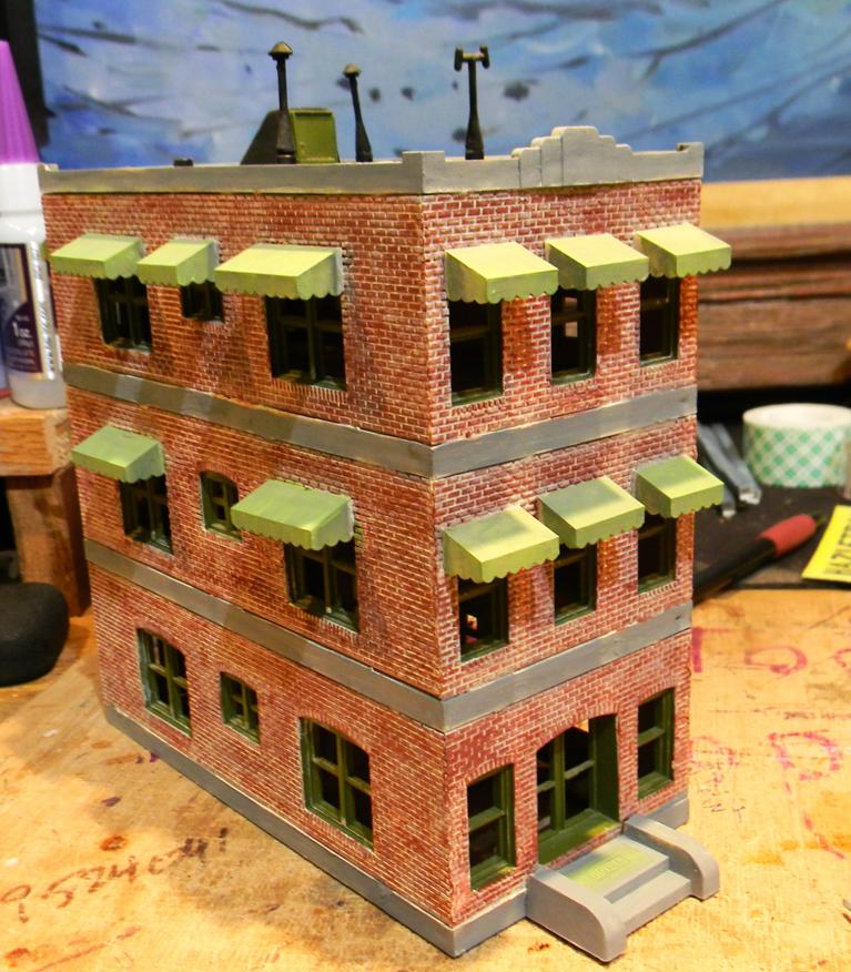

The window trim is a woodsy green, so I decided to try a lighter green for the awnings and tried to pull my paintbrush down the awning.  I don't know if that's the final color, but it's something for now.
Looking more unplastic after 24 hours.

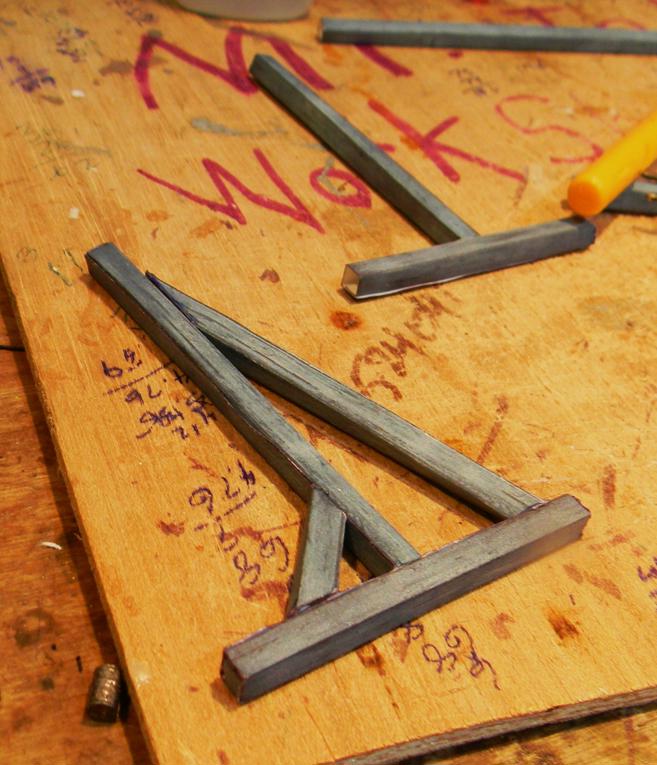

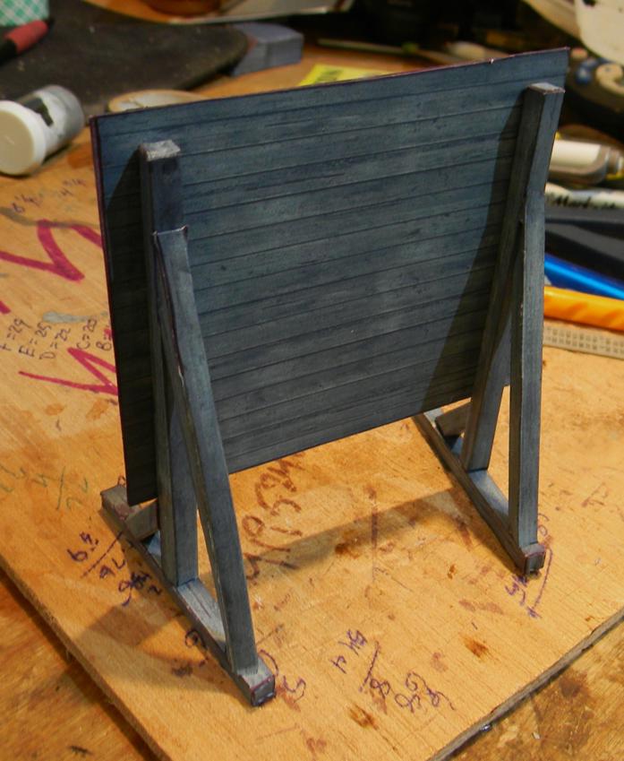

I have to make some headway in getting stuff off of my workbench - the amount of space available has shrunk to an unacceptable level.  I still had some paper beams that I'd intended to join together to make the supports for the billboard that goes on top of the brewey, and I finally came up a way to join them shown in the bottom left of the photo.  I just need to finish the other 3 that get attached to the back of the billboard...

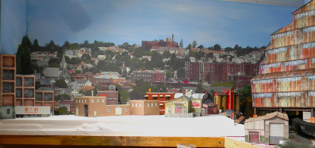

I did a little bit of moving tonight, trying to find the right balance between spacing of buildings and allowance for roadways here in Hazleton.  I'll be getting ready to get the foam cutter out to lay waste to the foam (after I've glued it together with some foam glue), creating the base terrain.
So, here's a shot at more of the viewing level - the intent is to give the impression that the buildings are heading away from you downhill to integrate with the backdrop.  In the past I've always run uphill and away from the viewer, but this is something different to try.  Obviously, the further away from the viewer's eye, the less they see of the structures, but even this space, which is only about 16 inches deep, you get that impression that things are receding away and down.  I'll further that perception by breaking up the view from front to back with fences, trees, walls, signs, etc.

Got the foam cutter and a flat rasp out and shaped my terrain around the building locations (which have to be flat, otherwise they look "wrong"), paying special attention to roadways.  It's tough to get a good picture of this since the foam is a blanket of white.  Starts with three 1/2" layers of foam in front and recedes to the back with only one layer.  I'll be gluing these down over the next few days with foam glue which sets up in 24 hours.  I'll also be cutting out some 1/4" plywood for fascia at the edge of the layout with the same profile as the foam.

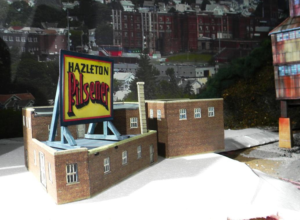

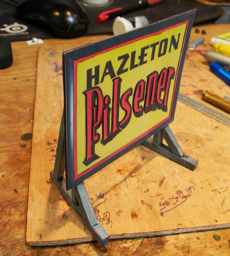

Well, finished up the brewery billboard and the support members....
then put it in place temporarily on the brewery itself....
My verdict is that the support beams are over scale.  Probably would look good on in O-scale, but not HO.  The billboard itself is OK, so at some point I'll replace the supports.  Another "you live, you learn" moment.
