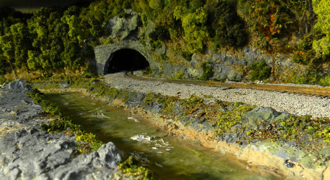

Finished the tidy up and installed some low scrub between the ballast and the river. I have to scenic the top of the opposite bank (probably paint applications with several layers of static grass), but mostly done here.

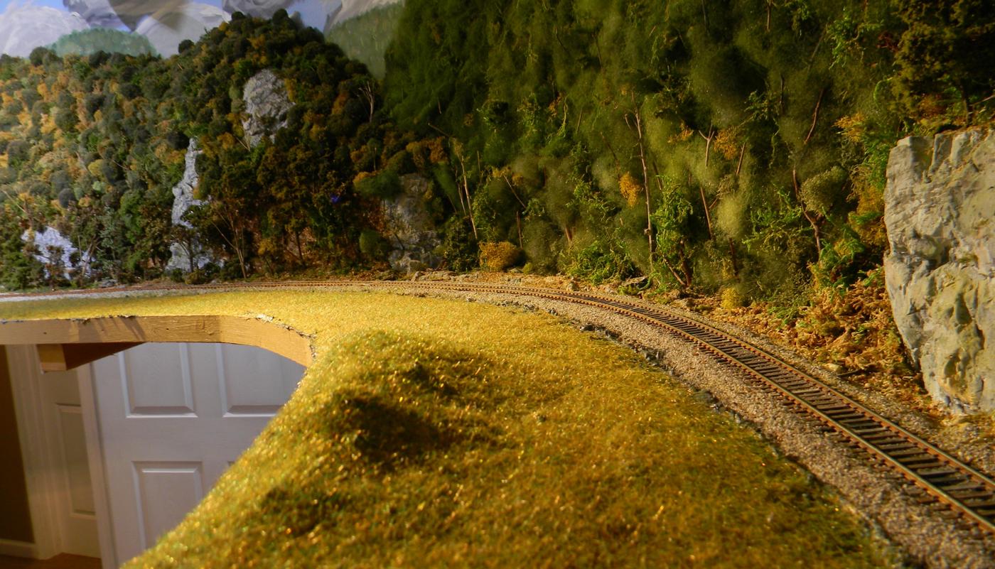

After doing some detail painting yesterday, tonight was the night to throw down the base layer of some static grass along the river and then up the grade on the viewing level to where the hills start on the foreground side of the tracks. I masked off the tracks and made sure I could contain any runny glue before getting the static grass applicator out. I'll let that set up until tomorrow night, vacuum up the strays, and then I'll add some more types and colors of grass in that area.

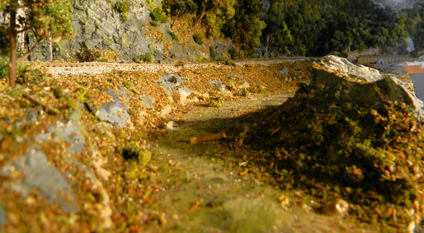

I went for a more "burnt out" look to the grass with the final layers - more like the end of summer with some greener highlights. I like the scruffy look, and the relatively quick install. I'll probably add some more shrubbery and maybe some trees, but I would like to preserve some easy access to the track in case of derailments here. I'm not modeling the prairie, so I made do some selective ripping, expose some rocks, maybe add a few groundcover patches. I also need to add a little more ballast on the edges.
