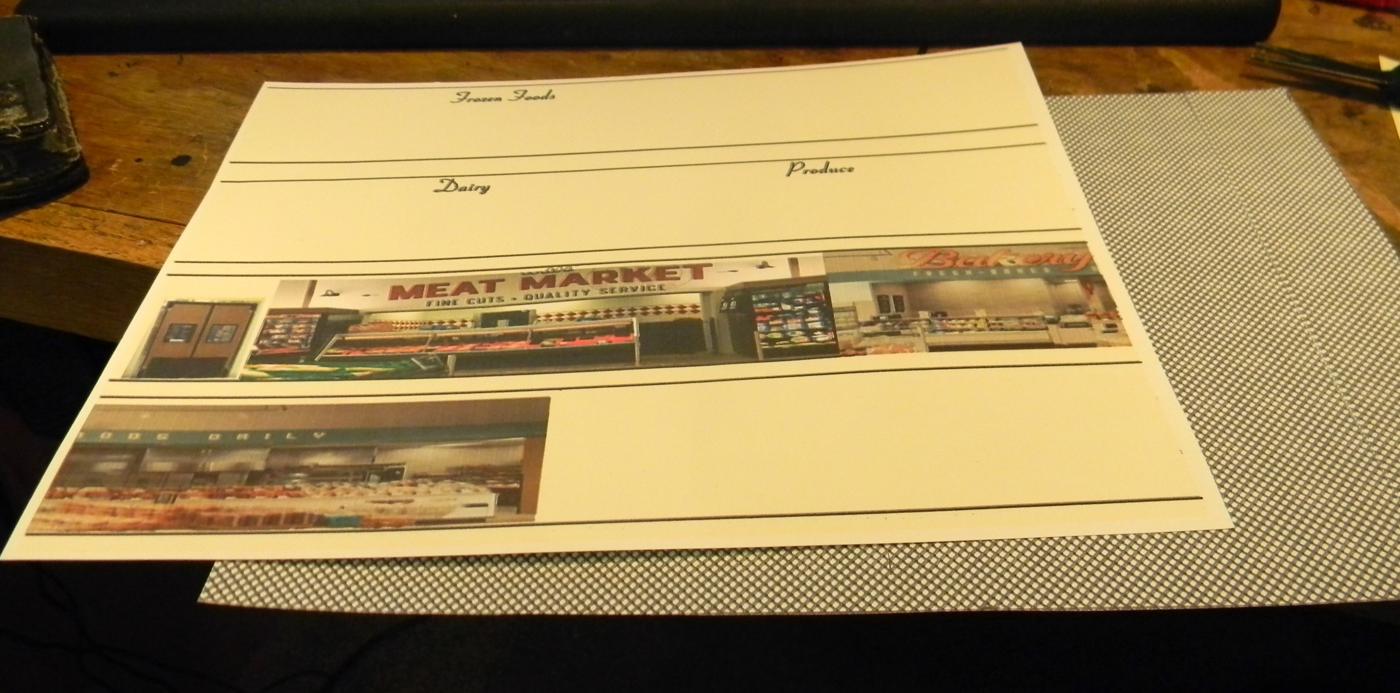

I've never scratchbuilt an interior, so I'm doing this blind.  Figured I'd get the easier stuff done - we're going for floors and interior walls first.  Went into a Paint program and printed a patterned floor.  Two sheets joined together made it all the way through the interior space.  I'm going to build all of the interior off of the floor and then when I'm ready to assemble, I should just be able to slide it in and glue it the exterior structure.
The side walls will just attached the outside walls, but the back section of the store will have a false wall that will house the meat cutting room and the bakery.  The left side wall will be frozen food cabinets, and the right will be produce bins.  I'll be heading to the grocery store with my camera in a little bit to take some pictures of loaded shelves, frozen food cabinets, produce bins, meat bins, swinging doors, meat windows, checkout stands, etc.  I've got a vague plan to turn the photos into printed cardstock that I can fold up into shelving units and bins.  I hope the people in the grocery store don't look at me like I'm a wierdo....

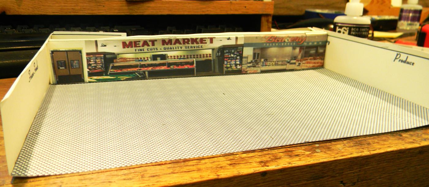

In the meantime, I figured I might be able to pull some pictures off of the internet for the flat backgrounds for the rear wall - got a bakery and a meat section shot and joined them together on the back wall using Paint, and did a little bit of draft printing to size everything appropriately.
Printed out all three walls on cardstock, cut, folded and glued.

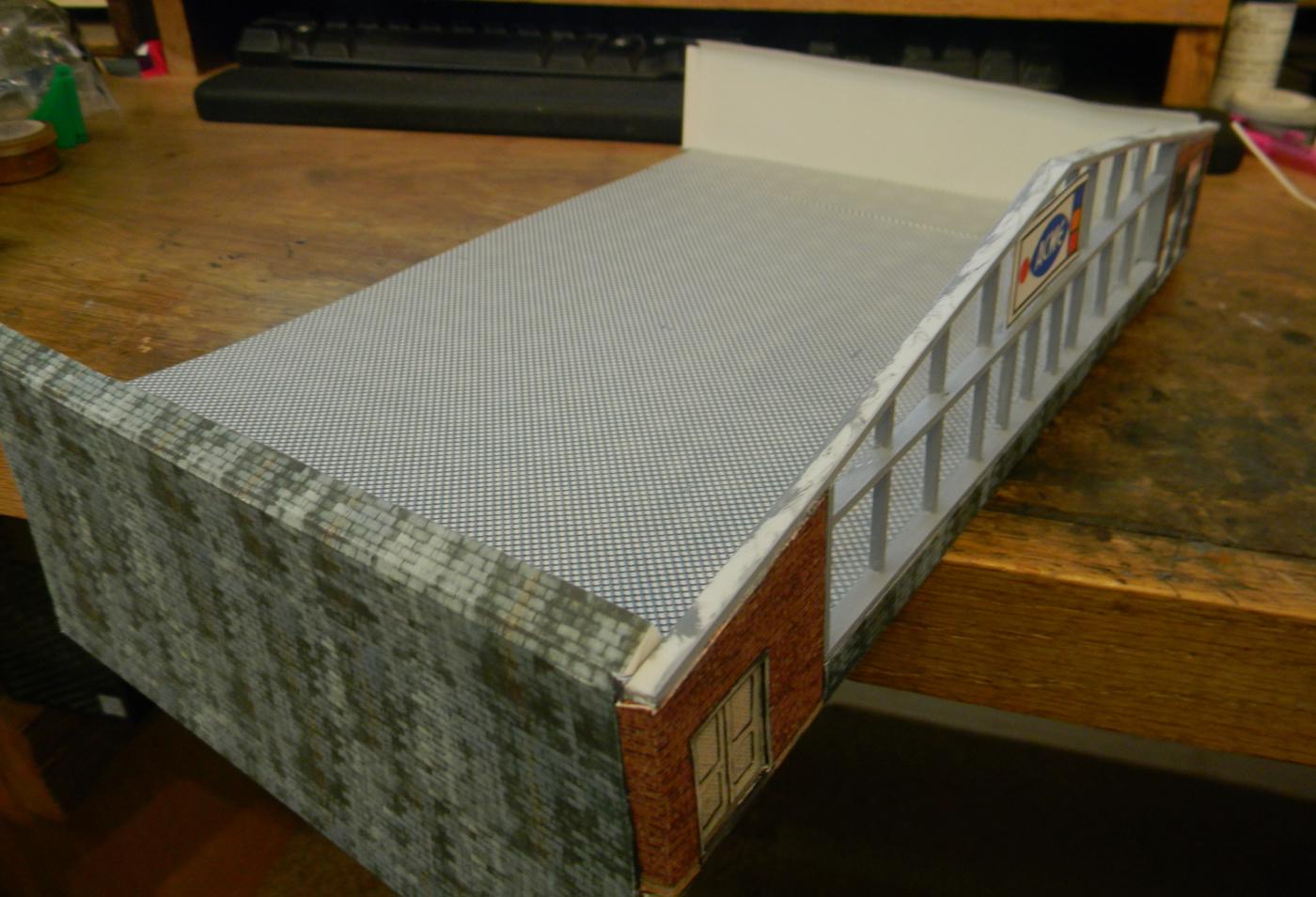

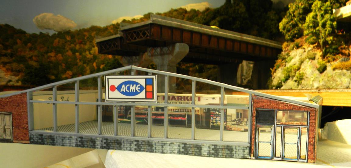

Test fit the interior to the exterior shell...
The next stuff is going to be tougher - shelves, bins, cabinets, checkstands, pillars....  Eventually this will also get a ceiling and a roof.
