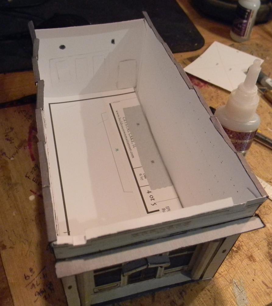

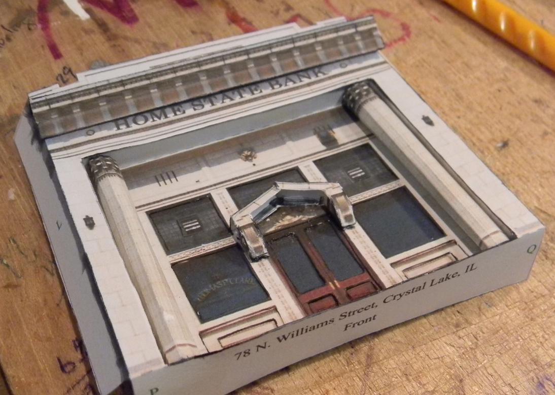

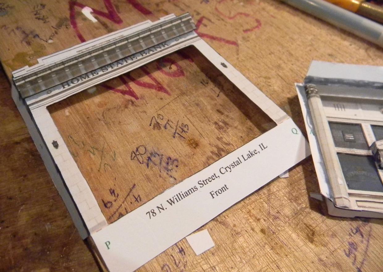

My granddaughter was taking a nap after the dog and I got back from our hike, so I took advantage to squeeze a little more work on the bank job.  Folded up the center section (doors and windows) and added the fluted columns and the awning over the door with the supports, which are nice gothic architecture features.  The awning had long supports that were meant to go through the cardstock to be secured on the backside, but I thought that was overkill and just glued to the doorframe.  You'll notice in the picture that virtually every seam gets a liberal dose of gray marker to get rid of the white edges of the cardstock.
A couple of more tips and tricks.  Once folded, some of the seams between 90-degree angles don't have any support - in this case I added corner support by cutting pieces of cardstock and gluing them to the corner to support the corner and get a nice 90-degee angle.
Also, the columns required multiple folds to get them into shape.  I straightedge and a light scoring with the back edge of my knife did the trick.
More progress.

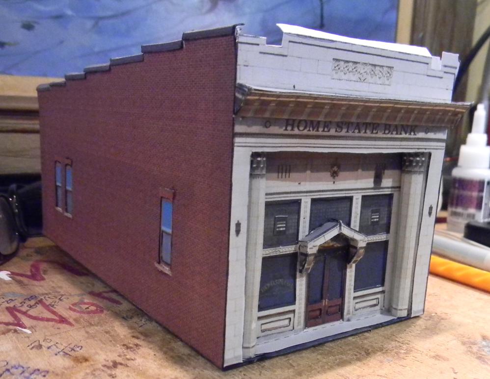

Fitted the center section of the bank into the facade and glued it together after adding the cornice.  Once that was done I joined the remaining wall sections to the front, added some reinforcement to the floor and added a middle-of-the building reinforcement, and added the roof.

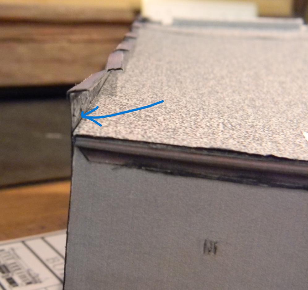

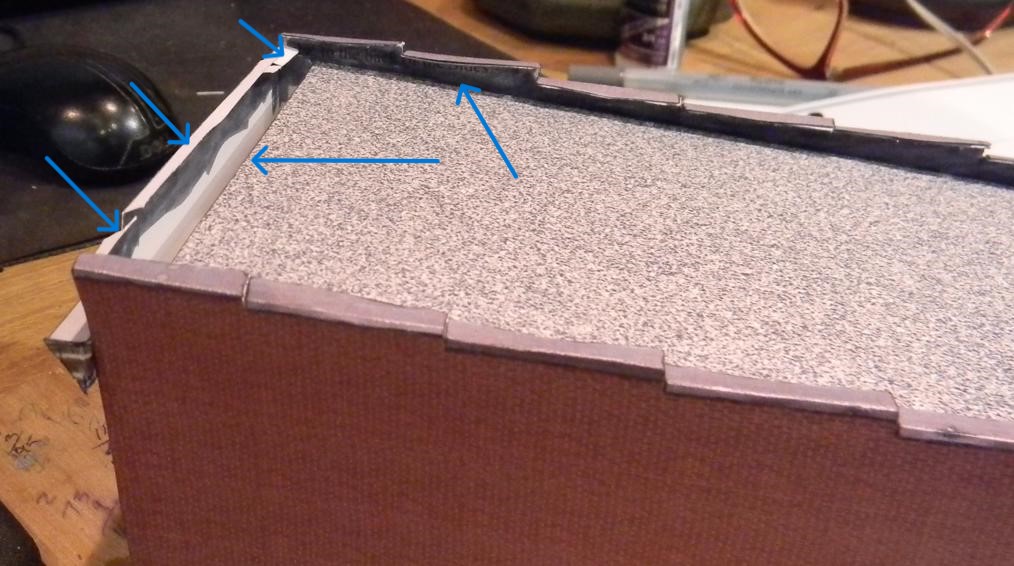

Now, the problem areas....  As you may be able to see in the pictures below, there are some non-existent roof details in the free kit that left me a bit wanting.  The blue arrows show some of the issues:
1) The roof is too short to go all the way up to the front of the facade if you pitch the roof.
2) After folding the capstone pieces back, they hang in the air unsupported.
3) There's no sidewall detail for the walls under the wall caps.
4) From the back side, the wall is only a sheet of paper thick.
All of these problems are rectifiable, but each takes a little time.
1) I printed out another page of the roof and cut an additional section to run all the way to the front facade.  That one was pretty easy.

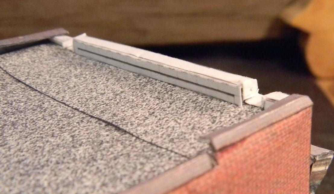

2) I cut out the top of the front facade and made an equivalent "backside" of the top of the facade and glued it under the capstones.  A little more involved.

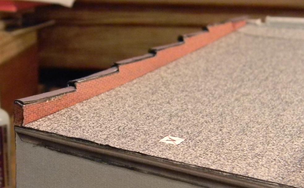

3 and 4)  I cut additional top-of-the-sidewall for each side and carefully measured/estimated the roof angle and glued the interior side of the wall to the roof.
A couple more shots follow.
I still have to do the interior portion of the wall above the roof on the right-hand side, add the chimney, and I think the bank job is about done!

We'll put a temporary wrapper on the bank - here it is beside a Walthers plastic kit (White Owl) and a Clever model (the Camera Shop).  At first glance, you probably couldn't tell that any of these weren't plastic kits, and for virtually free?  The bank answers the mail.  I didn't see anything else in particular on the Illinois Historical site that I would include in White Haven, but the price is right and I may take another look.

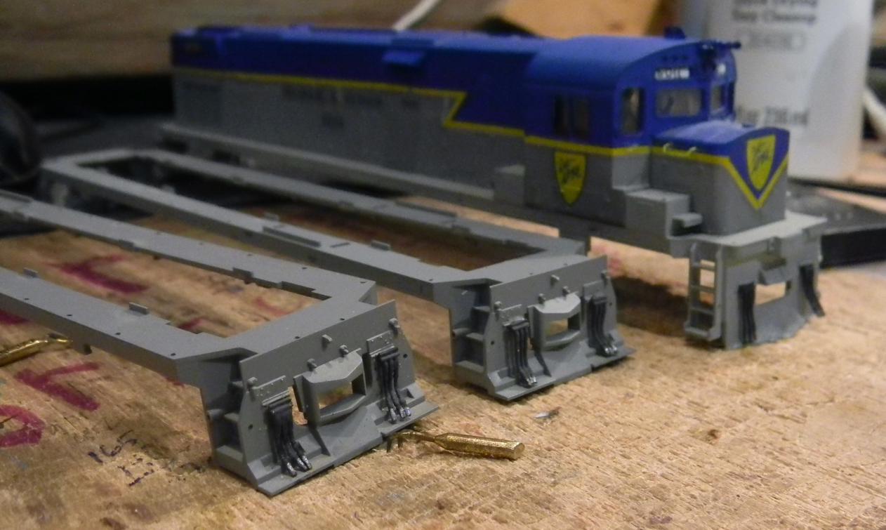

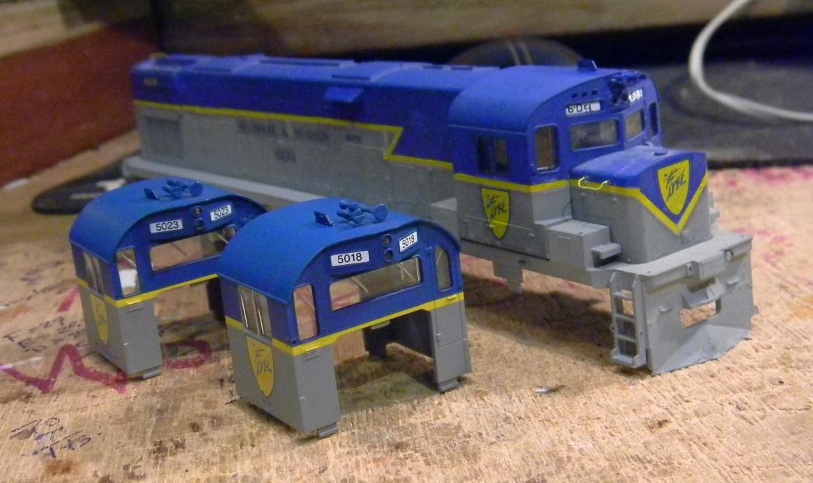

While I watched football this afternoon I decided to break out the detail parts for my Alco fleet.  The primary targets were my two D&H RS-36's and their big brother, a C628, but while I was at it, I remembered I needed a few detail parts for my M630, my C630, and my LV C628...  Fuel filler necks for all three of those on both sides, a horn bracket and a set of horns for the C630.  Some of these are replacements - it's the small parts that end up in wierd places on the layout during operations.  While I was working on all three of those, I did a bit of repair on the brake cylinders on the LV C628.  Then I remembered that I wanted to put window awnings on the cab, and then as I looked at the photo, I remembered that I also wanted to put MU hose clusters on and those awnings need to be weathered a bit...  have to wait a couple of days. I also added a horn bracket and horn to the D&H.  Here's "finished" pics of each:
Next on the detail parts install were some rain shields over the intake grills of my D&H C628.  Most of the early models in the D&H fleet had these 1116.1343123837.jpg (1200×819).  Cal Scale makes a brass set of two (part number 190-538).  They fold up on the two sides and they provide 4 brass mounting pins to secure into the shell.  I'll hit it with a couple more coats of paint before I get to the one on the other side of the loco.

I've been doing some cab work this morning while the rain is doing its thing - added the other rain cover on the intake on the other side of the C628, added Sinclair antennae on all three locos.  Next will be MU hose clusters for all three.
