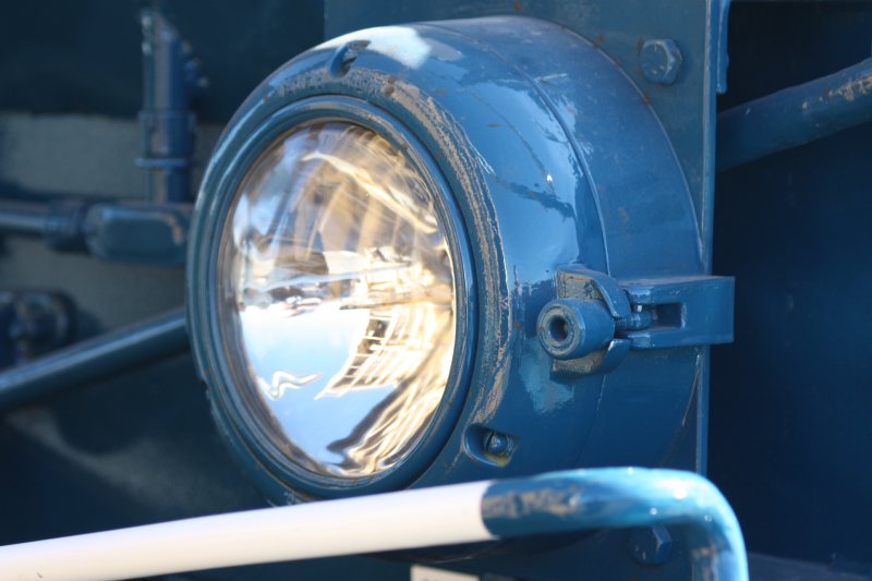

Let me reduce the size of some pilot mounted lights and post those though, as well as the MU hose placement for you.

Pilot mounted ditch lights on an EMD Road unit. Notice the conduit between the lights.

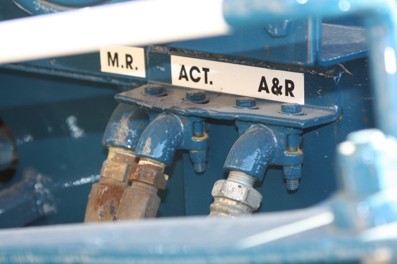

MU hose placement.
M.R. = Main Reservoir Equalizing Hose
ACT = Independent (Loco only brakes) Actuating Hose
A&R = Independent Application & Release Hose
Let me know if you need any other detail shots. I took photos of just about everything on this unit.

Hi Tom,
How can i thank you enough those are brilliant pictures always can use good references for modelling detail ...... if you have the other pictures handy it would be good to have them please i will PM with my email addy to save on forum space.
All i need now is the light lenses to arrive from Kato USA and i can make a start.
