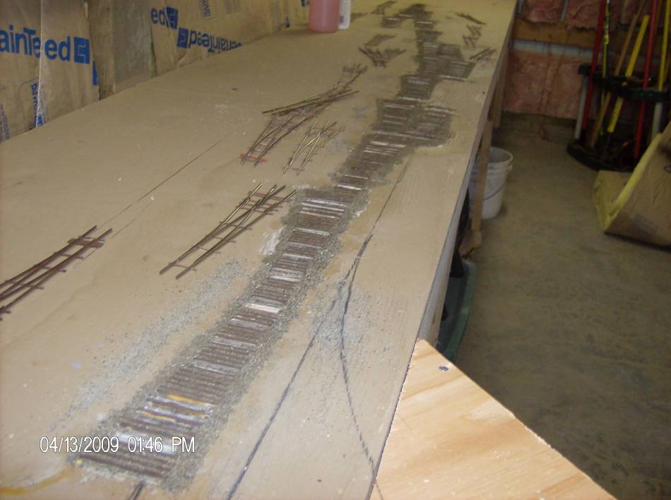

A little bit of progress to show off. Ties are stained and ballasted. Once they dry I can vacuum and start installing the turnouts and laying out the yard Big Grin
Carpentry is also done, I hope. That was getting pretty boring. 35
The one picture shows where the switching lead will be, but I don't know. I planned on a river in that area and it really messes up the scenery possibilities. I might move the switching lead back on the other board, opening up that river area more. But I also like the idea of the switching lead having a small trestle or bridge over the river, so I can't make up my mind. 35
Thanks for looking.

Excellent progress Loren, but then what was it you said.... "4 layouts in 5 years"....You should be finished and have it done in no time, ....and with your eyes closed. 2285_

Loren, I would not worry about having the switching lead cross a bridge over a small river. I think it would really add some interest to the layout to cross a small stream with your lead. Crossing a large river with a lead would pobably not be prototypical, but I don't think a creek or small river would slow down a railroad from putting in a switching lead to a yard.

Galen was over today and we decided that switching lead needs to go away. It takes to much away from that area. Now to decide if there should be a water feature, a quarry or what. :?

A quarry, lake, or pond could take up quite a bit of real estate. On the other hand a small stream can add a lot of interest while only taking up a ribbon a couple of inches wide across a layout and give you an excuse to put in some bridges or trestles.
