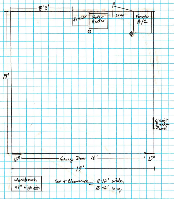

Here is a better sketch showing the dimensions. I forgot to mark the scale on the drawing itself... 35 but it's one square = 1'.
The little round things in front of the water heater and furnace are metal poles bolted to the floor to prevent bashing your car into the important appliances. It's a tight fit for the car, and especially for getting two kiddos strapped into their seats plus groceries out of the trunk, etc.
That workbench sketched at the bottom of the drawing is really the only large item that might interfere with layout planning vertically. The actual height is close to 5' high, but the back board can be shortened to just under 48". The work surface is 36" high and there are drawers that pull out beneath it, also a consideration.
I had contemplated making use of both sides of the room with a removable bridge across the garage door to connect them, but that darned breaker panel is there and I just can't see covering it up. It's too tall to be built over or under and I insist on providing access.
Hope this helps.
Galen

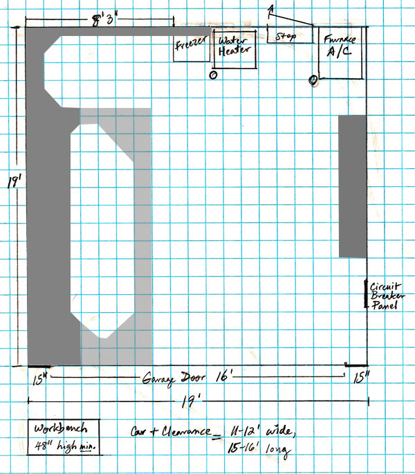

Here is the same sketch with an area shaded for the layout....not a solid area, just the workable area for benchwork. Remember I will be able to access the edge of the layout (whatever shape it may take within that shaded area) from the center of the room, even with a car in there, as an aisle all the way down.
NOW GET CRACKIN!!!, er, I mean, thanks for any suggested plans you may offer. Wink
Galen

Why is your workbench in the driveway? 35

Quote:Why is your workbench in the driveway?
Icon_lol Icon_lol Icon_lol
I just KNEW somebody around here would catch that. The neighbors are asking the same thing. Nope
A good reason, actually. I can cut it out in photoshop (along with any other garage items that take up floor space) and position it wherever. I've used this to rearrange rooms before. Moving little bits of paper around a drawing is a whole lot easier on the back than shifting the actual furniture!
OH, and the freezer can be moved, it just makes good sense to keep it parked close to the door to the house and right in front of an outlet.
Galen

If the space were mine, I wouldn't waste it by reserving it for a car. Wink I'd close-off (or replace with a wall) the main door, replacing it with a man door on the southeast front corner, then construct a hallway from there to the door to the house. Make the hallway as wide as required for tool and toy storage, workbench, freezer, etc. Provide a separate door off the hallway for access to the trainroom. Goldth
If, however, you have to cater to the car, you might as well lose that 2'x2' "bump" beside the freezer: even as a short leg of an upside down "L", access to it will be limited if the car is inside. I'd then build a wall around the perimeter of the remaining shaded area, placing the access door at least 6' from the north wall. Because of the overhead garage door, you'll need to drop the ceiling to accommodate the doortrack on the west side, although, beyond the inner end of that, you could revert to a full-height ceiling. The 6' width of the room thus created will allow a complete loop on either end of the room, with the connecting tracks squished closer together to allow aisle space. I'd still go with a two-level layout, (each level independent of the other) then design one (probably the upper one) for continuous running, the lower one as your branchline. If the upper deck is near eye-level, the lower one can be situated so that it's comfortable to operate from a rolling office chair.
Even if the additional cost of that wall delays layout construction by a year, I think that, in the end, you'll benefit greatly from having a dedicated space for the trains. Under-layout space can still be used for storage of regular household items, too. :mrgreen:

Galen, If you want to put a shelf on the other side of the room with a connection across the garage door, just put a swing away or lift out bridge across the electrical panel. If the panel is high enough on the wall, a single track going across underneath the panel access would be very easy to just reach across to flip or change breakers. If it isn't removable, make the bridge low enough to clear the entire panel in case a breaker fails and has to be replaced. If you were to put in a wall, as Wayne suggested, you would lose some of your layout area due to the need for an aisle between the wall and the garage. An alternative might be to do as George Selios did with the Franklin & South Manchester and and put a ceiling over the the layout and suspend a curtain from the ceiling that would fasten to the bench work to seal out dust. The curtain could be pushed back or removed for operation and then installed to protect the layout when your operating session was over.

Here's a suggested use of the space. On the left is the mainline layout with broad-ish curves (26" rad?). The shaded area on the N wall is staging, which, if high enough, clears the freezer lid. With good turnout spacing a staging track of 8-9 feet would be possible. That would hold my 4-8-4 and 70' passenger cars nicely.
On the right the shaded block is the (expanded) timesaver. The layout as it is now is 14" by 5'. Those dimensions would not change, but this arrangement leaves 6' more available as a fiddle track/staging area (sector plate?) or an additional scene.
This is doable for the car, and more than adequate for all the kids bikes, etc. But squeezing them both in at the same time leaves little room for operating the layout unless the under-benchwork space is well utilized.
