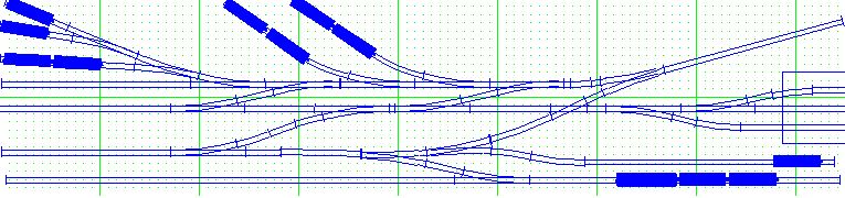

After reading a bit about the terminal railroads in New York, I started doodling this around the Walthers carfloat apron... Call it the Spaghetti terminal and dock, if you like. I see terminal buildings at the back, a pier at the front with a gantry crane or two, maybe a bulk transfer in the top right, and whatnot in the top left...
.... so how do you figure you have 8' 6", plus 2' on the left and 2' on the right? Isn't that more like 12' 6"?

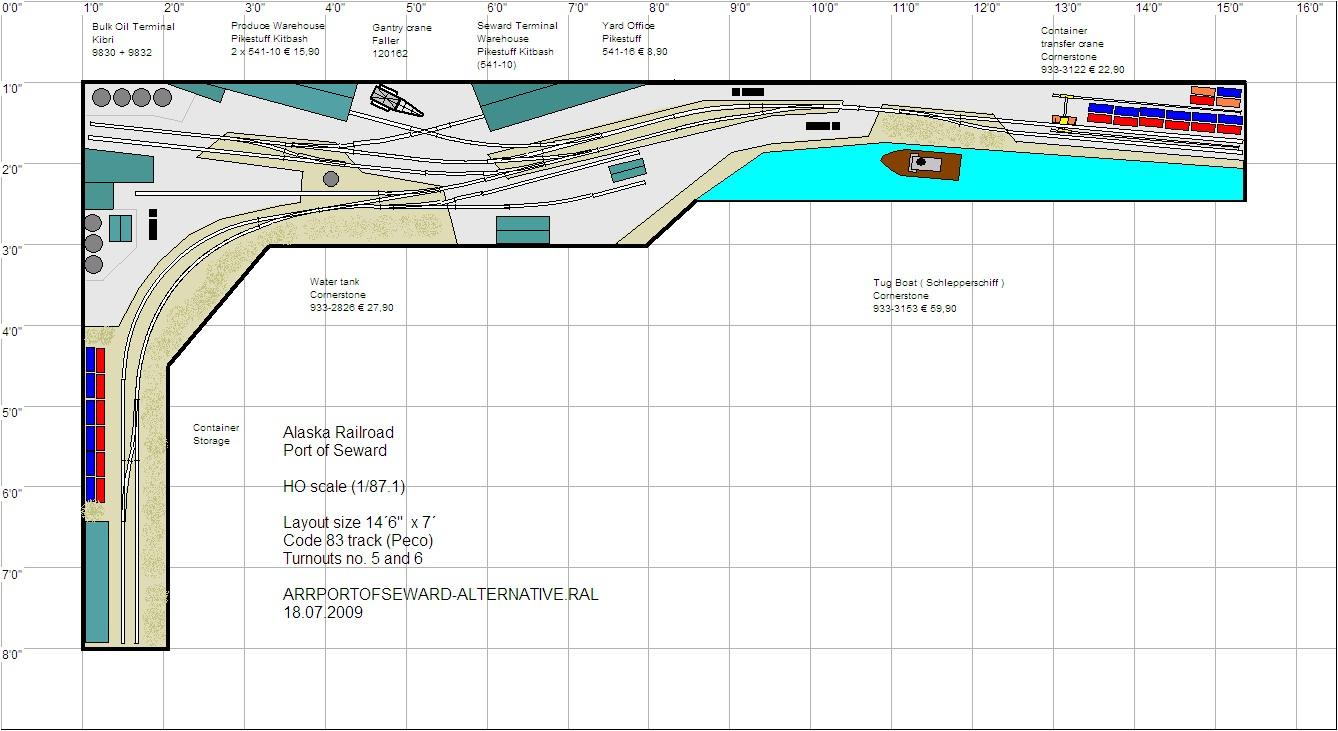

After a long and thoughtful process, I have finally come up with a layout that is clos to my "dream layout" and combines a lot of my givens and druthers. I was able to squeeze out a little more room for it.
The layout has been inspired by Bob Smaus´ Port of Los Angeles layout , as well as many other ideas I saw in this forum. I quite like it! Thumbsup
Here it is:
This layout of mine just fits your space!
Check it out at
http://www.freewebs.com/buckler/kupplayard.htm
I don't know how I missed this thread! That layout looks perfect for the space you have available! If you wanted to make a removable "fiddle yard" to bring different rolling stock on and off the layout, that harbor on the upper right corner could consist of a tugboat and barge loaded with freight cars on wheeled cart that could be rolled into position to offload freight and load other cars for transport elsewhere. If the car was built 12 - 15 inches lower than the layout with an automobile scissor jack bolted to the top of the cart and the bottom of water scene with tugboat and barge, the scene could be rolled away from the layout and lowered so that it could be stored under the layout when not in use. In fact, if you don't need all of the space under the layout for storage, books, etc, you could put a staging yard on a shelf under the layout to store your extra rolling stock, and service it with the cart. I fact, you could eliminate the cart by mounting the tug and barge on a dumb waiter at the end of the layout transversing between the layout above and the storage/staging yard below.

Nice looking plan.

Thanks for all the positive feedback on my trackplan. Without all the ideas and inspiration I gathered I would not have been able to come up with anything like it. I still have to check it in operational terms - not an easy task for me, as US prototype train operation differes considerably from what I can observe here in Germany.
Operationally, I think there will need to be some compromise from prototype practices. Alaska is about as remote as it gets in the U.S. They would have a yard at the landing where cars to be sent back to the "lower 48" would be stored awaiting the barge. When the barge showed up, the fresh loads would be off loaded, and exchanged for the return cars. I don't know enough about the prototype to know what commodities would be shipped back South. There would probably be refrigerator cars loaded with brined or frozen fish, but I'm not sure what else. I went to Alaska on a couple of Alaskan Fisheries Patrols in the Coast Guard back in the mid 1960's. At that time the Japanese were just building drying buildings in order to utilize Alaskan timber. Prior to that time, the dampness of the Alaskan climate had precluded anyone from using Alaskan lumber because no one could figure out how to dry it before rot set in. If the drying buildings worked, there might be lumber products shipped South. The thing to remember is that going North, most of the equipment would be loads. Probably most of the cars returning South would be empties. When loading the barge, loads would be put in the center with empties on either side in order to keep the barge balanced. One advantage of modeling the Port of Seward is that even though it is on the edge of the mainland and functions as the Port for all freight going to Anchorage, it functions like an island. To my knowledge there is no railroad connection to Anchorage except through the port at Seward. Therefore industries that would be too small to receive rail service in the "lower 48" would not be a stretch to receive one or two carloads per week or even per month. In Alaska, virtually everything is imported from the "lower 48."
