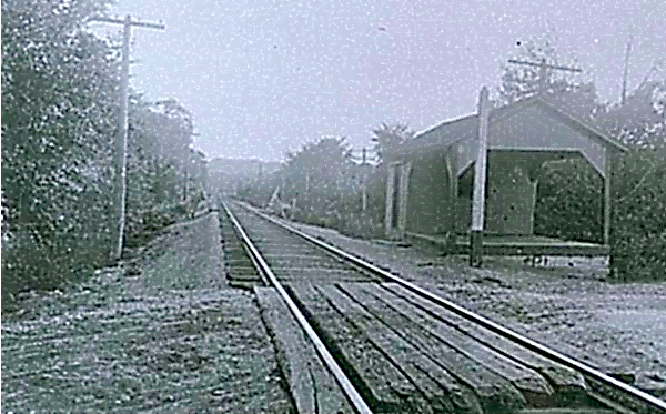

As with Ore Hill, I'm going to have to use my modelers licence and guess the dimensions. But I thought, that since at the time I only hadthe first picture to go on, I was going to have to guess what was trackside. Since there's a shelter, I was assuming, as with all flag stops at the time on the CNE, that the trackside of the shelter was open. Then, while searching the net, I found this picture.
This picture was going to make modeling this depot easy. Also, on the same site, was the same picture as the first one with the date '82. Obvisously, 1882.

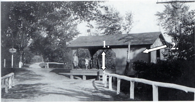

There are two ways I could do this. Either use the height of the man in the picture(1.), or the width of the boards(2.).
I decided to use the man. Knowing that more than a century ago, humans average height was smaller than it is today, and since the detail in the picture isn't the greatest, and I might miss a couple of boards counting. Getting some info off the net, the average height of a man in the late 1880's, which I determind, by the date scrawled on the original picture, was five foot, eight inches. So with the hat, I guestimated the height at an even six feet. And this would probably be considered "tall" back then.

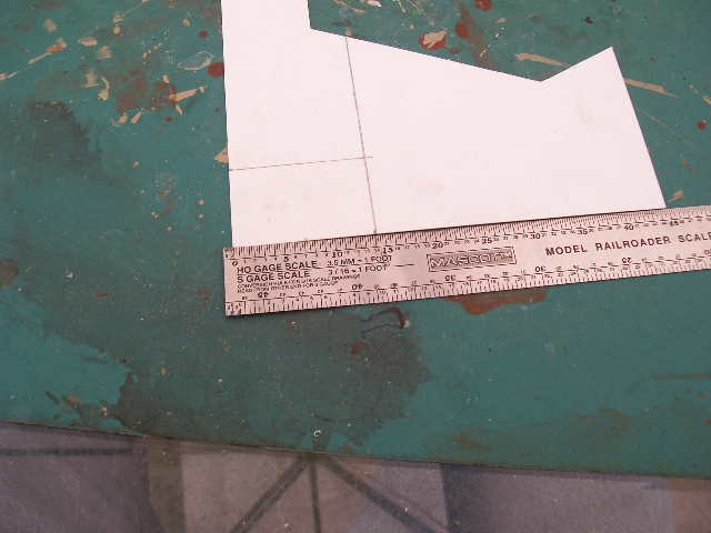

Measuring From A Picture:
After determining the height of the man, and the scale I was going to use, I placed a regular ruler against the man, and marked the height on the ruler. This was my scale in figuring the dimensions which would be 5/8th inches equals six feet.
I then took measurements using the actual inches. Its always good to have your reference material close by when scratch building from photos. In this case the book Country Depots In The Connecticut Hills ( Robert F.Lord c.1996)

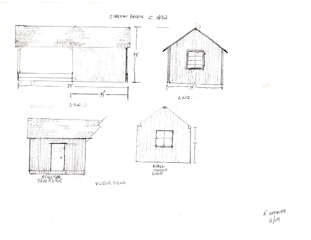

After I got all the measurements in inches, using simple shop math, I figured out the dimensions of the station, and drew a crude diagram with the guesstimated dimensions. After this, I will draw a more detailed drawing using my General Model Railroad Scale Ruler.
NARA Member #87
After I figured out, or guesstimated all the dimensions, I drew a more detailed drawing of what I envision the depot to look like. This is more a reference, than an actual plan. Please excuse the drawing, I'm not a draftsman.

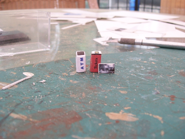

Since I'm modeling a modern version of Stratton Brook, and the waiting area is going to modernized and enclosed in glass, a few modern conveniences were in order. So using pieces of scrap styrene, I fashioned a "self serve" ticket machine, an ATM machine which I printed out a wrap on my printer and placed on both.
I also shrunk down a copy of the first picture of Stratton Brook to make a "historical" picture for hanging on the inside wall.
NARA Member #87
Great start! and that shrunken photo is a very clever detail Thumbsup

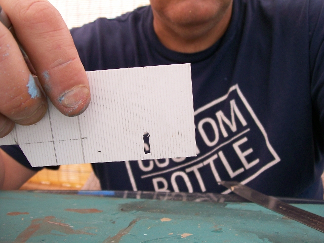

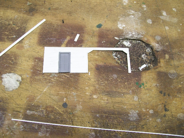

After getting rough measurements, and drawing a rough diagram, I started in on the walls. I'm using Evergreen .040" clapboard siding for the outside walls, and plain .040" for the inside. The first thing I do is measure the dimensions, and draw out the basic shape of the wall on the backside of the plastic.

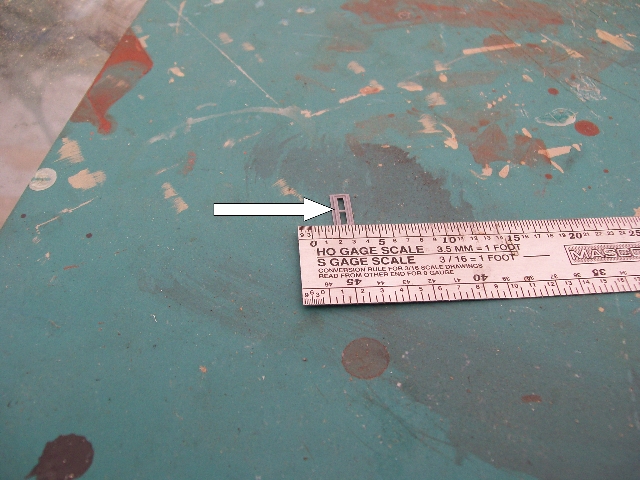

Before I cut out the wall, I will measure and cut out the opening for the window. This will give support when cutting out the window,and prevent damage(It does happen) such as breaking the wall. I'm using Grandt line windows that came from their Sample Box bought a couple of years ago. The long, two pane windows were great for those ones you see in public restrooms. The windows come with a flange on the back and window trim. I measure the flange which gives me a rough dimension for the opening. Some folks will cut the wall up like a jigsaw puzzle to remove the opening, then put the wall back together. I tried that once and didn't like the results.
Here, I'm free handing the cutting of the hole.
The rough opening.

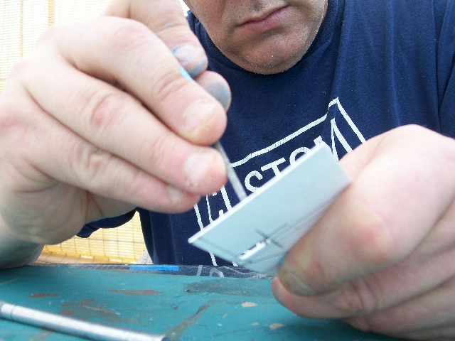

After getting the rough opening, I will use jewelers files to open it up to the right dimensions, checking the fit every once in awhile. This does take time.

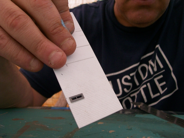

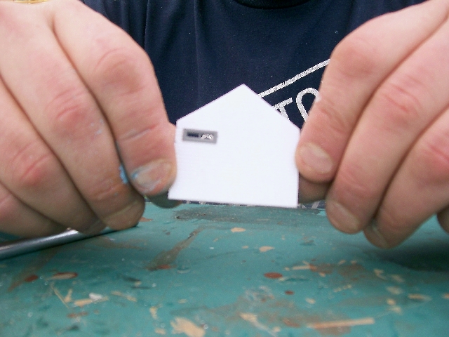

Perfect fit.
Then I finish cutting the wall out.
Tip: When cutting plastic, make sure you have sharp blades handy. Plastic will quickly dull the X-Acto blade.

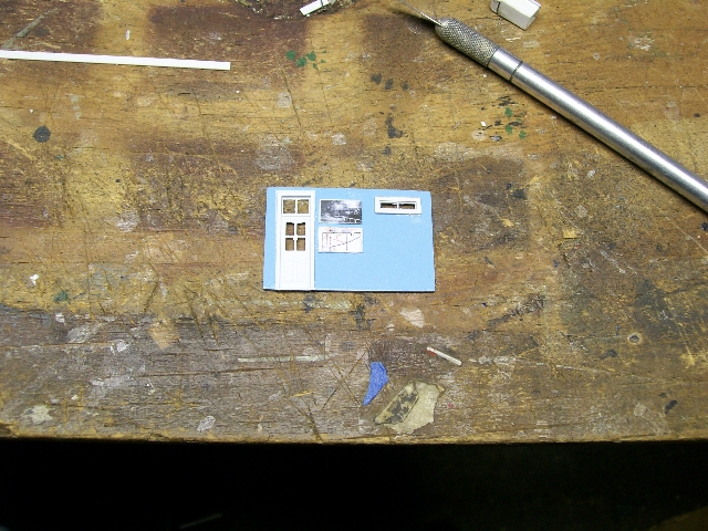

Worked on the inner wall. Using the same methods, I cut a door, and a window for the restrooms. Painted the wall blue with white trim.I also did a line "Route " map of CDOT's Litchfield Hills commuter line on my computer. You can just make out the route. That would be the red lines. The blue are connecting lines. You can see black dot which represent station stops. Pretty close to what the real CNE map looked like. I don't know if you are going to see it once its on the model, but you never know.

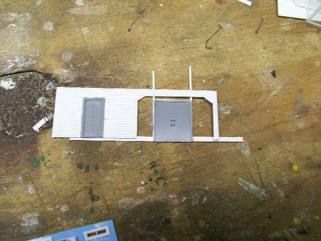

Then, using the same Evergreen .030 x .030 strip, and some .030 x .188 strip, framed the Grandt line double door. Here I'm checking the look. I cut the strip longer then required. I will cut theh strips to length after I paint the assembly. The opposite wall, and end wall are just going to get a window frames.
